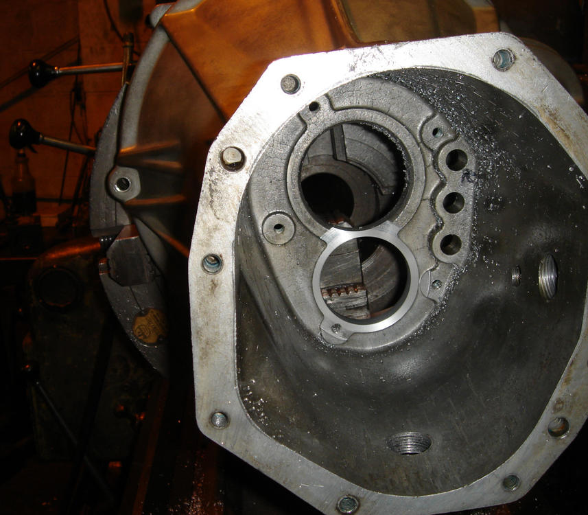

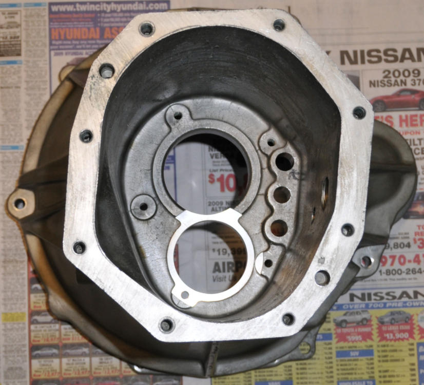

I'll have to practice to see if the bearing will press through easily with the push from the mill quill or if it hangs up. Being a bearing, the middle will rotate with the cutter head, the OD will just be a stationary guide that gets pressed through.
All has to be pretty smooth to feed the cutter down with good control and slow smooth action. Might have to sand just a tiny bit off the bearing OD to get a slightly looser fit.
Capt'n is saying "just center the dang cutter over the hole with the Co-ax like we talked about and stop getting fancy!" but I have fear I haven't tested yet. With working down inside the bell housing, both seeing the dial gauge and swapping from the center finder to the cutter head may prove to be a challenge given the constraints of quill plunge depth (5"), different mandrels lengths on the two things, and clearance/vision.
One thing I haven't said is my mill is more of a very heavy duty drill press. The one thing I can't do with it is move the entire head up or down in perfect straight line. The head, once you back off the lock down to allow it be moved up or down, can rotate on the column very easily, so there is no simple way of keeping the exact X/Y location. I have to work within the 5" quill plunge to get everything done.

I meant the balls in the races.  The play between the inner race and the outer race.
You'll be using the outer race for location but the inner race to support the cutter head.  Any play in the bearing itself will affect cutter head location.
Might be better off to cut a plug that fits the 56 mm bore then cut a hole in it.  Convert the Nissan ball bearing to a bushing.  Get rid of the balls.  Not sure but I think that somebody might have inferred that already...
Or...I just didn't comprehend what's going on.

It is foolish to assume the balls have no play, very good point. I shall measure a fresh and old one and see what deflection I find.

So this welded cutter you talked about... You're not using a boring bar in a boring head? In your close-up pic, that's what it looks like. But surely you're not thinking of welding the bar INTO the boring head, are you? I was being sarcastic above, but now that you brought it up again, I'm wondering if you're serious, or I'm simply confused as to what your cutter consists of.
So you got a mill-drill. We're not judging. I was going to ask before, but thought you had set-up worked out... Can you mount the bell housing trans side up so the hole you want to bore is closer to the head? Or is the bell then too large to get enough clamps on it to lock it to the table? If you can mount it that way, you'd have no problems with Z travel length.
11 hours ago, zKars said:
Thinking back to Philip's early idea of a dual concentric hole cutter, the inner one guiding the outer cutter by riding in the existing hole,
They call that "piloted" as in you're using a "piloted cutter". Not uncommon, and a good way to achieve higher accuracy, especially in flexible set-ups.

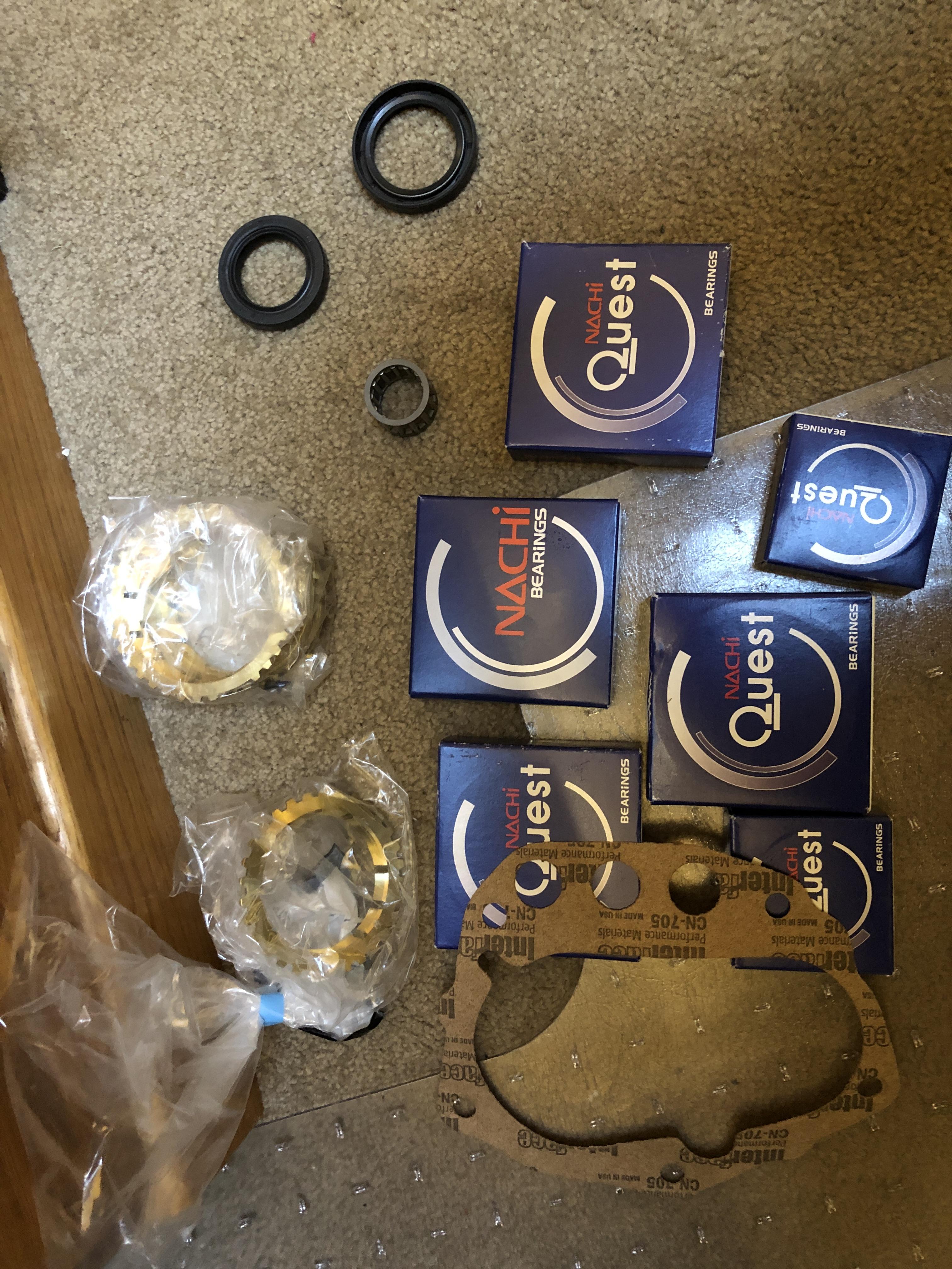

Received the BK104WS trans rebuild kit from transmissionpartsdistributors.com today, finally.
Got to say first their customer service is poor. Actually totally lacking. tracking showed they made the label on Dec 8th 2 days after I put the order in, then nothing changed on tracking until the 21, when it actually shipped, and got here on the 24th! (just now). USPS/Canada Post rocks to do this in three days at this time of year. I emailed once and phoned once during the Dec 8-21 gap and never received an email or phone call back. Chances are they were waiting for parts to come in from somewhere. Would have been nice to let me know that.
But the thing showed up.
And the contents are EXACTLY the same, part for part, as what I received from drivetrain.com.
Only difference is the price. $135 from drivetrain, $78 from transmissionpartsdistributors. Both identical $40 shipping fee. So if you have 3 weeks to wait, then TPD is the obvious choice of vendor.

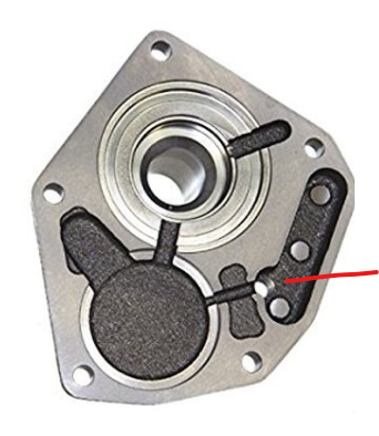

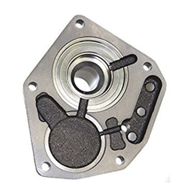

I mentioned earlier about the possible wisdom of put the 62mm front counter shaft bearing in your FS5W71B transmission.
I must mention that it will then require two additional items other than the bearing.
The front cover plate for the C trans must be used as the recess in the back is sized for the larger bearing.

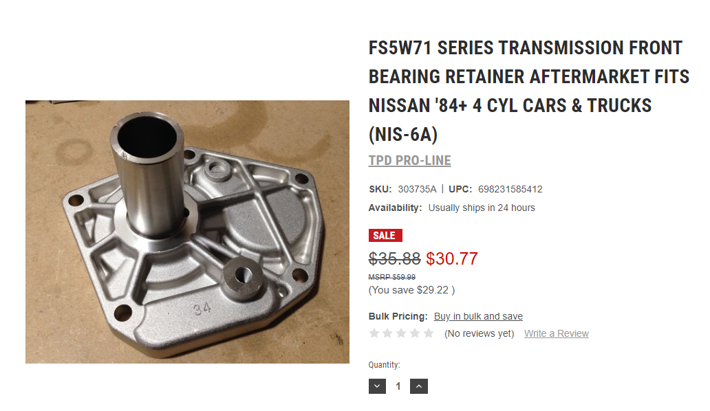

image.png It ain't cheap either. $99 from
https://www.transmissionpartsdistributors.com/fs5w71-series-transmission-front-bearing-retainer-original-equipment-fits-nissan-84-4-cyl-cars-trucks/
Aha! they have an aftermarket one as well, cheap.
Sure, an ambitious (cheap?) guy could hog out the cover to fit the larger bearing too...

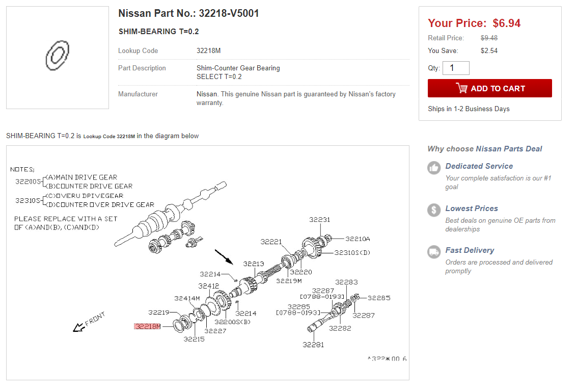

This also means you will need a bearing shim for the C trans as well. Different thicknesses are available.
There is also a tiny detail about the C bearing being 17mm thick vs the B bearing being 16mm thick. Some case material may have to be removed around the bearing just like you do with a full C type conversion, maybe somewhat less.
Edited by zKars
