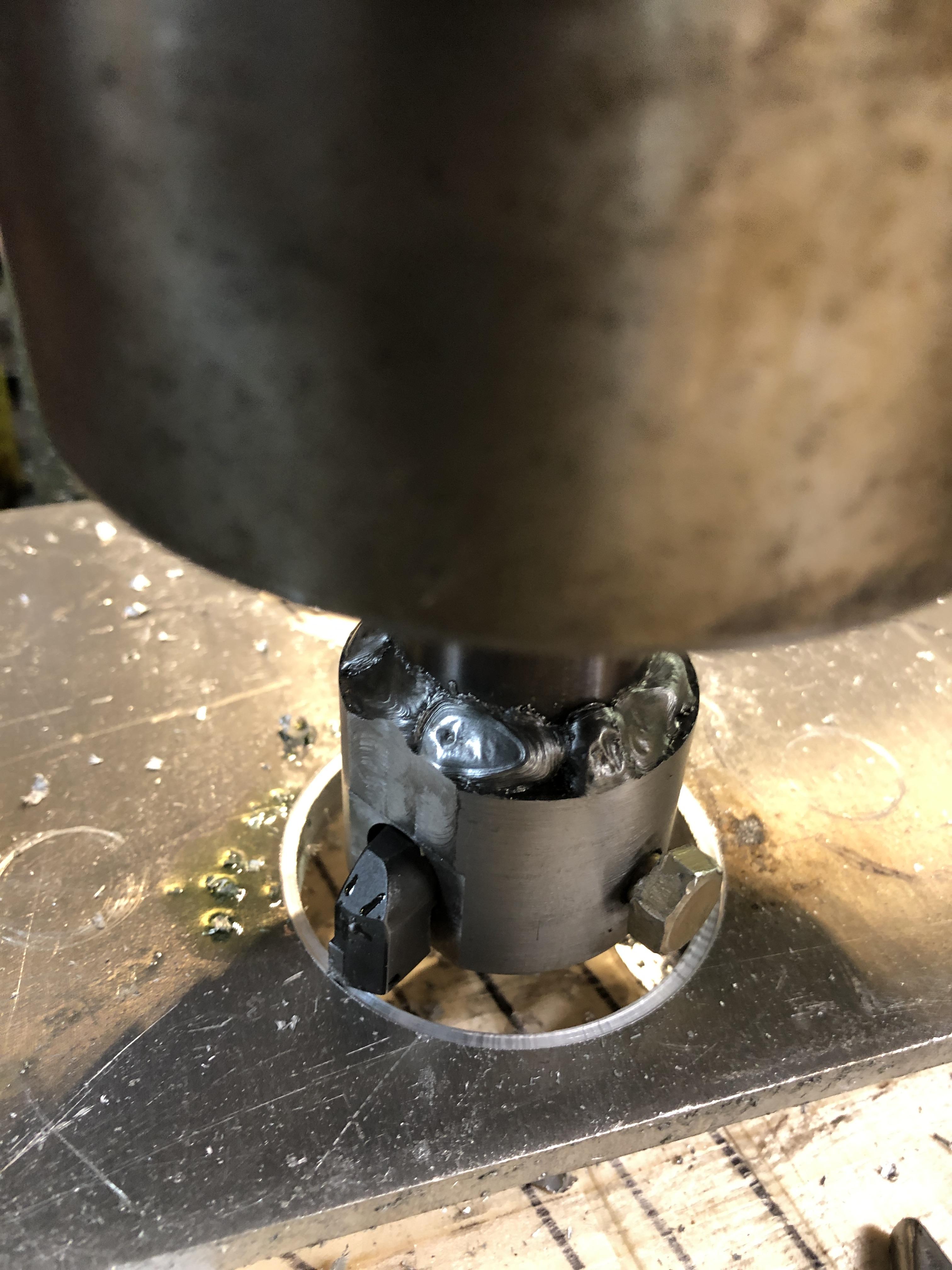

Making it’s first hole and plenty of chips in a piece of scrap. Starting with a 57mm hole.
Slowly sneaking up on the correct size by tapping the insert over, then drilling again to enlarge. Test fitting the 62mm bearing at each stage.
Edited by zKars
Success! Only took 5 tweaks of the cutter position to achieve hole size Nirvana. It has that nice rough scrapie sound as the bearing easily pushes through the hole with the drill quill. Such as easy test. Drill through, slap the 62mm bearing on the bottom, and push it through the hole to see how it fits. You know immediately if its the right size or not.

To test how close to center I was, I initially set the boring bar to just a bit larger than the initial hole I had indicated from, and drilled half way down, leaving a step. I then inspected it visually all the way around to see if the step width stayed consistent to test concentrical-y-ness. I can not tell the difference from one side or the other. Seems just fine to me.

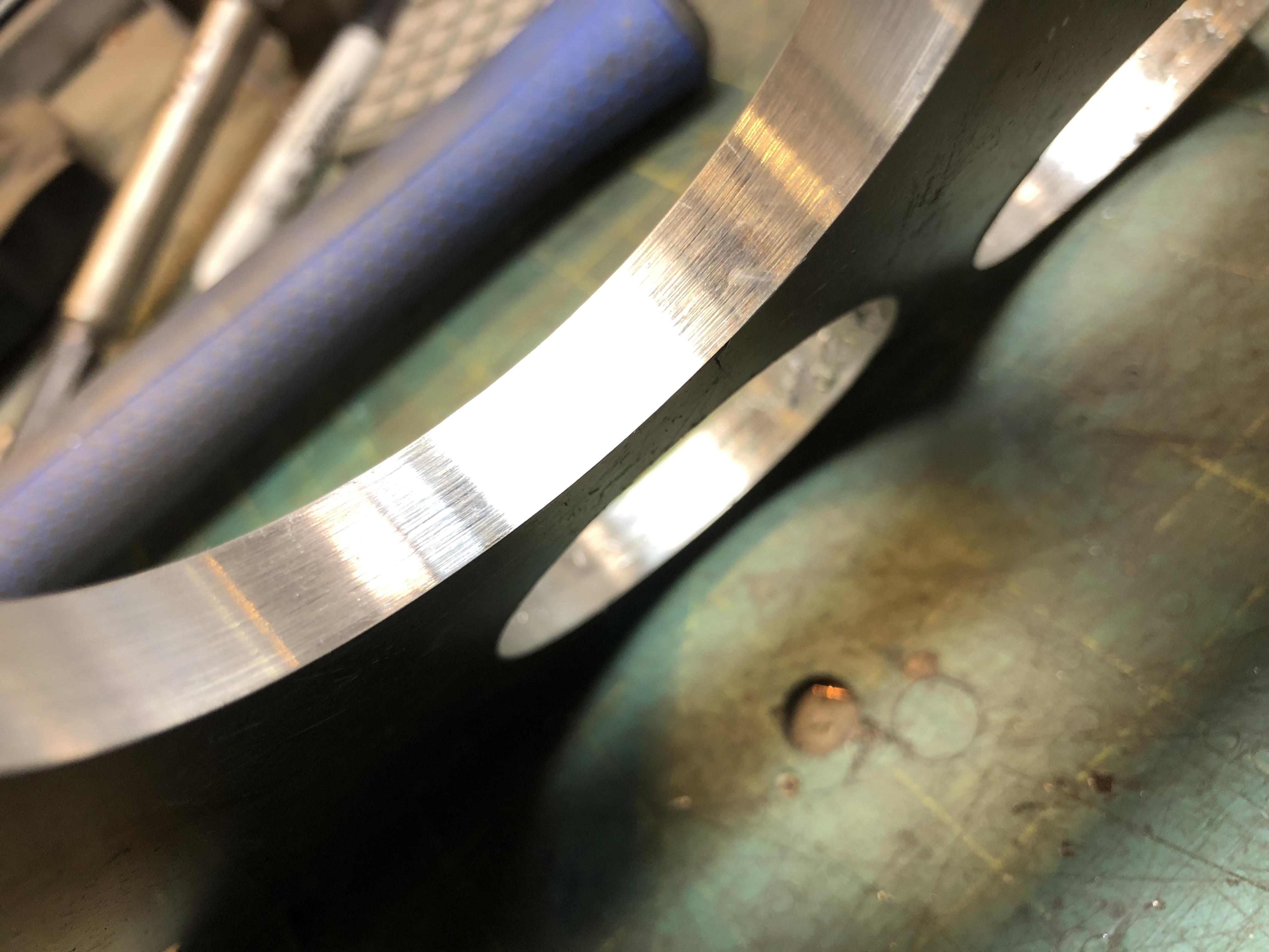

The bearing stays engaged with the old 56 mm hole until you are about 75% of the way through, then the bearing pops out the bottom, and is no longer supporting the quill location. At that moment, you can see a mark around the circumference of the bore. It’s tiny, I can’t feel it with my fingernail, but I can see it. So the bearing was not dead center to start with. Maybe its just a remnant of the motion induced when the bearing left the bore.

Measuring the 4mm space between the two bores is tricky. My caliper is too long.
So I set my micrometer to 4mm. You can’t measure that thickness with two curving walls, so it’s resting on top.
I need to make a 4mm gap gauge of some type.

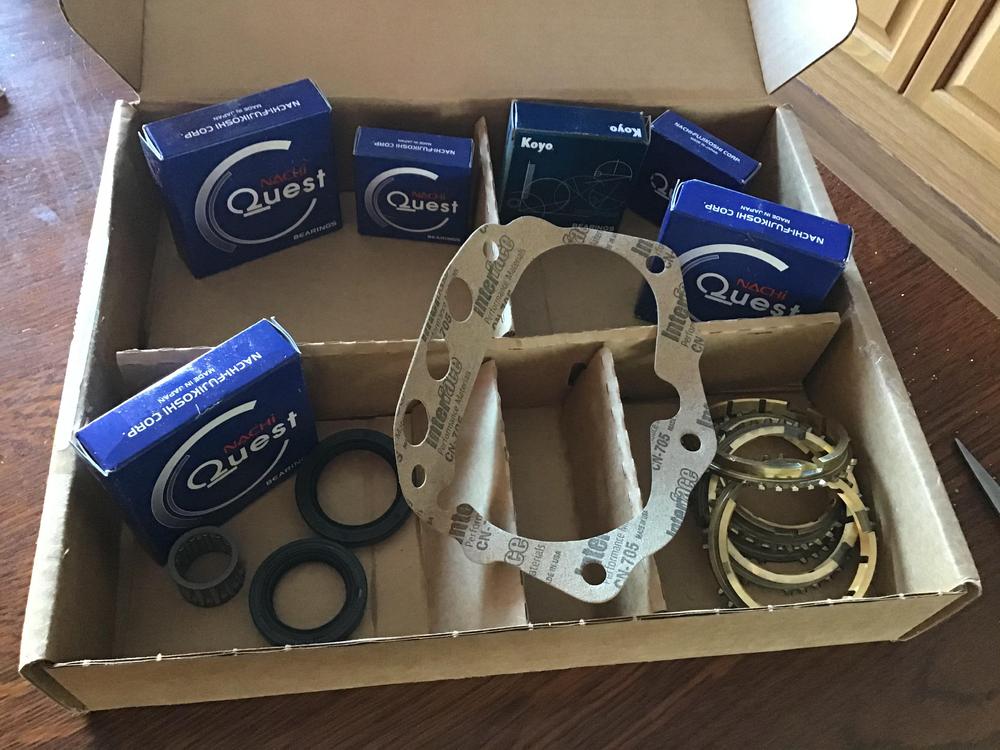

Today’s news is about rebuild kit pricing. I have actually found a cheaper source for the Bk104WS kit. Rockauto!
I found the kit when looking for 200sx parts (don’t ask, it’s what’s been keeping me ‘occupied lately) ZMBK104WS  is the part number. Was looking under 1980 200sx.

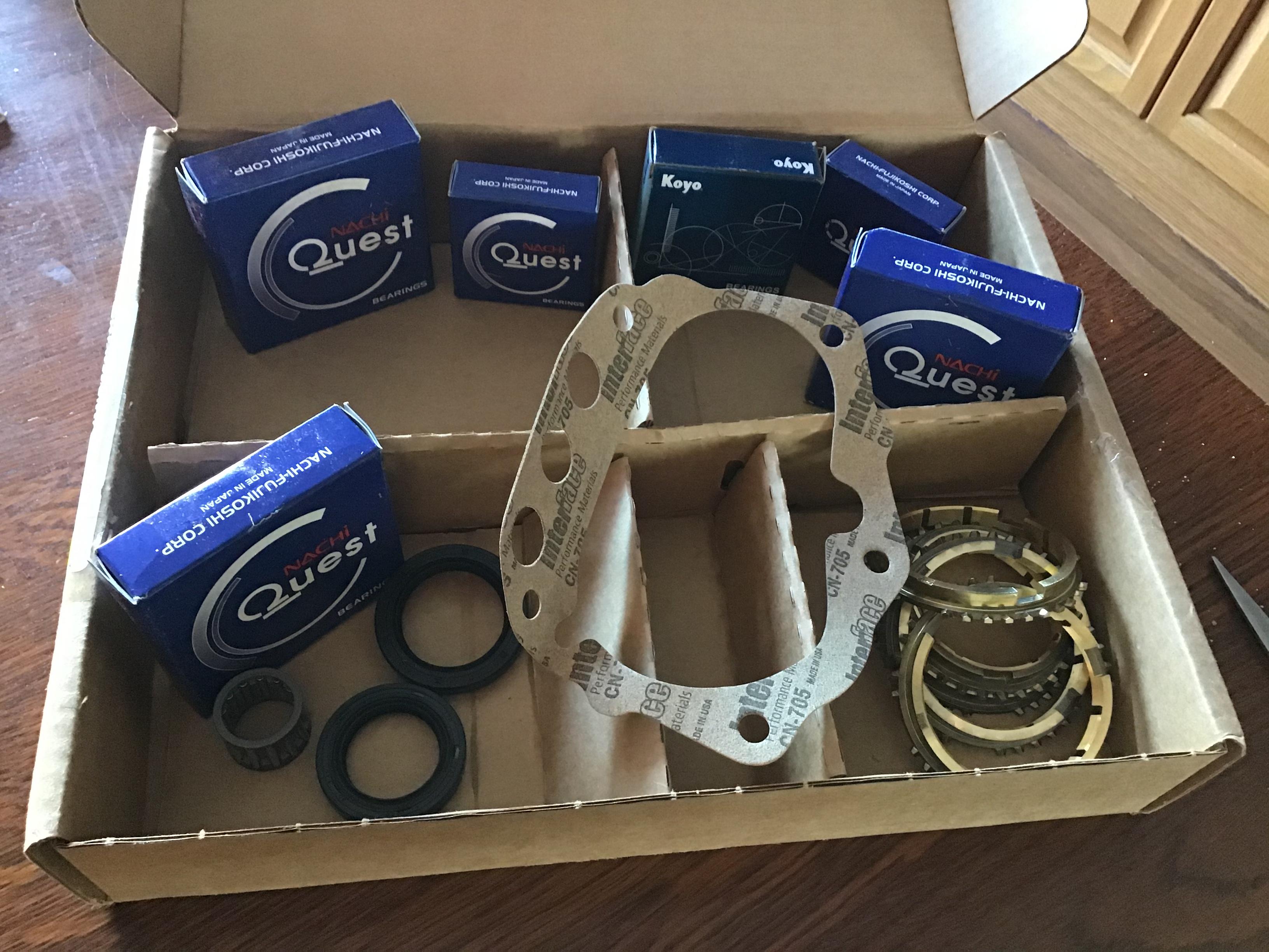

$87.37 CAD  ($66.76 USD) and about $25 CAD shipping. Expecting to be buying cheaper quality parts, I waited until they arrived. Well they are here.
Everything in the box appears to be identical to the other kits from drivetrain.com and transpartsdistributors.com. Okay, one bearing is a Koyo rather than a Nachi. Everything else appears identical. Got here faster than the other kits too. One week vs two.

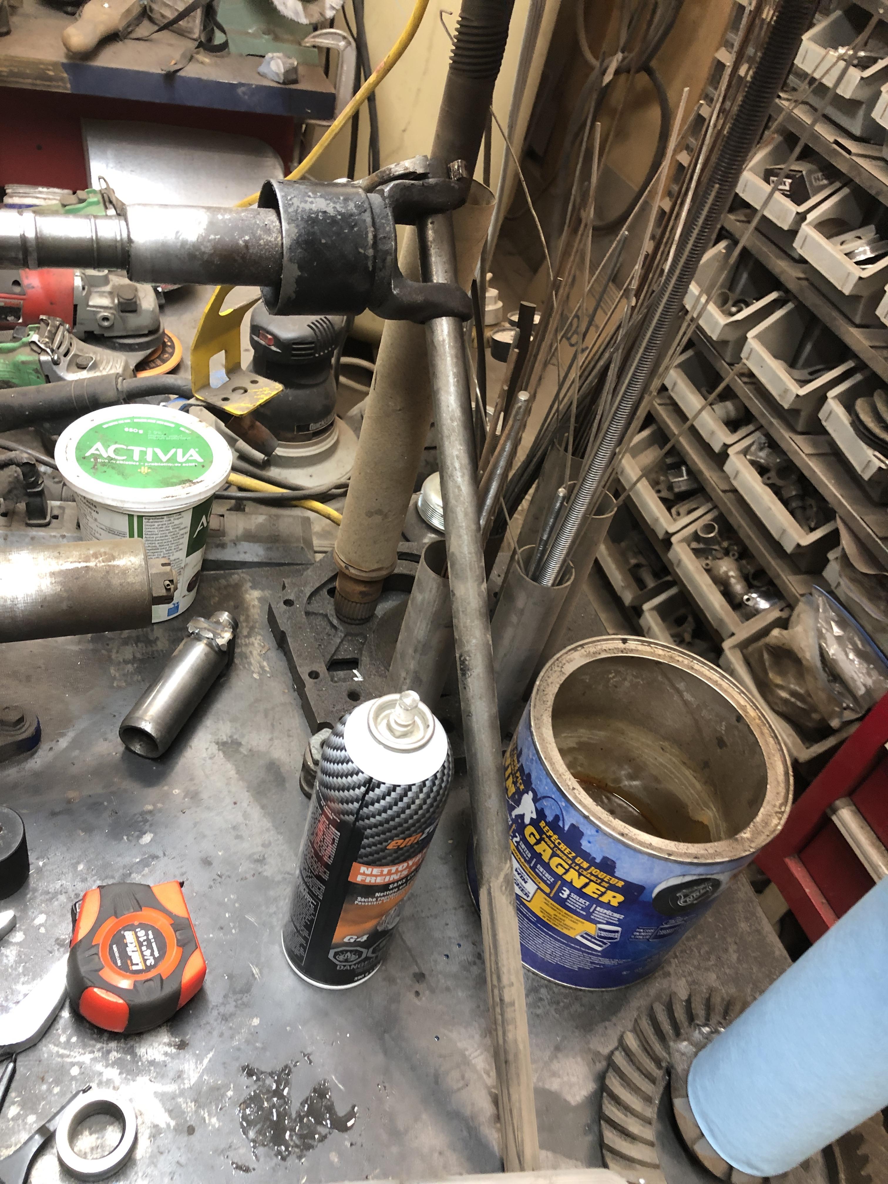

Since the two shaft gear sets are mated yet, you can't throw both 1/2 and 3/4 into gear to lock the shaft, so you have to use an old drive shaft yoke and some pipe or whatever to lock the main shaft.
There are plenty of "Special tools" in my arsenal now, and having old driveshafts to harvest bits from is critical. As is various lengths of pipe in handy diameters. I'll make a post later that shows all my "SFT's" as I call them (special field tools) and what I used them for.
