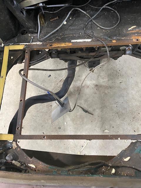

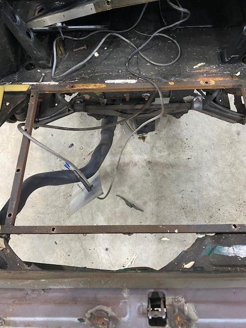

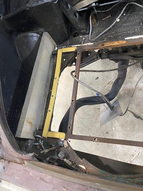

i have been rooting around the forum but unable to find an answer to my specific question.  I currently have a 71 240 that had the trunk deck cut out and replaced with a fuel cell.  i am putting it back to original.  My question is, does anybody know what years and models are the same?

see pics of what im working with.

I think the 280Z went with a space-saver spare so that's not going to be a match..  I think any 240Z and likely a 260Z will have the correct rear section for you.  Check your area salvage yards for a car you can cut out.  Also - not to drive you away from this group but you also have the Connecticut Z Car Club to draw on for possible assistance in locating what you need: http://www.ctzcc.com/

The late 260 and earlier 280 had the same spare tire well but I am certain the position of the tire well is different than yours due to the change in design of the fuel tank. Not sure if you are wanting to get that picky about it.
