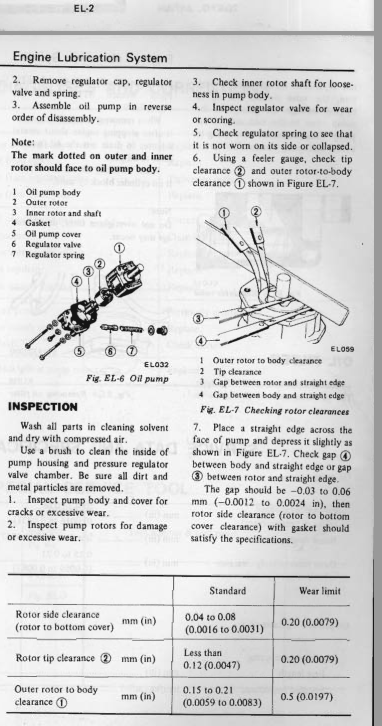

         I will use a combination of all the coaching you guys have given me to prime the system but I'm gonna  install a new oil pump just the same. As I have no certainty about the state of this engine, any parts that I know are "new" will give me a little peace.
There's a procedure in the FSM for determining oil pump wear.
