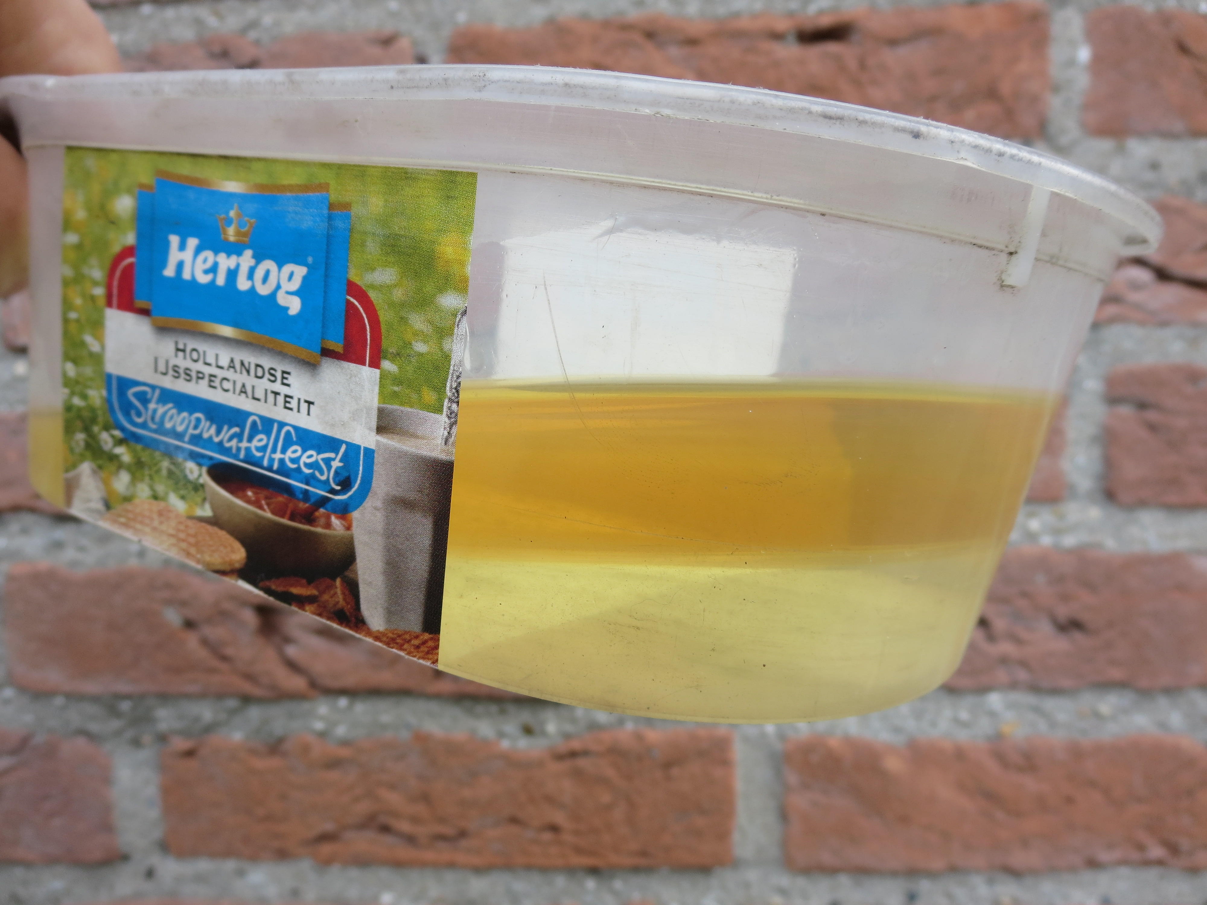

Water could be your problem. I had a similar issue, but it happened after I tanked the car. If you suspect water is in the fuel system, I would take a sample close to the engine.
It is easy enough by removing the return line going from the FPR to the tank. That is the line that goes from the engine next to the fuel filter. Its very low pressure so no worries about fuel spraying everywhere when you disconnect it.
Find a 2 litre container or an extra length of hose to a bigger container. Anything bigger than 2 litre is hard to get into place to catch the fuel. Run the pump and catch 1 - 2 lires of fuel, let is settle and check for water. See photo for what came out of mine.

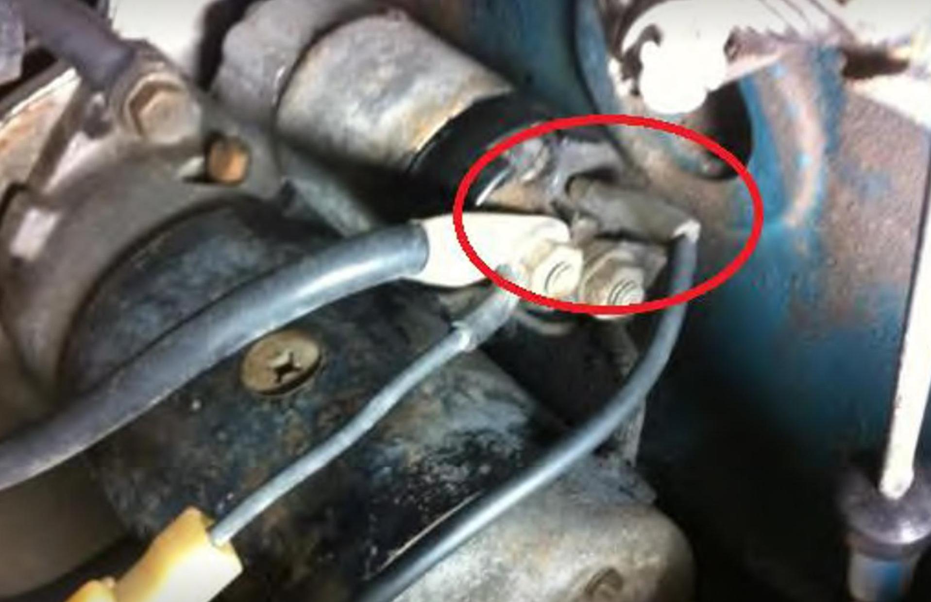

TIP: To run the pump without cranking the engine endlessly. Not good for your starter or battery. Unplug the wire with the spade shaped terminal on the back of the starter. Follow the big starter lead to the starter. It is located above the two big M8 terminals. See second photo.
Now if you hold the ignition key in start position the engine will not crank, but the pump will run.
