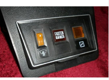

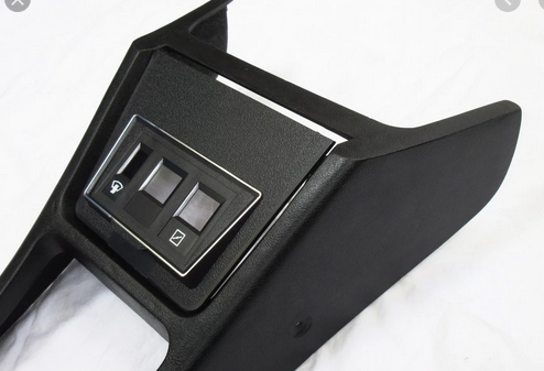

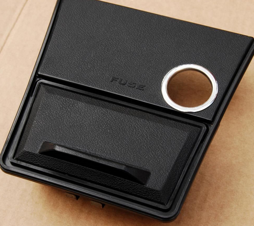

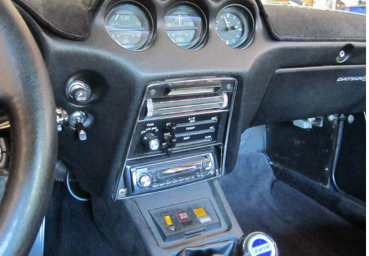

     my car is in the process of getting most of the interior parts reinstalled in the vehicle.  When i purchased it, the interior was basically stripped and i have been piecing it back together. MY question is which piece should i have in the location directly in front of the shiftier.
is it this?
or this?
or this one?

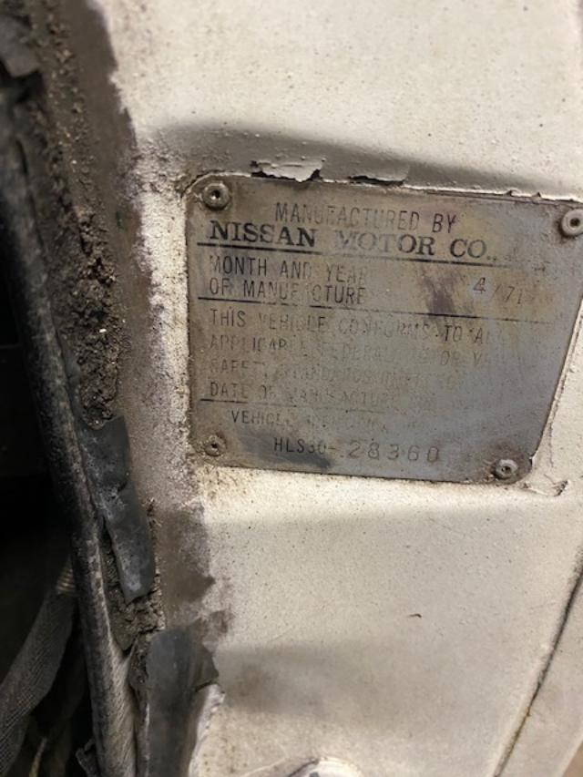

i believe it is the first pic because i do not have a series one car.  Vin pick below:
https://www.classiczcars.com/topic/63281-center-console-1971-question/
Up to 8.71 the console with the ashtray was installed in the 240z.
After that was the other console version with the switch plate.
Another way to be absolutely sure: whatever one fits in your vehicle as they are not interchangeable.
20 minutes ago, clocatelli said:

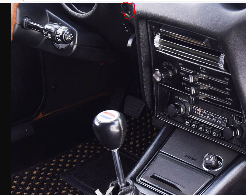

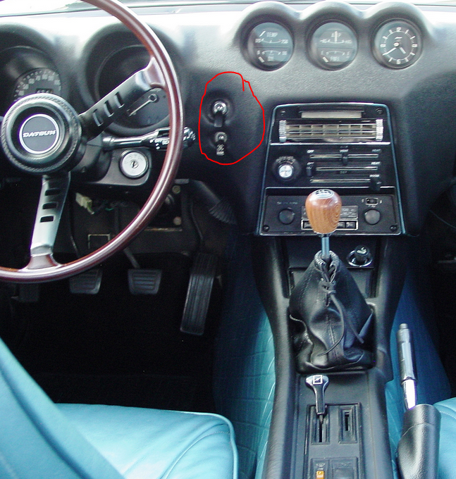

i think i got it.  the below pic is where i need to be.  What is the top switch suppose to do circled below:
I think someone added that, as I'm not aware of any Z from the factory having two switches there. It's normally either a blank, or a cig lighter. I believe only 72-73 Zs had the cog lighter, and your '71 should have had a blank.
