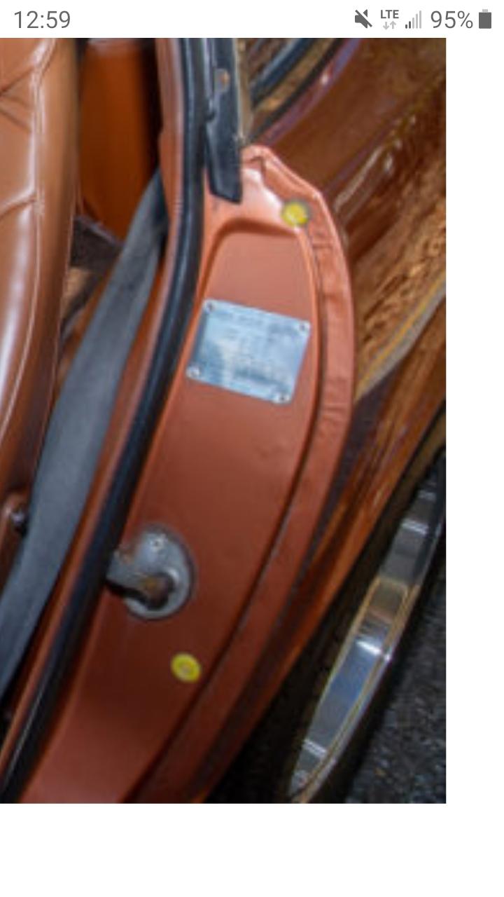

5 minutes ago, siteunseen said:
What are those yellow dots for? I've never seen that before.
The car was rustproofed back in the '70's.  A company called Ziebart used those yellow plugs to plug the holes they drilled into the car to squirt their rust proofing in.
