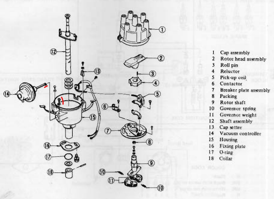

I don't recall any pins on the vacuum advance unit.  Just the tiny screw that attaches the arm to the breaker plate and the big screw that locks the unit to the distributor body.  Usually you can twist the unit after the big screw is out to break it free from the distributor body.
Couldn't identify the tiny screw so I just marked the spot where it attaches.  Remove those two screws and all that holds it in is corrosion.  Some heat on the body (housing) might expand it enough to break loose.
Thanks for the reply.  A picture in this case is worth a thousand words.  My words often come out wrong.  The pins I referred to were for the bottom drive collar and the pin in the reluctor.  That process went smoothly.  The diagram #6 is listed in some parts look ups as the reluctor and has some specs for California emissions or high altitude applications only.  The contactor in my distributor is a bit gummy and grimy.  Not sure if a good electrical cleaner would be sufficient or purchase a new one.  I do not believe my resurrection project-1978 280Z-has the California emissions.  No air pump or Oxygen sensors on this vehicle.  I will continue to do some more research on the parts but the vac advance unit seems to be non existent so far in my search.  The other question I had was about diagram #13 listed as cap setter.  The parts diagram I had lists it as a "slide".  Definitely  bent in at the top along one edge.  Glue or corrosion?  Some more cleaning and time will tell. Thanks again, John-Lugoff, SC.
That slide is as you say, a guide to insure that the cap is put on in only one direction, sounds like from your description that someone forced the cap on 180 degrees in the wrong position and crumpled the guide. It is made of thin zinc plated steel held in by one screw and if the corrosion between it and the cast aluminum is bad enough you may have to destroy it to get it out.

The "slide/setter" has a lot of wiggle room even when it's new.  Once you lock the spring clips down on the cap it doesn't move.  It's not a precision piece.
