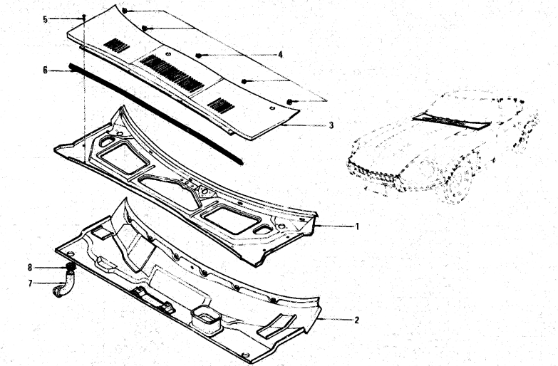

It is an interesting part.  Its back edge is the front face of the pinch weld at the bottom of the wind shield.  The back corners fold in where ~ 4 pieces of metal come together at the bottom of the A pillar. There is also weld bead, sealant and solder at those junctions.
The front corners also have bead welds where the inspect hatch hinge mounts are attached.
To clean up the part I hack out of the donor car involved some grinding and a lot of spot weld drilling.

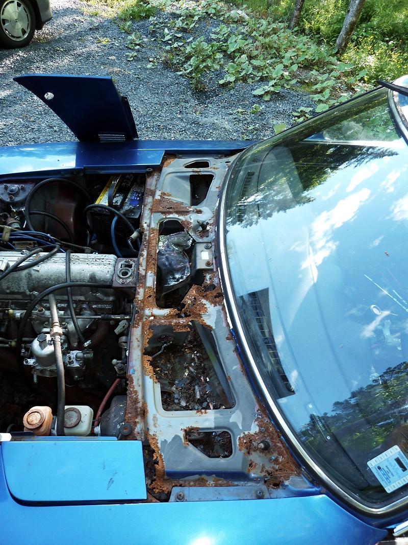

Removing the panel from Blue will be fun.  I will get to it when I have the car gutted and stripped down.

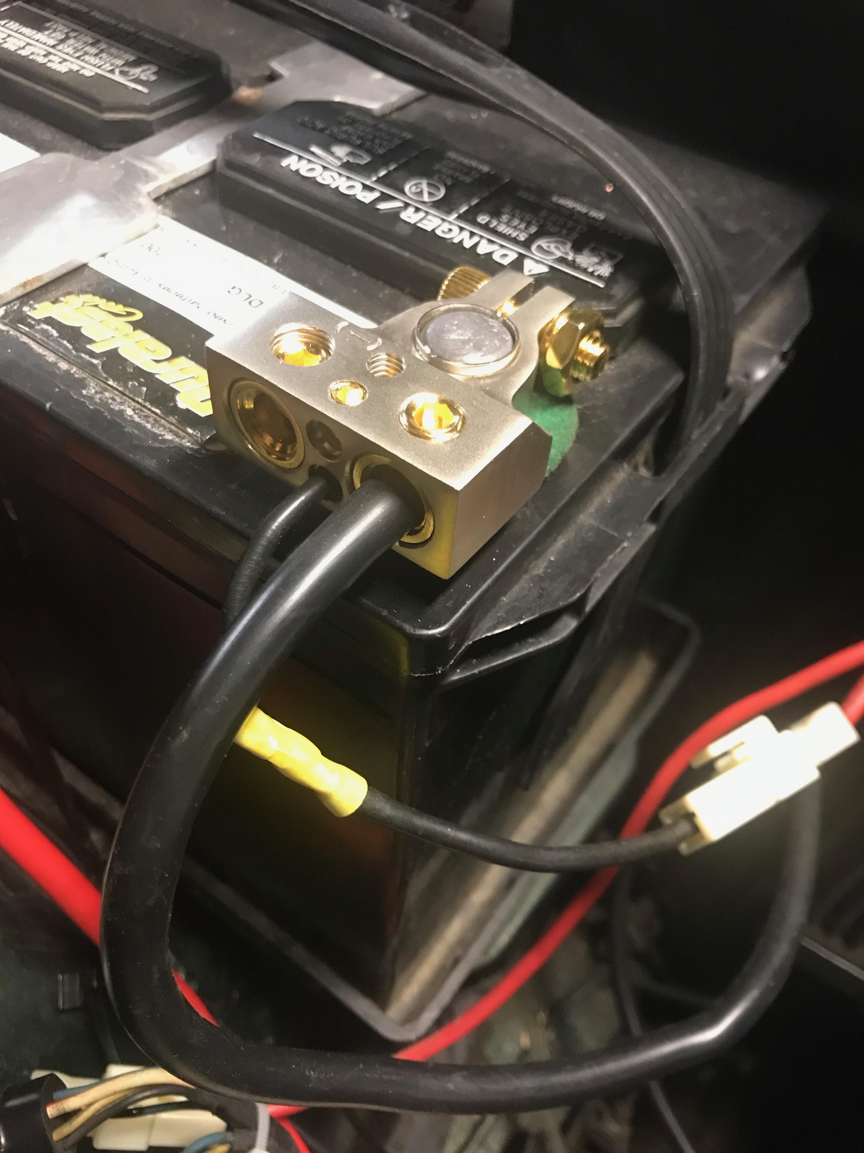

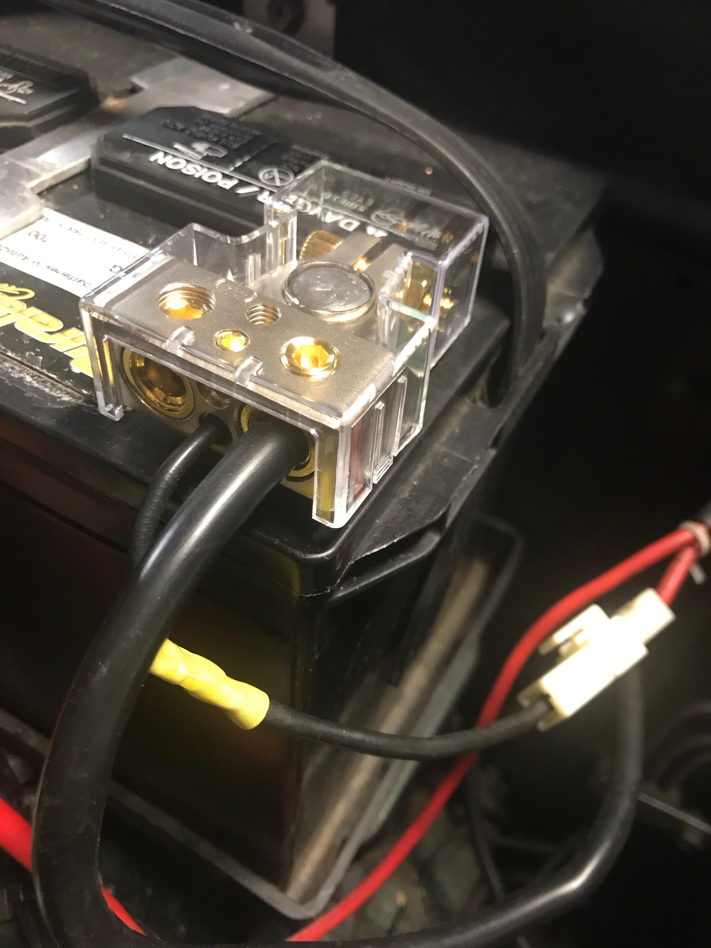

Battery Bling!  Finally got around to installing new battery terminals that have sat around about 4 months.  I like the way they look and will be great for the eye candy part of car shows but the functionality will require more effort. Instead of just a 1/2" (13mm) wrench,  I'll have to add a full set of Hex keys and a 9/16" to the tool carry kit.  The plastic covers look good too but there's Nooo Waay that I will ever let an Autozone guy replace the battery without me removing them first.
