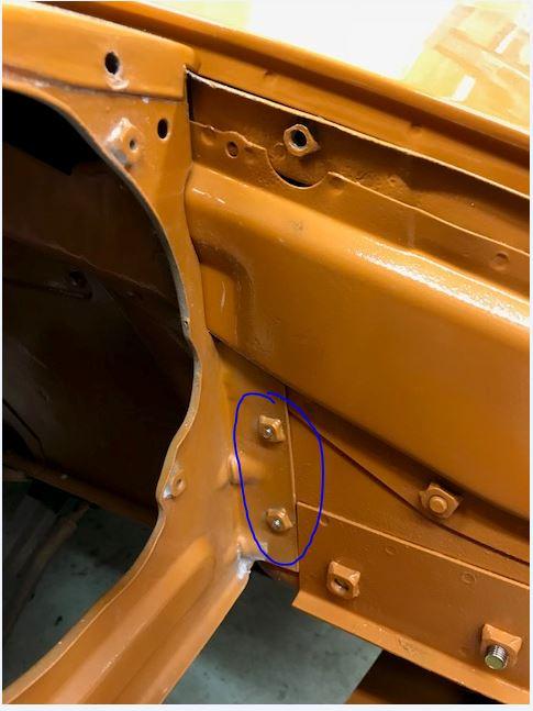

I can appreciate everyone's point that the hinges may be worn.   The reason I am skeptical in my case and possibly BoldU's  case is that the hood closed properly before it was removed.  I would think if the hinges are worn, it would not have closed previously. Anyone disagree?

Then perhaps the fenders/sugar scoops were sitting higher?

I hoped that was the case but there is no adjustment to the front of fender.  This is the right front.  Either it is bolted to the subframe or it isn't.   Also, the long horizontal stamping just above it prevents the fender from moving up and down.  (Ignore the hood height in this pic. It isn't closed or latched. btw).
There is a small amount of adjustment in most of the front end pieces because of the size of the holes in the panels. May not be enough. Is your grill removed?
I would loosen the hood bolts and the hinge bolts and try pushing the hood down and retightening it again. If it fit before, it should fit now. You can also look at the way the hinges shift when pushed down. Then you could adjust them more in that direction with the hood up. The hood may be stopping against the fender before you get the hinge where it needs to be.
