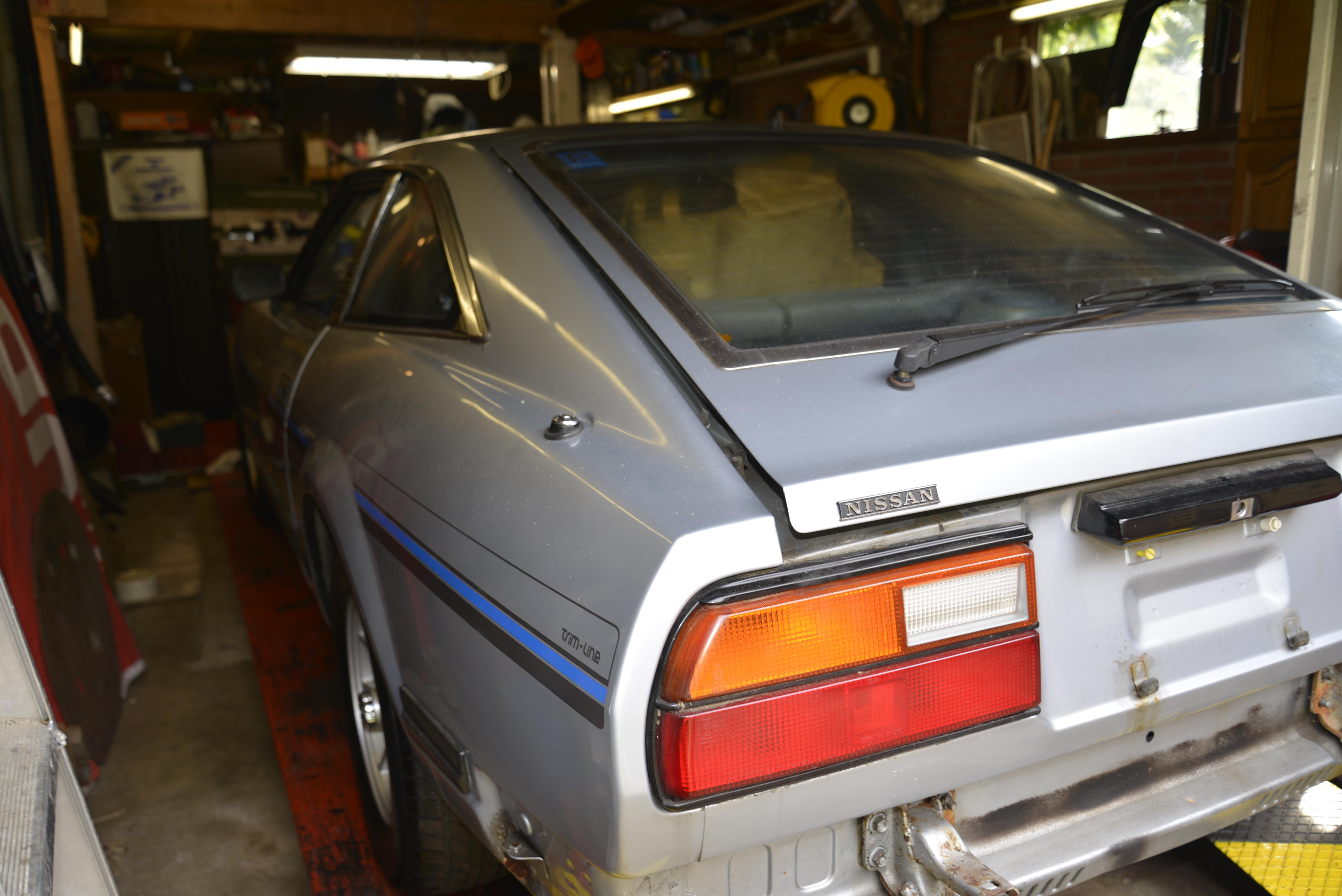

Hello, Yours is a 280z 1978? I'm still not sure what color my 280zx 1979 is i thaught it's #510 sky blue metallic also but i can't find the paint color number on my car..
what do you guys think? see pic.
Thanks in advance!
