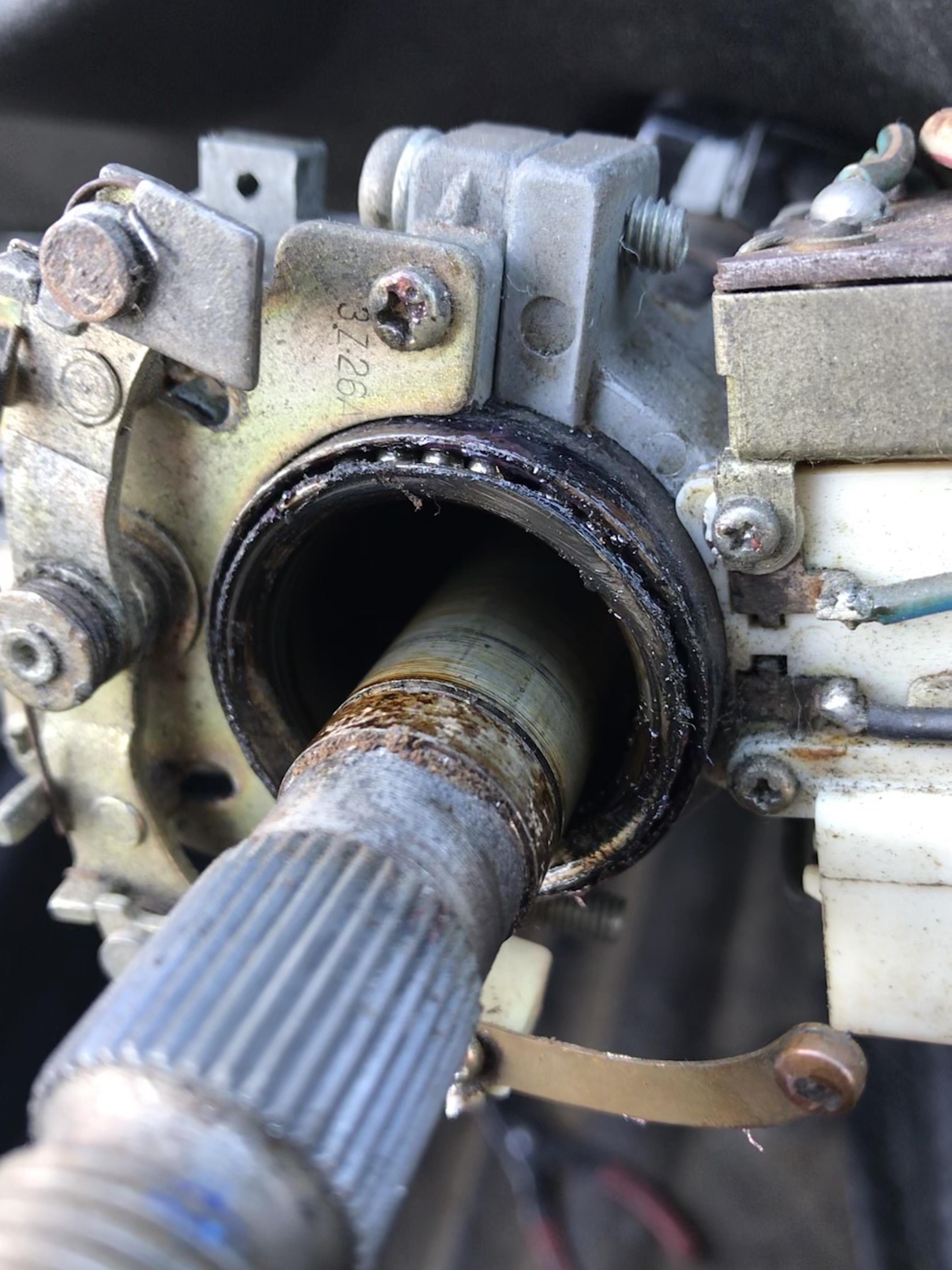

I have an early 260z and wanted to know about this upper steering bearing. I hear this annoying squeak coming from the bearing right now, but i cant seem to find any replacement options (NLA) 48910-23100 #5 on http://www.carpartsmanual.com/datsun/Z-1969-1978/steering/steering-column
it seems super dirty, if i cant replace it, is it possible to remove the inner housing and clean+ repack it? it looks like some of the balls are missing as the distance between the balls are not consistent.

I've never found a way to get them out without destroying it, the big gap in the ball bearings is suppose to be there, at least all four steering shafts I have torn down where the same. Basically all you can do pull the whole unit from the car, wipe away the big grease and spray it with brake cleaner or carb cleaner and blow it out with compressed air.  Repeat that 5-6 times then repack it again with fresh bearing grease using the palm of your hand just like wheel bearing.
Removing the top C ring #8 you can do by yourself but getting it back on is a 2 man job because you have that large spring to deal with. But it's worth it, steering movement is so smooth afterwards, it also give you a chance to clean the contacts on the column switches.

I repacked it just now, it’s much more quiet. Thanks for the advise, the strap technique made it straight forward @zKars, @grannyknot yeah I had to  ask for a hand, make it a whole lot easier.

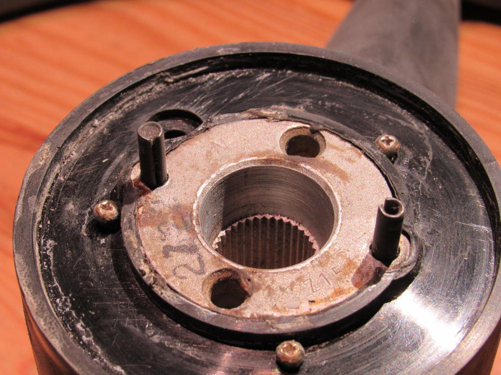

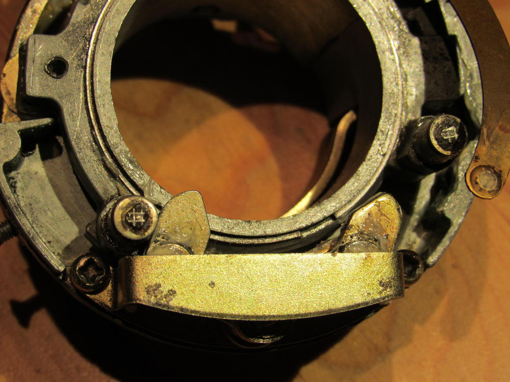

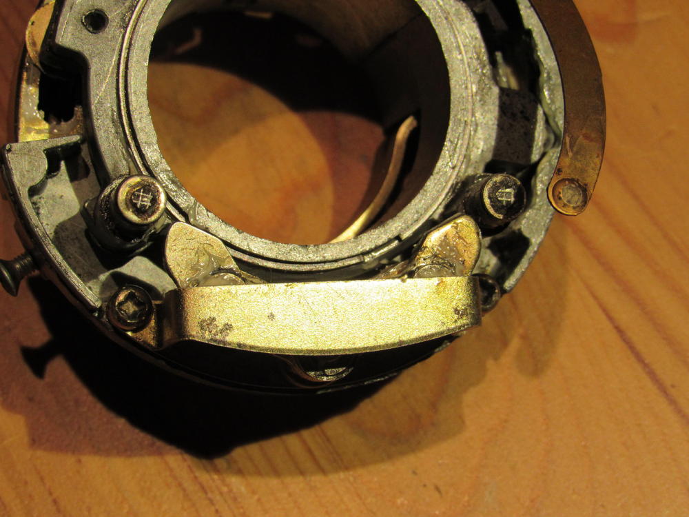

This turn signal unit is off of a 510 but it's the same mechanism, those 2 ears on the signal unit are pushed out into the path of the 2 posts on the underside of the steering wheel when you signal a turn.  As soon as you turn the steering wheel in the opposite direction after completing your turn one of the posts will hit the ear and force it out of the way, canceling the signal and breaking the electrical contact.
That's where you need to look, sometimes the posts or the ears get bent or broken off.

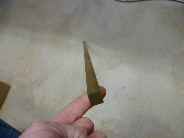

Tap the bearings out of the housing if you dare. I used a long chunk of brass rod because that's what I had laying around and used that to tap the bearings out from the far end. The bearings are press fits into the column tube, but it's not a very tight press. Work your way around the perimeter tapping gently and you can walk them out.
Here's the long brass rod that I used:

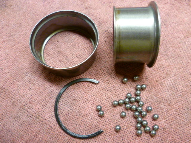

Then once you get the bearing assy out, you can pop the retaining ring and lose the balls:
There are thirty balls in the bearings so you can count what you have to make sure you didn't drop any:
I've been through this job a couple times now and I have added additional balls to the bearings. Not necessary, but I like the feel. I think it tightens things up a tiny bit. Originally there are thirty balls and I usually add one on each end. @Sean240Z added two balls to his and he really likes the way that turned out as well.
