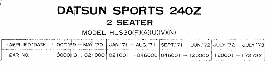

36 minutes ago, 240260280 said:
This is messed up.
Vin # to 021000 in May of 1970????   My July 240z is Vin # 0007032.
Then it jumps to Jan 1971-----what about June, July, August, etc.????
Just saying there's a big typo here.

1 hour ago, 240260280 said:
@Carl Beck seems to simply have coined the term to follow blocking of production as per Nissan's documentation:
Nissan seems to have done this in many documents. Here it is from microfiche:
I certainly did not coin the term - I’m not that OLD!   The use of Series designations to distinguish one model from another of various Marques, when confusion existed because of terms like “Model Year” -  has been around and in use among auto enthusiast since I can remember. The E-Type’s for example used Series I & 2 when both models were sold with the same Model Year designation back in the early 60’s. (Some say Flat Floors) So nothing new there. Series designations were applied to the Datsun 240Z’s by enthusiasts not to long after Nissan sold the same model as both 1970 &  1971 Model Year vehicles, long before the Internet. We know there is a large overlap in the Registrations and Titles of 1970 &1971 Model Year examples.
The first, second, third and fourth Series of Chassis Serial Numbers for Datsun 240Z’s are all specifically identified by Nissan in their Technical Service Bulletins.  There are four specific VIN number series used to identify them.(one VIN series for Left Hand Drive and another VIN series for Right Hand Drive).
 Nissan issued Technical Service Bullets listing the beginning VIN chassis serial number series (Vehicle Information + Chassis Serial Numbers)  as well as what Nissan considered major improvements to Safety, Comfort and Convenience of each - all introduced at the same time on the subsequent series.
