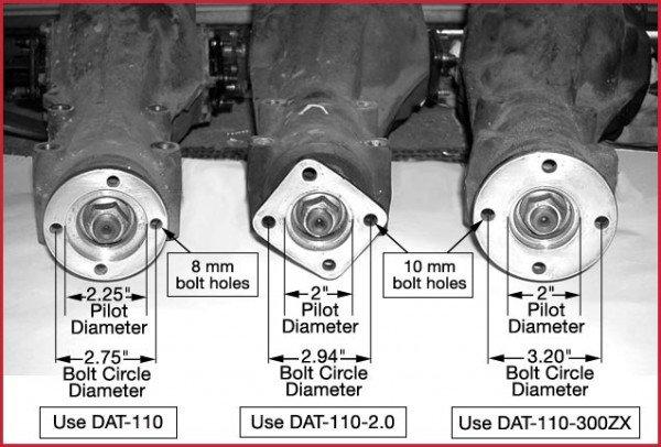

Happy 2020! Recently acquired two Datsun R200 diffs. I'm a novice with Z the drive train configs so bear with me.
The diffs are the same gear ratio. One has the input yoke listed below as DAT 110 and half shaft flanges on each side.
The other has the input yoke listed as DAT 110 300ZX with no half shaft flanges. Both are round input yokes, one smaller than the other.
In addition to the yoke comparison below, how can I determine which Z these diff's came from, Z31 or Z32.  Serial numbers ?
If the assumption (based on the image below) one is from a 280ZX and the other is from a 300ZX, is one diff preferred or better over the other? Reason I'm asking is only one will be completely rebuilt. Would like to spend the money on the preferred diff and keep the other for the ring set.

Nissan went to the short nose R200 in 1985, when they went to the rounder 300ZX body shape.  And the DAT-110-300ZX pattern shown in the picture was also used for one 280Z year, in the 1975 280Z.  The fact that the axle shafts are gone could be for several reasons. Somebody could have taken them to use in a diff that came with CV half shafts.  Look down the axle holes and see if the retainer circlips are inside.  If they are it might be a 75 diff.  If they aren't it's probably an 85 or beyond.
They'll both work in your car but the one with the axle shafts is probably easiest to get in there.  I don't think the ring set alone is really worth much, except as garage art.

Hi Zed Head,
Our mind sets are the same with the diff "low budget with high value". Both are long nose carriers and appear to be the same size. I'll check for the retaining clips or clip grooves in the axle holes of the Yoke size DAT-110 300ZX.
R200 with the haft axle flanges installed and the DAT-110 yoke. This diff came out of a running car (240Z) with stock half shafts and stock sub axle mounts (at the wheel). Are there any bolt in options for CV axles for this set up without mods?  Or are the options limited to weld in sub flanges and other mods to install? Easy is not always cheaper.
R200 diff with DAT-110 300ZX yoke, if retaining clips are present,  less expense to find and install CV axles with the stock sub axle mounts (at the wheel) ? Or more mods?
Reason for retaining unused ring set, both diffs are the same ratio, not for resale, future replacement part if needed.
I think the short nose R200 started with the Z32 in 1990. The much sought after CLSD’s with the finned covers from the 87-89 300zx turbo’s were long nose.
https://www.classiczcars.com/topic/63398-r200-comparison/#findComment-590887
You're right, I screwed that up.  I even spent some time looking around to make sure it was right and it still wasn't.  I think I had CV axles and viscous and short nose all blended together in my head.
https://www.classiczcars.com/topic/63398-r200-comparison/#findComment-590898
I've only seen weld-on CV conversions that were any good.  And that's for bolting them to the wheel-side axle.  R200's are all clip-in on the diff side.  The clip is either on the axle or in the diff, but they work the same way.
No offense but you're asking questions that can't be answered because that's not how the R200 works.  Did you look in the hole yet, for the clips?  Your diffs are probably essentially identical.  You can also pop the axles out of the one diff and try them in the other.  Use a chisel or big screwdriver to pop them out.
