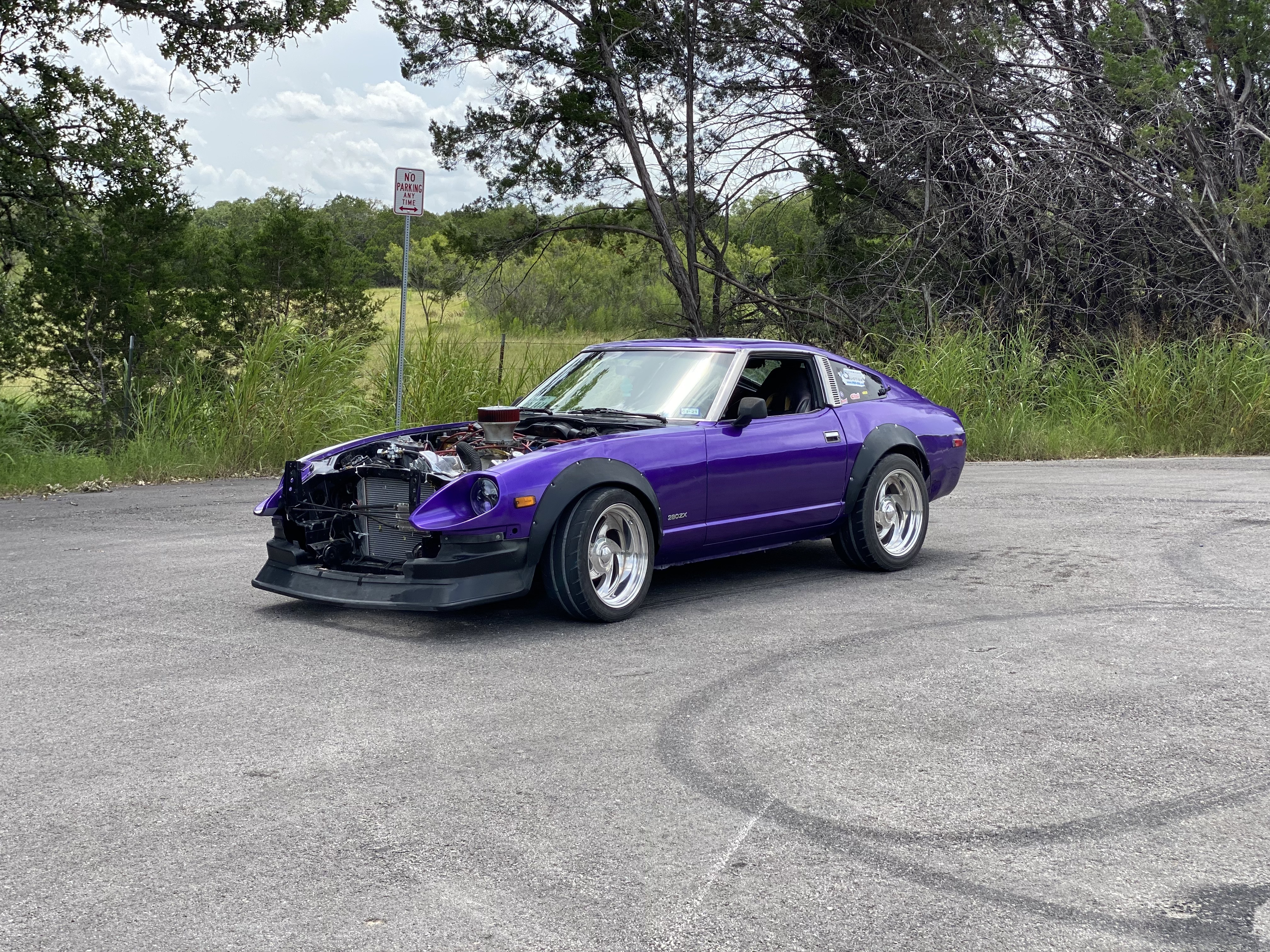

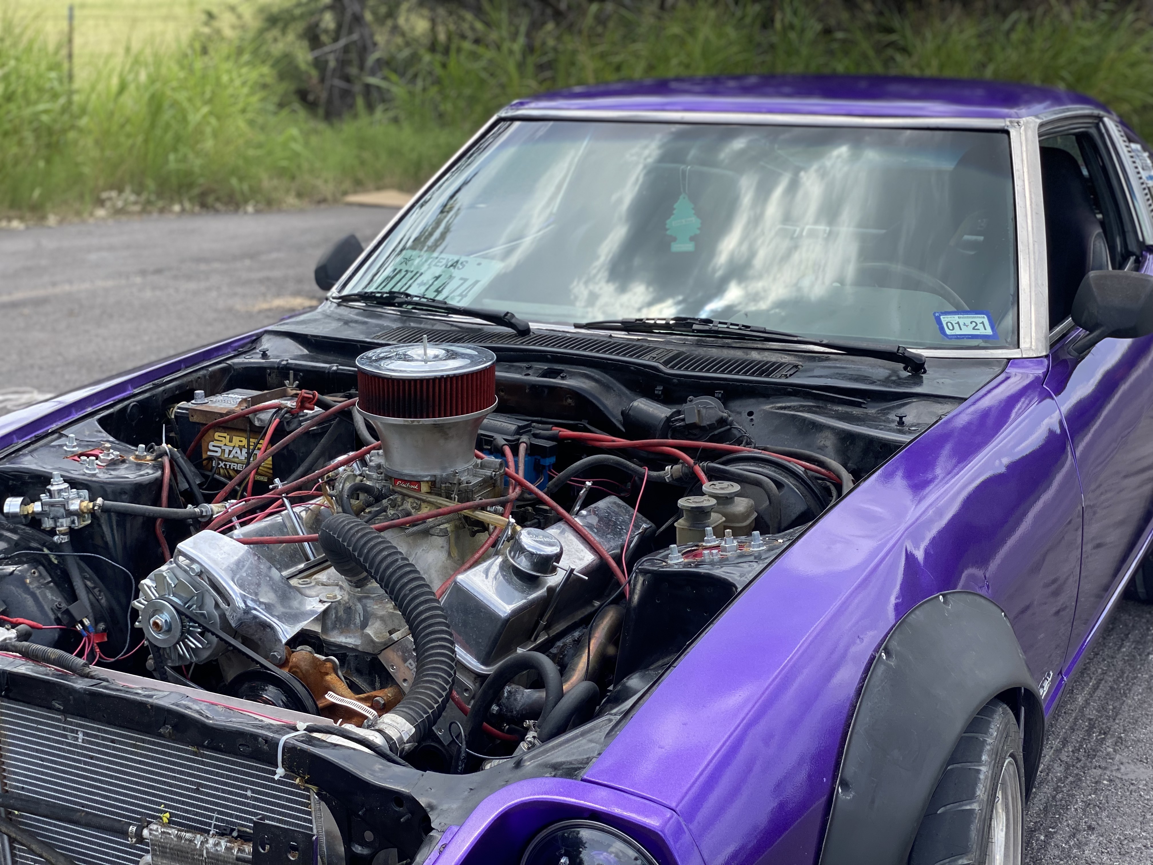

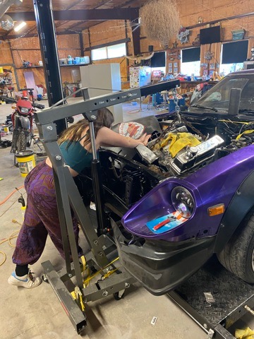

quick update:

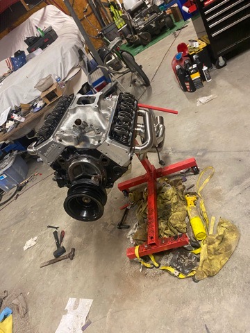

engine has been fully assembled, only had to do some minor grinding on the block for clearance of the rod caps and bolts, and of course they forgot to send the flexplate so i had to wait for that after 3days of customer service calls, but they were nice so i didn't really care.  i sealed everything to RacerX's advice so now the engine should hold oil as intended, lots of nice parts so i'm excited to get it running!
Engine and trans are back in the car, currently working out how to make these headers fit, if i can get the driverside to fit then ill just use a blockhugger on the passenger side for the time being. i borrowed an oxy acetylene torch from a friend and the goal is the bend the collector slightly so that it stops hitting the frame rail allowing the header to bolt up, and i've made a sizeable dent in the primaries to clear the gearbox, but i'm out of oxygen so i'm waiting on another tank before i can finish that task.
i drained the fuel cell today, gonna replace all of the rubber lines and the fuel pump. i installed a fuel pressure regulator as well so that i can monitor that and keep the carb from flooding at idle.
car sits almost a full inch higher than before just from the amount of weight removed from it, and it has a much simpler look now which makes me happy. i'm gonna have to get a cage fairly soon, i'm thinking the jegs 12pt cage for the 240z and just modifying it slightly to fit the zx(if anyone has done this chime in with your experience), i have a good welder and a tubing notcher so install can only be so impossible, but that'll be a summer project.  i attached some pics hopefully of the engine on the stand and of my girlfriend and i installing the engine and some misc snapchat stories from building the engine and stuff. ill update again when its making loud noises!

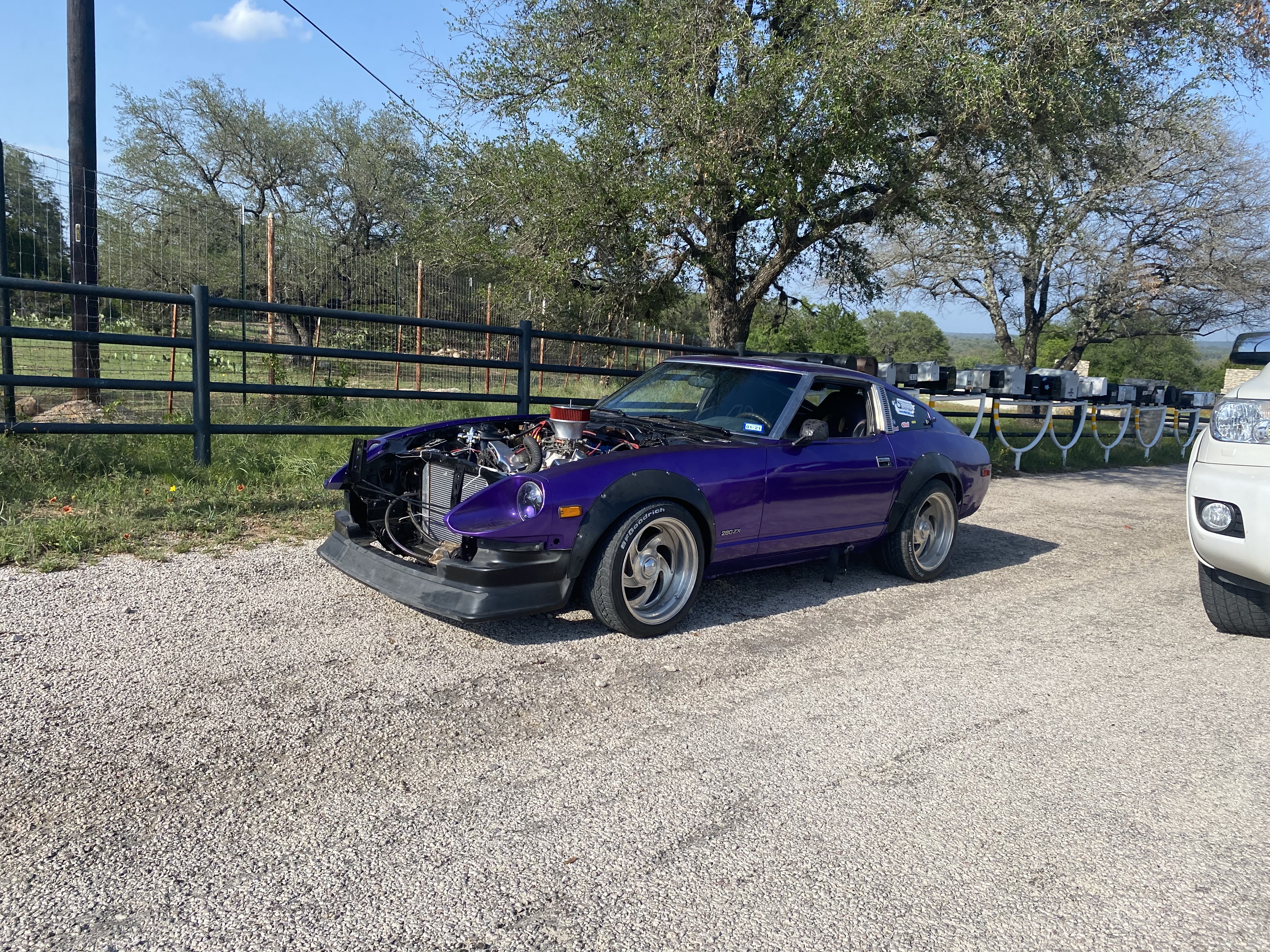

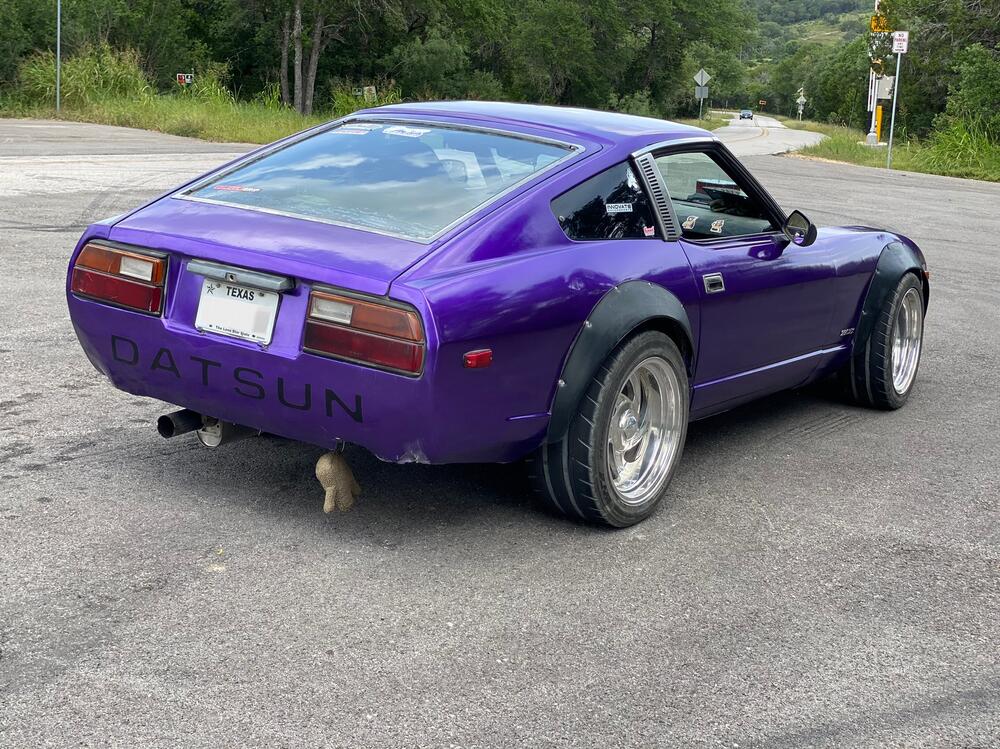

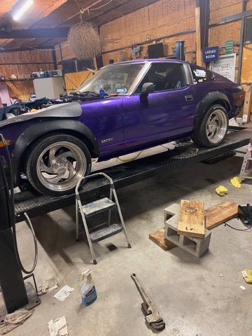

its been a min since i posted an update so here goes, ill try and keep it semi in order and ill attach lots of pics cause itll be nice to look back n see the progress ive made.

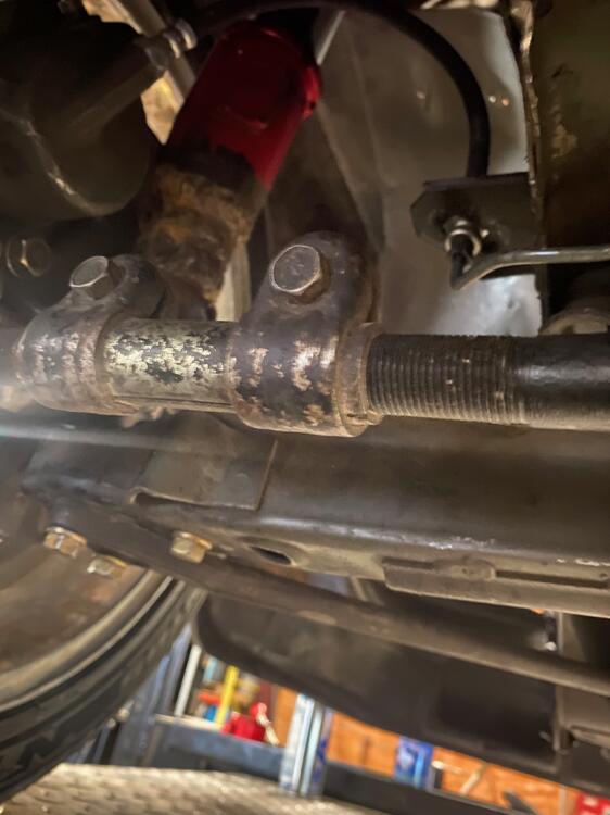

shortly after my last update i did the s13 coilover conversion, and noticed a significant improvement, next goal is to do sway bars but that will be a while.  i shed 19lb up front and 7lb in the rear, while not really important it was interesting seeing the difference. i used the maxpeedingrods coilovers from ebay, and they've actually been decent, should i need to replace them they are quite cheap. i did the alignment myself, -2.7* on the front and the rear is whatever cause i cant adjust it yet, and i set it to 1/8" of toe out but ill move it closer to zero toe soon.  i also added a bunch of rake to the car to offset the squat some and make the car look more how i want it to.

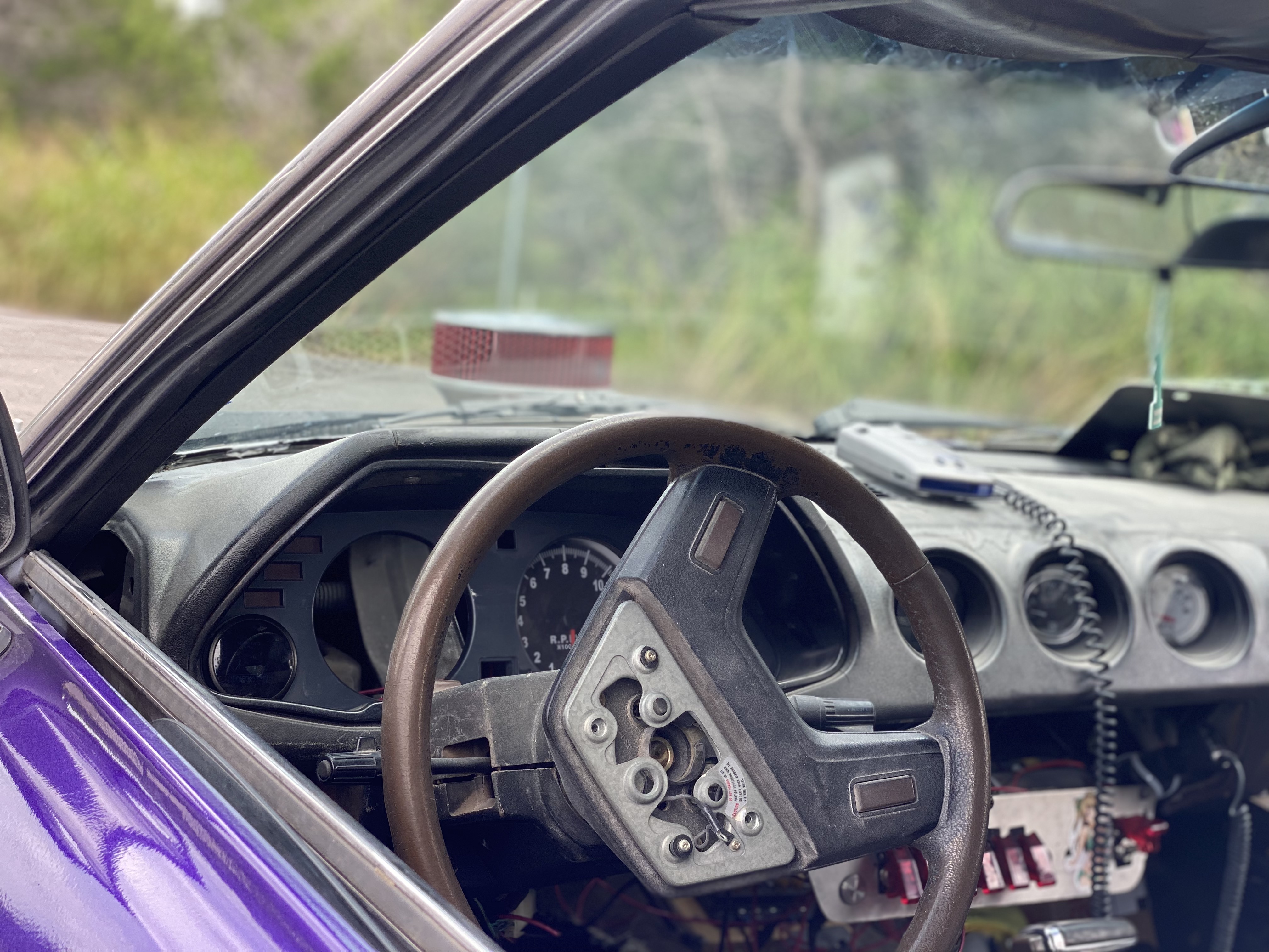

electrical: ignition wise i lost an icm inside my hei, replaced it and things got better, been having trouble with keeping all 8 cylinders firing but ill resolve it one day.  i also updated/cleaned up some wiring, so its easier to sort in that regard. i tried to wire the tcc lockup on my 700r4 but its not working so ill check my wiring again and go from there, millions of different ways to wire a 700r4 lockup.  timing at the dizzy also seems to randomly be slipping which is odd, gonna try a few things after its redialed in to resolve it.

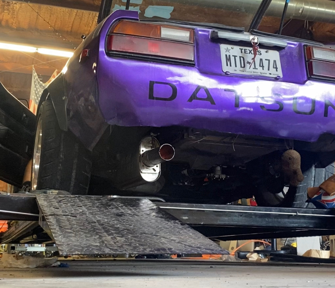

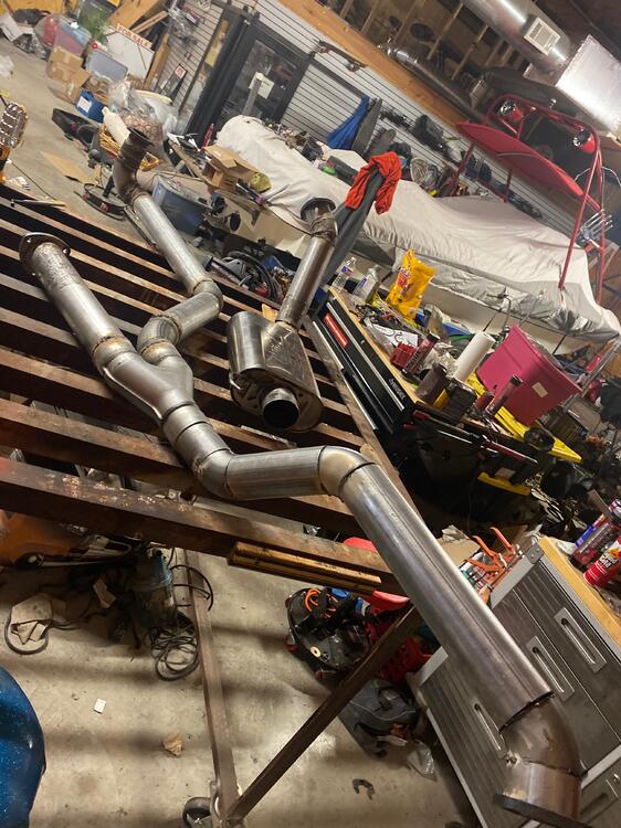

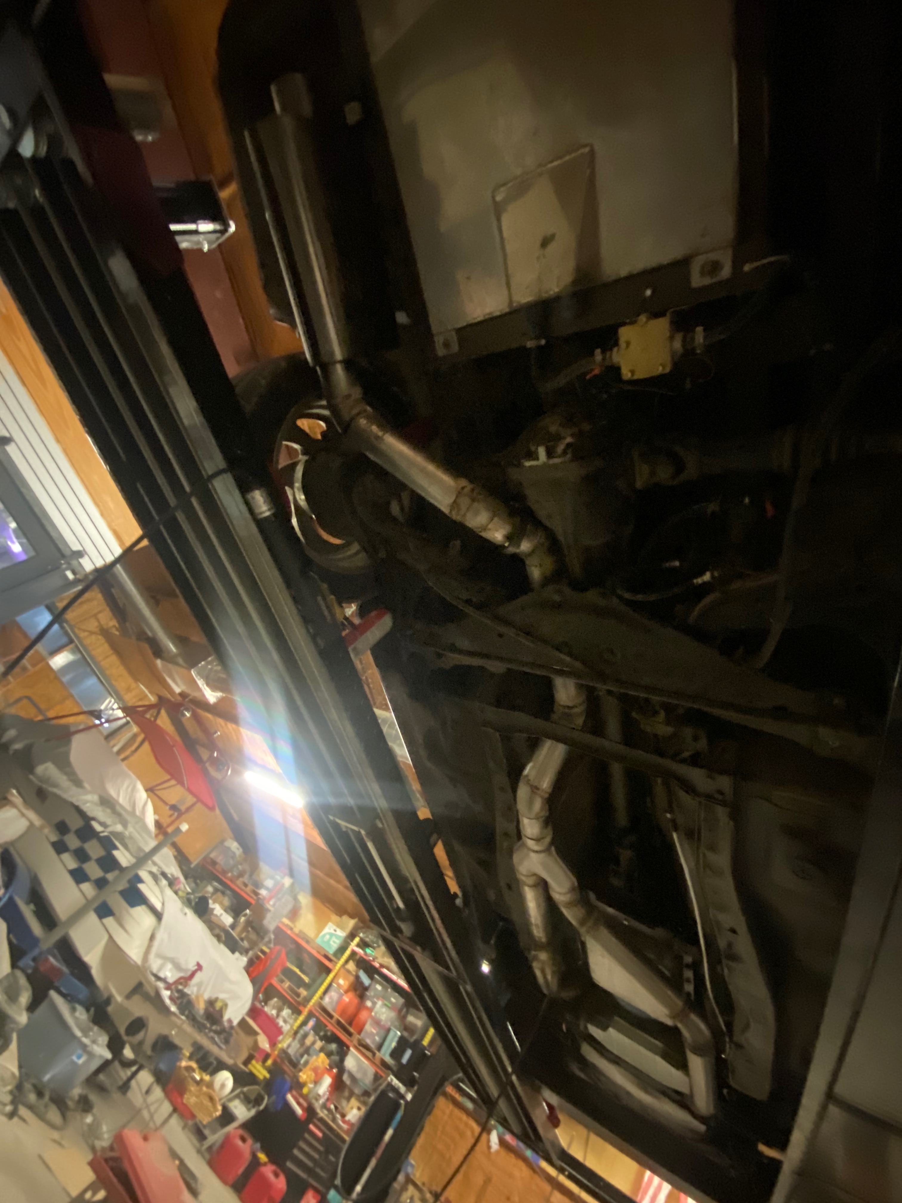

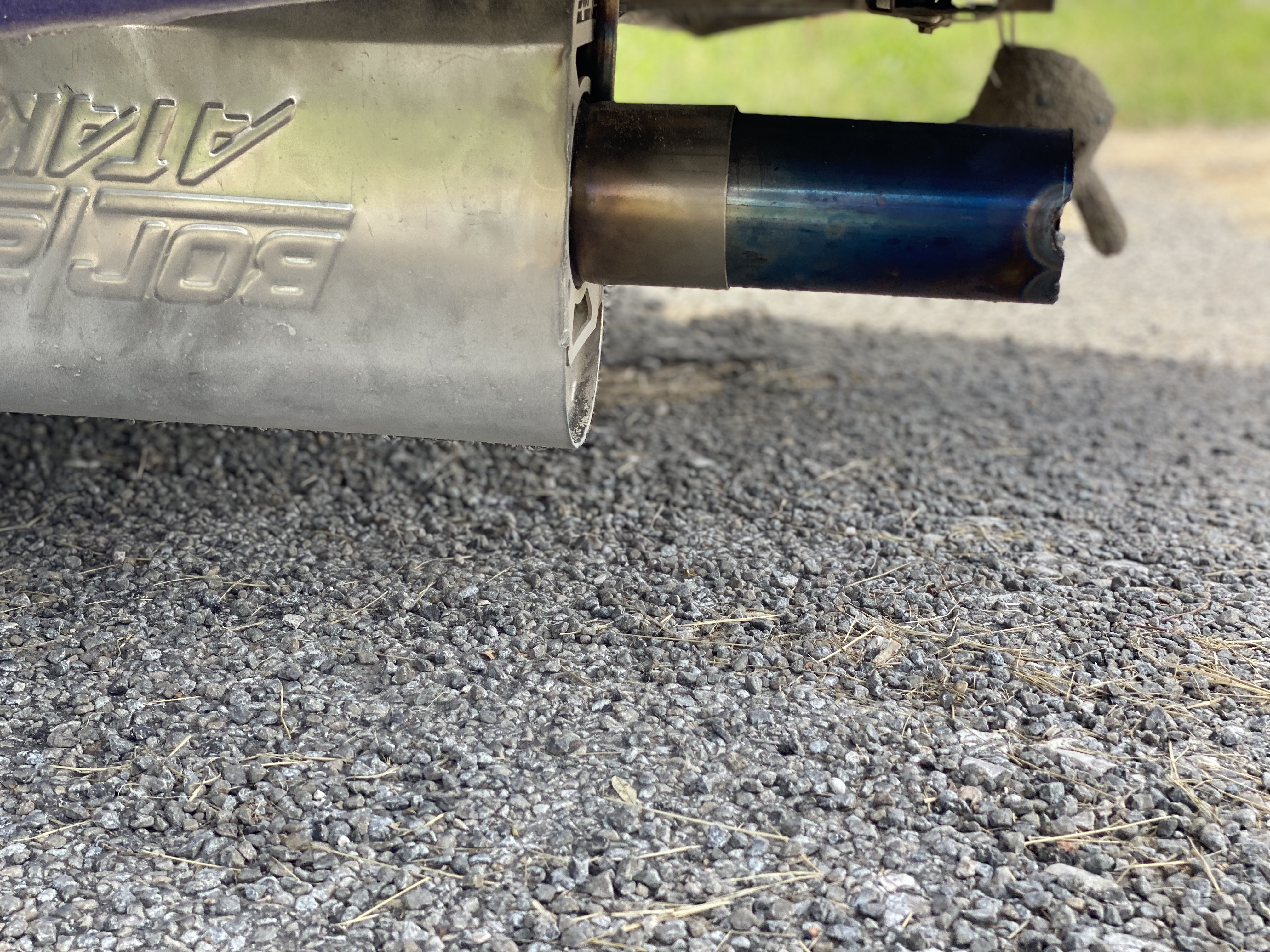

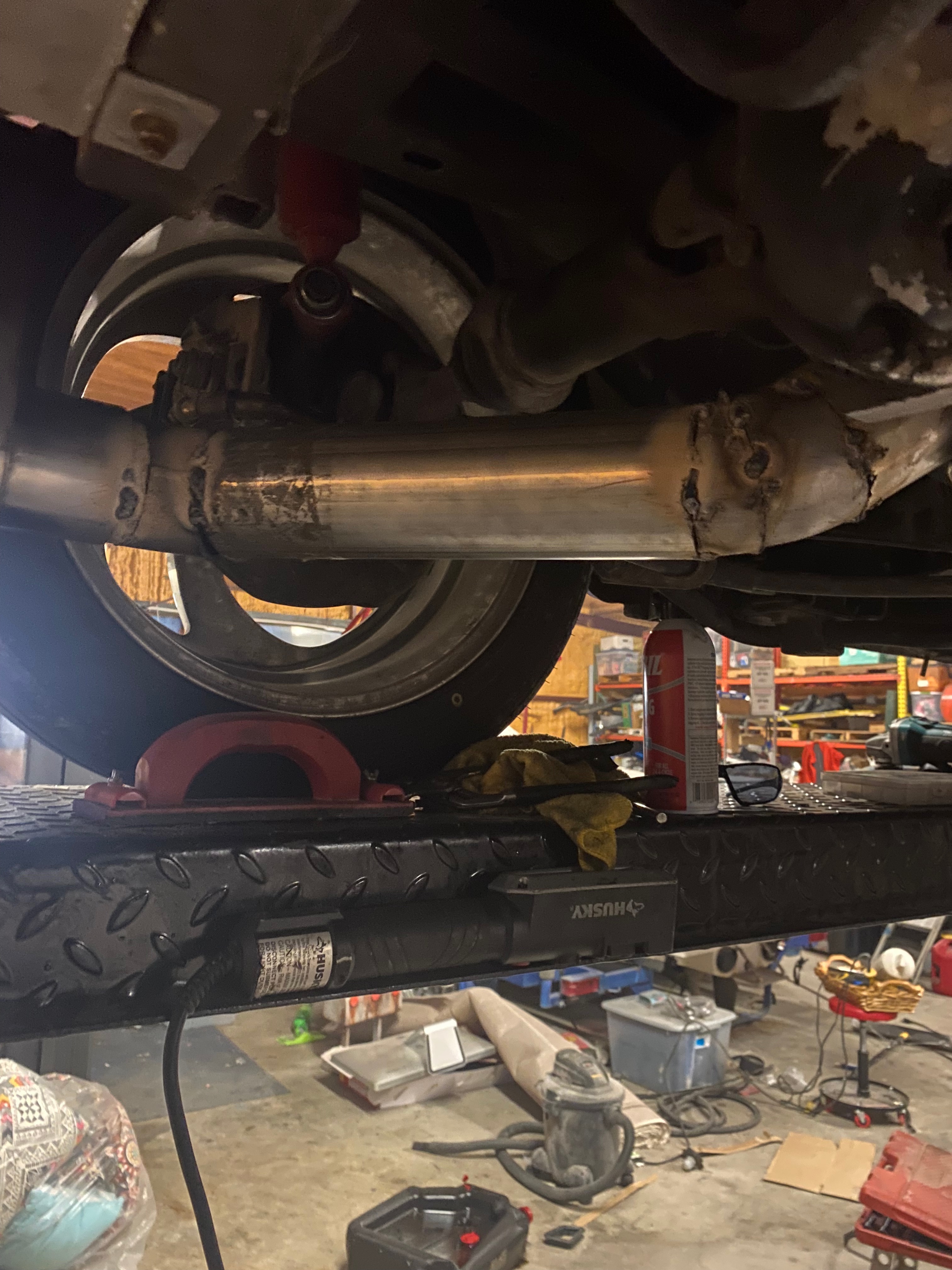

exhaust: i finally built a full system for it, i loved the open headers but after my ear dripped blood onto my shiny valvecover i had enough and decided it was time, i did dual 3" in to single 3" out with a nice borla atak muffler, it sounds literally exactly how i wanted it to so i couldn't be happier, and my ears dont ring after driving the car.  ill try to attach video of it.

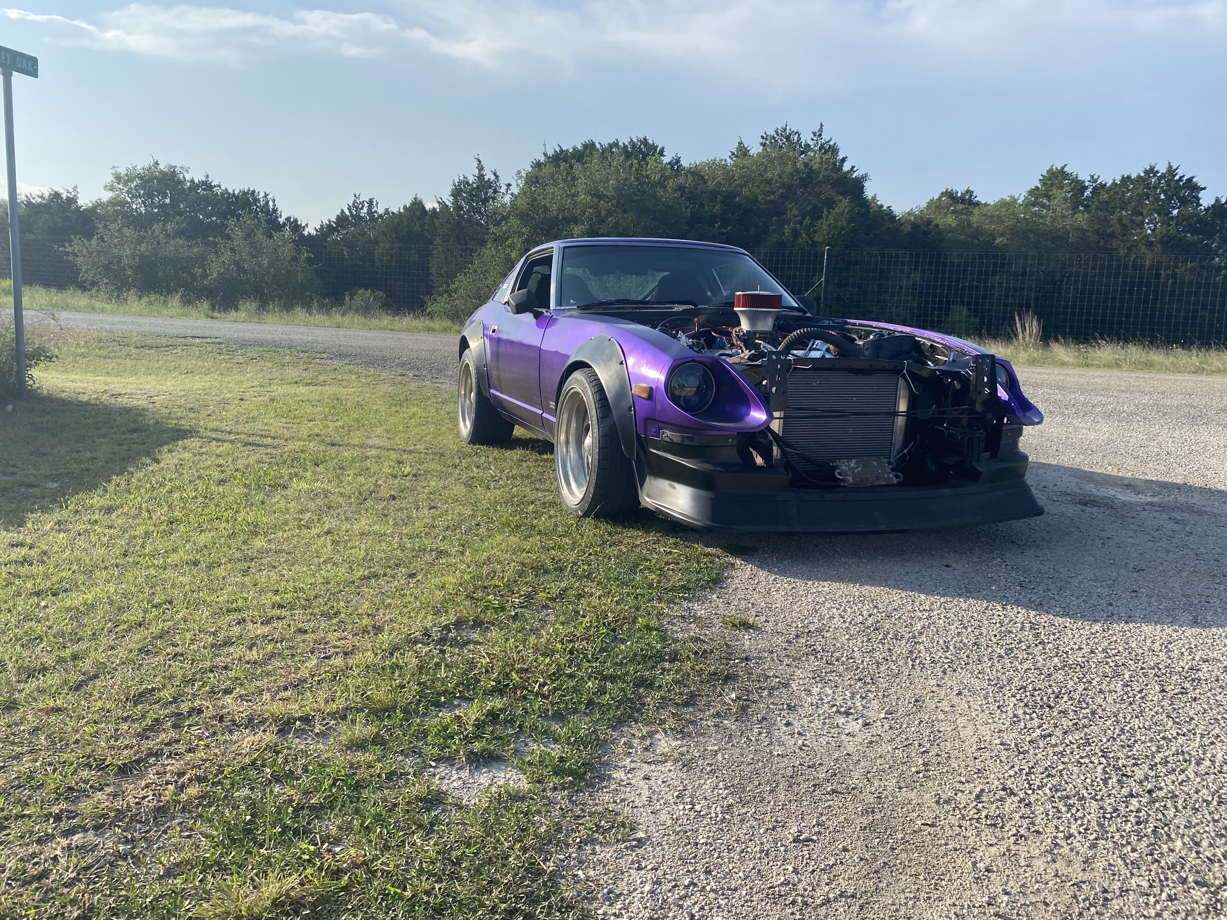

quick update, realized i haven’t updated this in a while.
july 25th: i figured out my jetting issue was timing, my distributor slipped and it had 12* total, i’m surprised it even ran. also trans gave up
