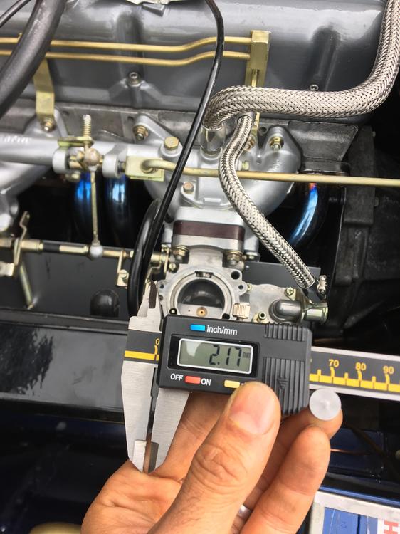

Get some brake disc cleaner or throttle body cleaner. Take off the domes and give the pistons, domes and the body of the carb a decent clean first. Take care to not mix up the front and rear domes and pistons; they wear together.
Buy a decent air flow meter such as this ...
https://rover.ebay.com/rover/0/0/0?mpre=https%3A%2F%2Fwww.ebay.co.uk%2Fulk%2Fitm%2F192596389772
Disconnect the choke cables form the carbs.
Using the nut at the bottom of the carb, Wind the jets all the way up and as a rule of thumb wind them back down 2.5 turns. I use a digital calliper to ensure the jets are at the same height, each full turn is 1mm down ....
45510a74733d01855437a6815318cdde.jpg&key=64d18b2feb0a7b28350101be003ba3bb835a4f6e13f2fb769b7cd1490648902c
Put the pistons domes and springs back on.
Use SU official oil in the dampers ...
https://rover.ebay.com/rover/0/0/0?mpre=https%3A%2F%2Fwww.ebay.co.uk%2Fulk%2Fitm%2F143244885465
Completely undo the balance screws and use the idle adjustment screws to sort out an even airflow at idle. I find the easiest way is to undo them completely so the bitterly is shut and with your finger in the carb mouth feel for any movement as you wind the screw down. Stop 1/4 turn just after you feel the tiniest movement.
Then start the engine and keep adjusting the idle screws each, watching the airflow meter until you get an idle without stall.
Then wind down the balance screw until moving the throttle linkage makes both carbs move together.
Then set the fast idle screw to get say 1200 / 1500 rpm and adjust the balance screw until both carbs are sucking equally.
That should sort the air flow and roughly the mix so the car is running better. Ideally you would want to check the float bowls have the same fuel levels before adjusting the mix but that will take a little longer and is quite involved. You will likely need to check that with your Z Therapy carbs too as they can become unbalanced due to vibrations during transport.
The above should give you 85- 90% well setup carbs for OK running.
