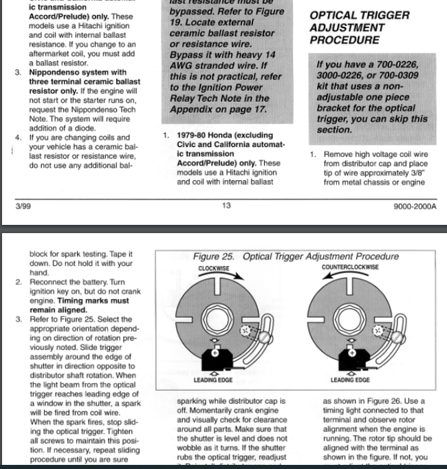

 @zdude1967 I have the crane system on my car. It gives you a lot of timing adjustment in the mount inside of the distributor. Now that you have TDC you should be able to point the rotor at number 1 cable then rotate the module on the bracket until the red light come on. That get you very close to Zero degrees. Now that you have it running you be close and that should open up your ability to use your light to set timing where you want it.

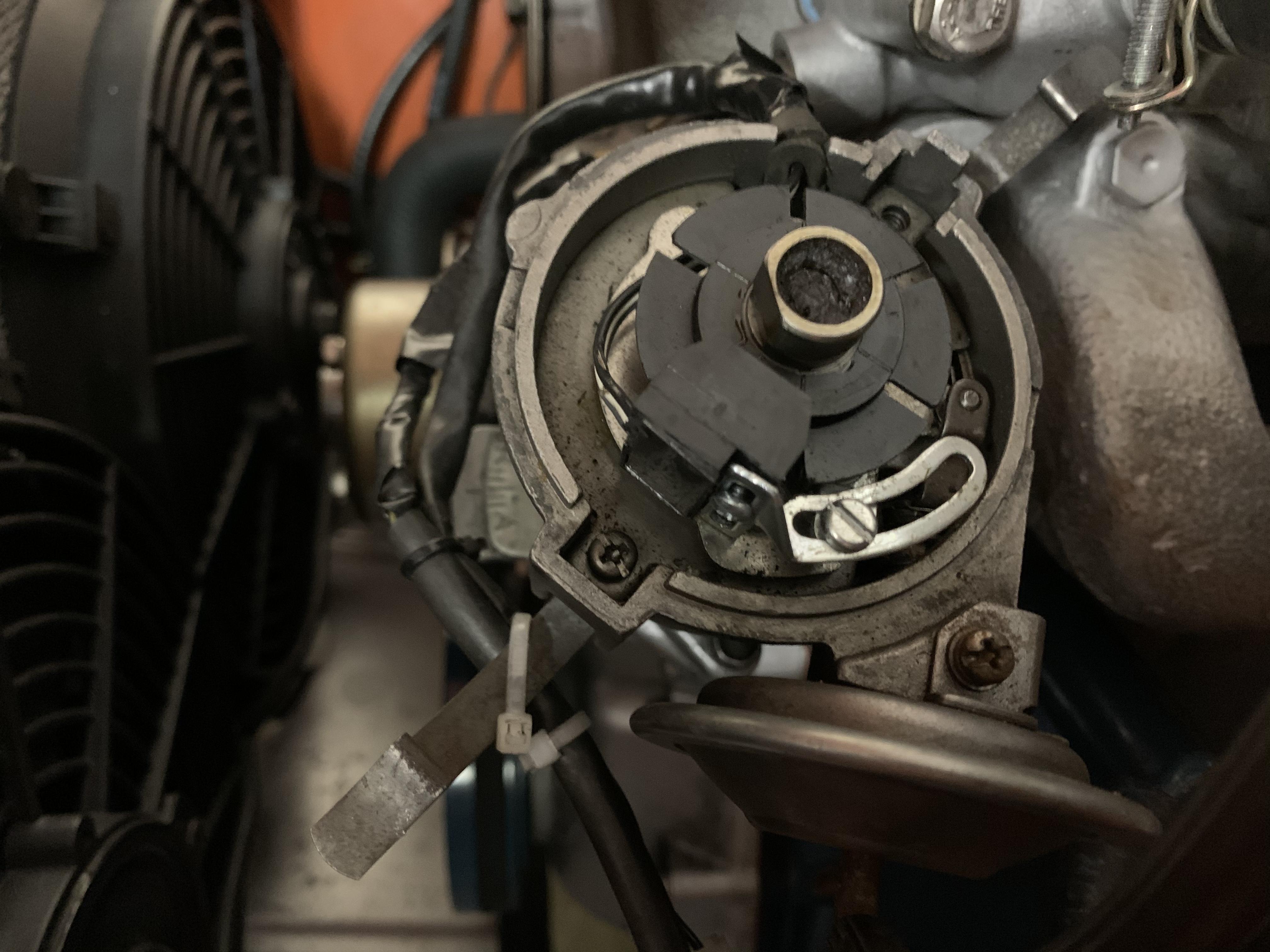

couple of pictures of mine. 8375B01E-CF3E-4322-9D21-DAB3849455A4.jpeg0249AD2D-A041-4360-B2A4-A708BF83FD1C.jpeg

‘No, moving the  module I s the last thing i did.  As I understand you located TDC, you have a pointer or created one. Mark your balancer, it is on the PS of the motor near the top of the balancer.  Set your oil pump drive spindle to the 11.20 position. Instal the rotor. It should point to the number one plug wire. If not rotate the distributor until it does. I use a sharpie to Mark the outside of the distributor so you can see where it is without the cap. Now you are a TDC with the rotor and distributor set the number one on compression. Turn on your key and slide the module along the mount until the light on the box comes on. Now you should be a zero degrees advance. Install the cap and install the wires following the firing order. If it doesn’t start rotate the distributors clock wise.

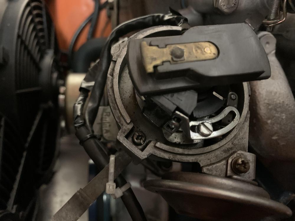

961C0923-CBEE-4D7C-A164-3FDA51157FE0.jpeg4833DAB7-1468-4FC9-8EEC-BED1C86CDEEC.jpeg9E3BCDBE-1E73-419A-97D7-50B0BB48DDEE.jpegModule4833DAB7-1468-4FC9-8EEC-BED1C86CDEEC.jpeg

I think that there is plenty here for zdude to get it figured out.  He got the engine started.  Understanding which way the trigger in the distributor rotates will tell him which way to adjust the sensor to get more advance.  Move the sensor in to the direction of rotation so that it triggers sooner.  That wil increase advance.  Your sensor looks like it is at full retarded timing.  No more adjustment.
zdude, you could even just move the sensor one way and see what happens to your timing, using the light.  One of the directions will cause more advance.  Move it more than you need and then you'll have adjustment at the distributor body itself.  The key is knowing that you just need to loosen that screw and slide the sensor.  Give it a tweak and see what happens.

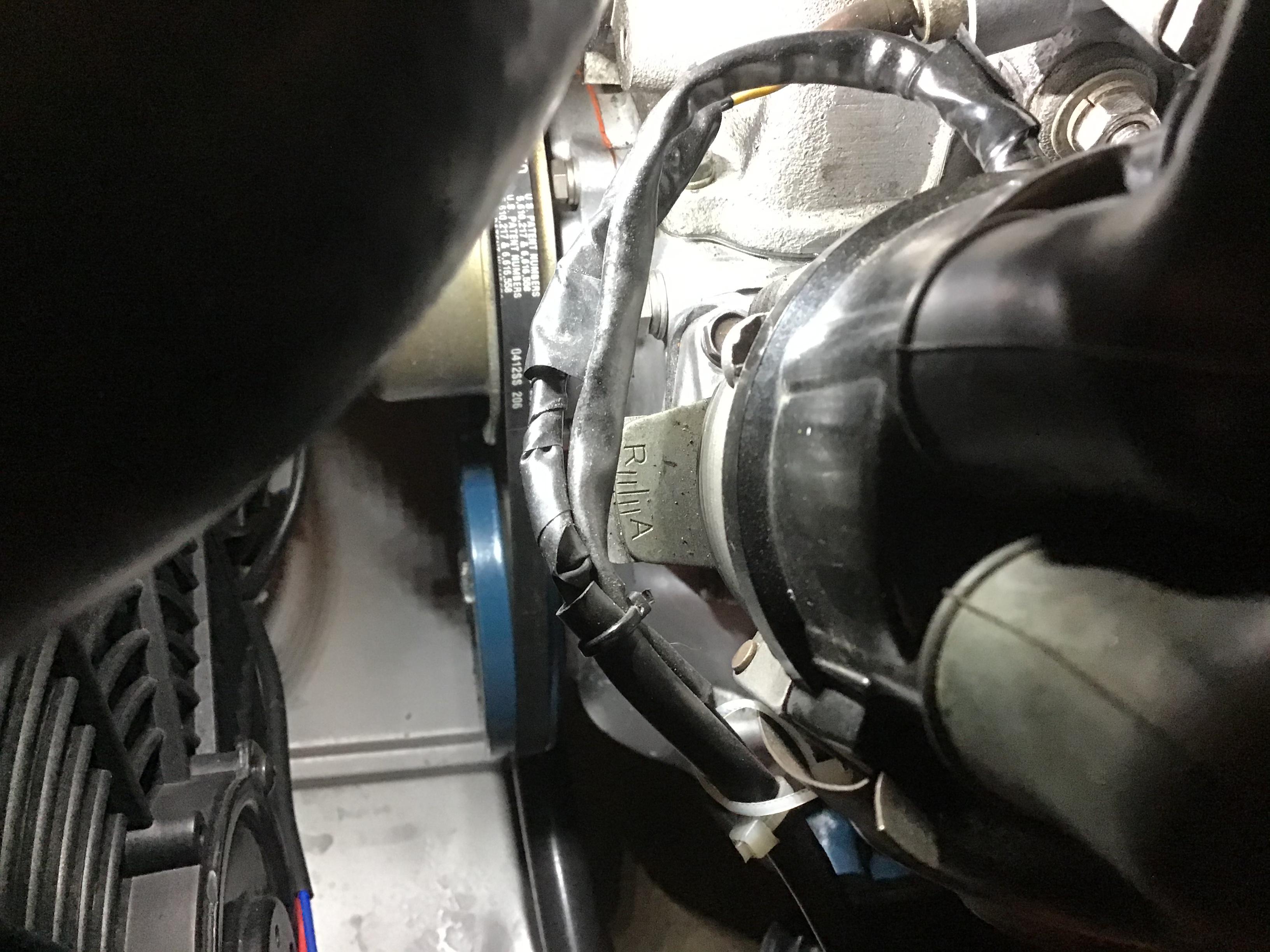

@Zed Head not really bad photo the alignment Mark is almost on the zero mark but the timing light says 7degree. Hope to spend some time at the dyno this spring. Last year I was running lean and we adjusted the carbs by feel. Time to do it again. Madkaw rebuilt my e31 head with bigger exhaust valves.
