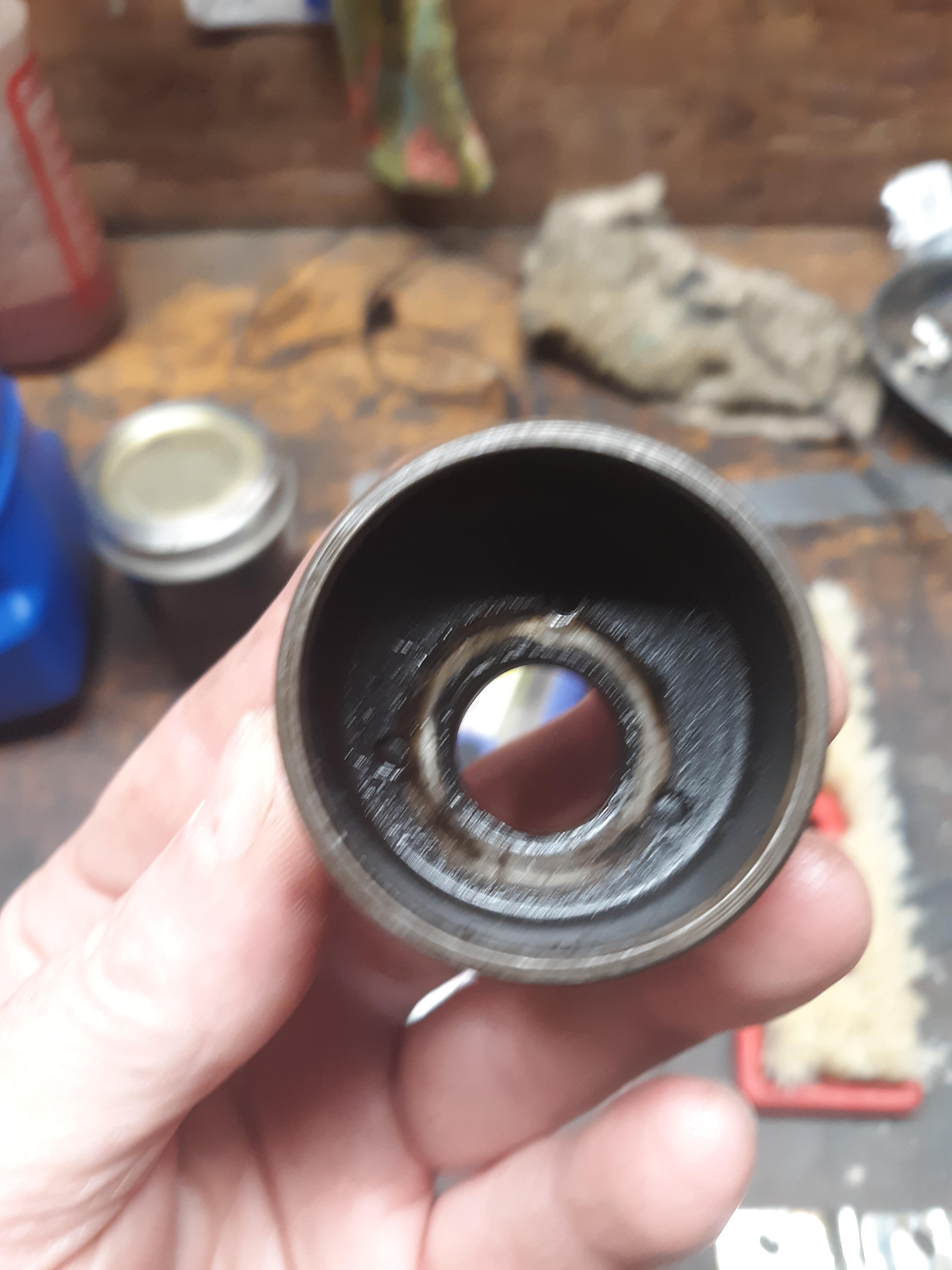

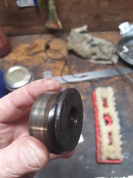

Is the eccentric collar on right and still has the backing plate on? I think that's what it's called, the fuel pump's arm rides on it and moves in and out. The cam sprocket first then this thing. Tightn the holly hell out of that bolt too. Don't remember the ft. lbs. number right off but it's way up there.
The pump eccentric is fine.   As I mentioned, when I pull the non working pumps, they don’t pump when operated by hand.
