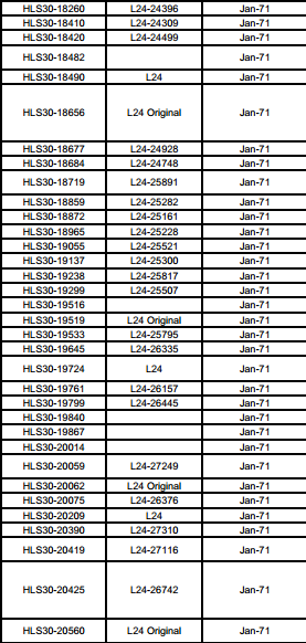

Ok, thanks for the input. Does Nissan have  a data base that would have a history of chassis #'s made and corresponding engines #'s?
Nope. You can look at other cars to see what vin numbers have what number engines but that will only get you close. You still won't be able to definitively determine if you have the original engine
www.zhome.com - click "Z Car Registers" in the column menu, then "The Classic 240 Z Owners Register".  This will bring up a long list of owners / chassis numbers / and engine numbers.  Find the chassis number closest to yours and compare the engine numbers with yours.  If the engine number range is close to your car, your engine is original.  If it's way off, then your's has been replaced.  You can buy blank ID plates from a number of places including https://www.zzxdatsun.com/
