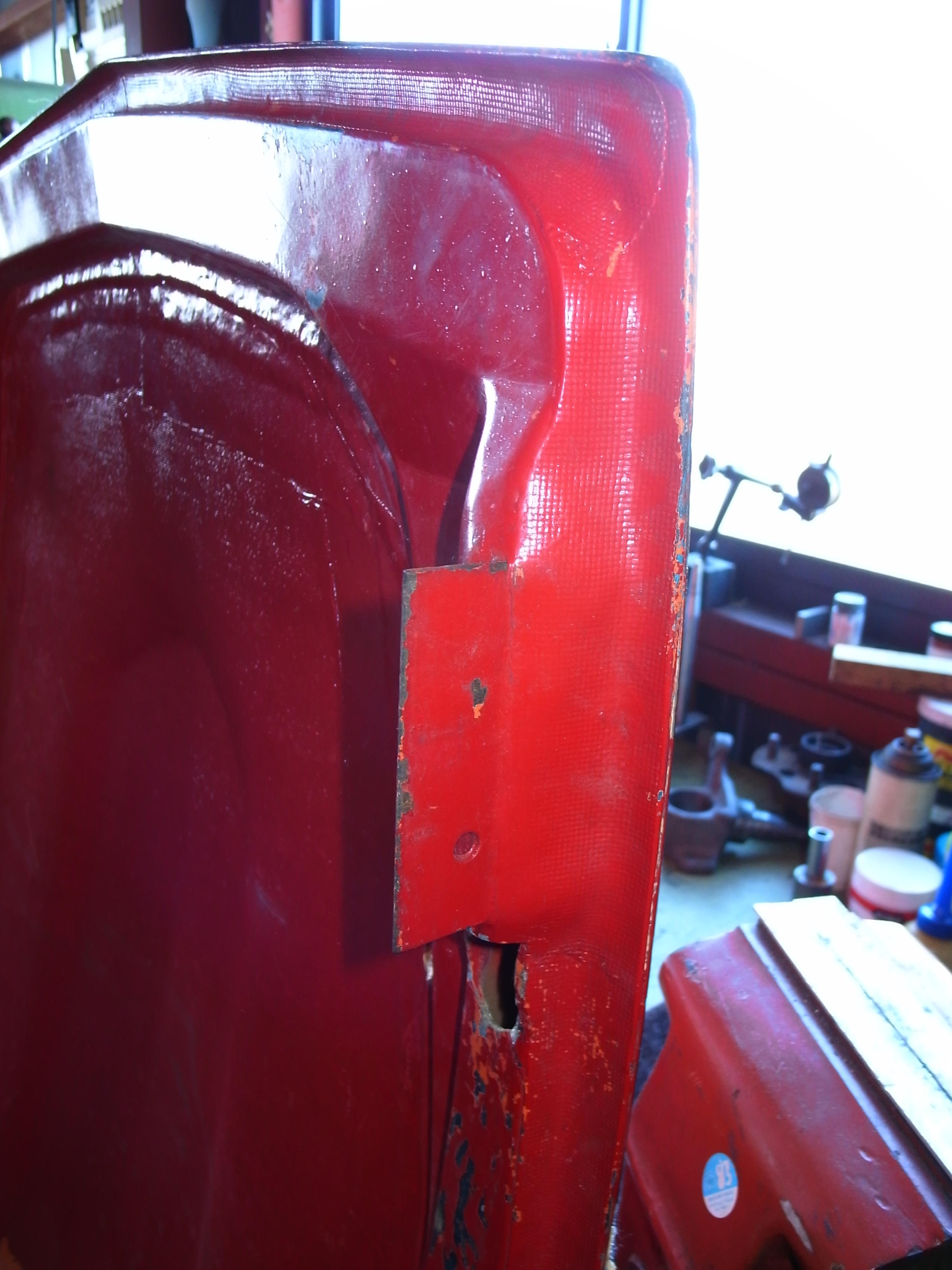

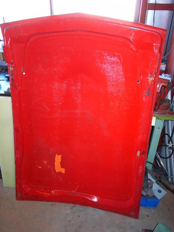

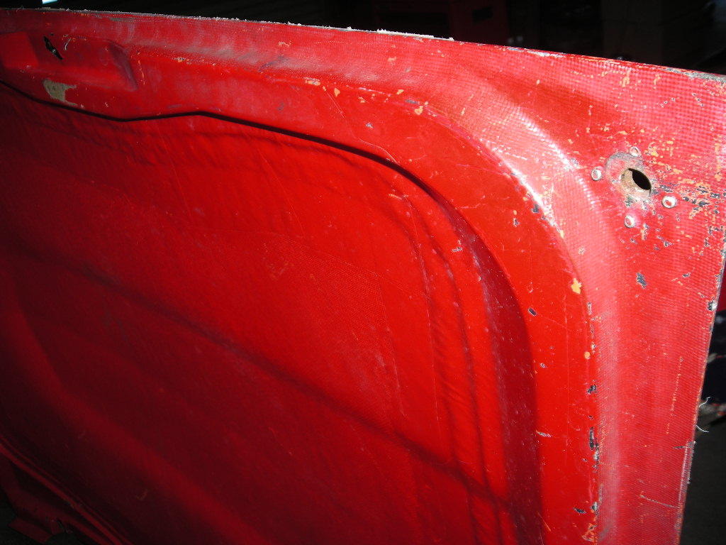

I'll dig out some reference photos. Here's one to start. Hinge bracket area on a factory FRP bonnet. Note the characteristic woven 'cloth' roving and steel bracket bonded into it:

Notice the difference of the edge between Hoover's hood with a turned in lip, and the FRP hood with its thickened edge.
