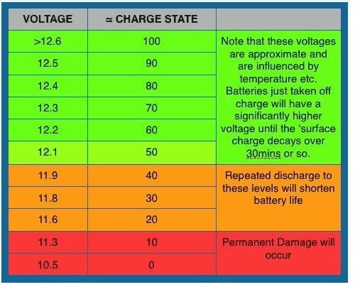

Back on topic, I was quite surprised to find that what I considered very small variations in standing voltage at room temperature show a dramatic difference in the state of charge / the health of the battery. The AGM battery used in my Audi with stop/start, I always felt was no longer at it’s best and you can watch the voltage drop quite quickly as you stop at the lights - yet it does start the car on the coldest of winter days. With the engine off she holds 12.3-12.2v, which to me says for the stop/star to work as intended, she needs replacing- see chart below.
So my advice is disconnect the battery, check voltage when not cold or hot as well as checking the calibration of your gauge.
My Z gauge shows a standing voltage of 12.5ish - but then again the battery is two years old, is disconnected ( using the battery isolator) every time the car is not in use and lives in a heated garage.
