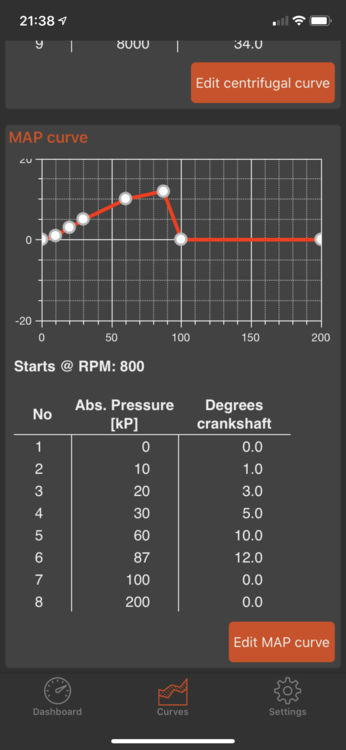

AK260 could you please post your MAP curve that you are using. Thanks
I’ve been very occupied with playing with the mix and custom timing at specific revs to reduce the two giant torque holes I get at around 2.2k and 3.5k rpms. So I haven’t had a chance to get the vacuum gauge out to properly set up the vac advance. I don’t fully trust the dials on the app as their rates of responsiveness isn’t consistent - I suspect the Bluetooth connection has a lot to do with it.
For that reason I don’t have a map curve I’m happy sharing but at the moment I’m playing safe and only really adding proper advance at motorway / cruising vac. This is nowhere near optimised yet ....
Oh and for giggles, here’s the curve my engine is happiest with, she really doesn’t like too much timing too early ...
This makes the torque holes feel more like flat spots.
