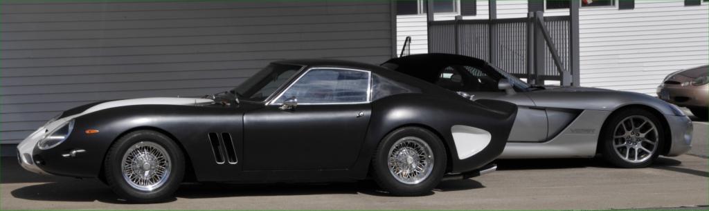

Well, I like the cars! not that it matters...[emoji1787]
To be honest, while the Viper screams like a rapped ape and is very reliable, in many ways I prefer the Z....or what the Z will finally be when completed.

I understand. They are different tools for different jobs

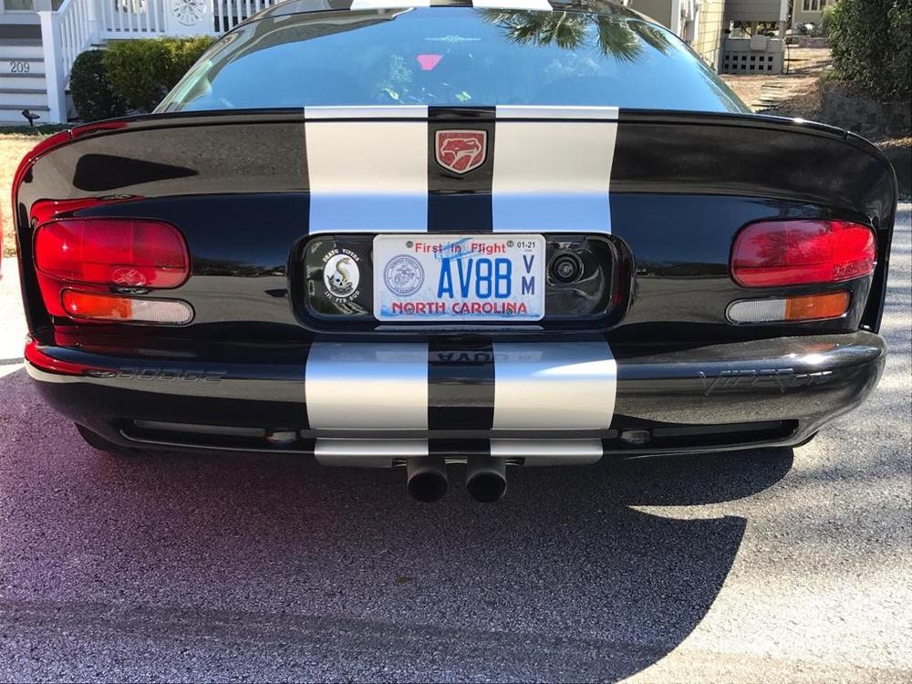

Ha! My wife is way too smart to fall for that one. She get rid of all my cars if she could and put me in 99 Honda Accord. I have a 2000 Viper that my father gave me right before he passed away. She hates to even look at it. Wants me to sell it immediately but since it’s a rare car 1 of 34, I’ve convinced her the car will be highly valuable later. She would set it on fire if she could. The Z is at another location so she doesn’t have to look at daily it but thinks it’s a piece of crap. She wouldn’t be seen in either car for any reason.

That is a STUNNING bit of kit!! You very lucky man. Have you explored the options for divorce!? You would have a very strong case. ;)
