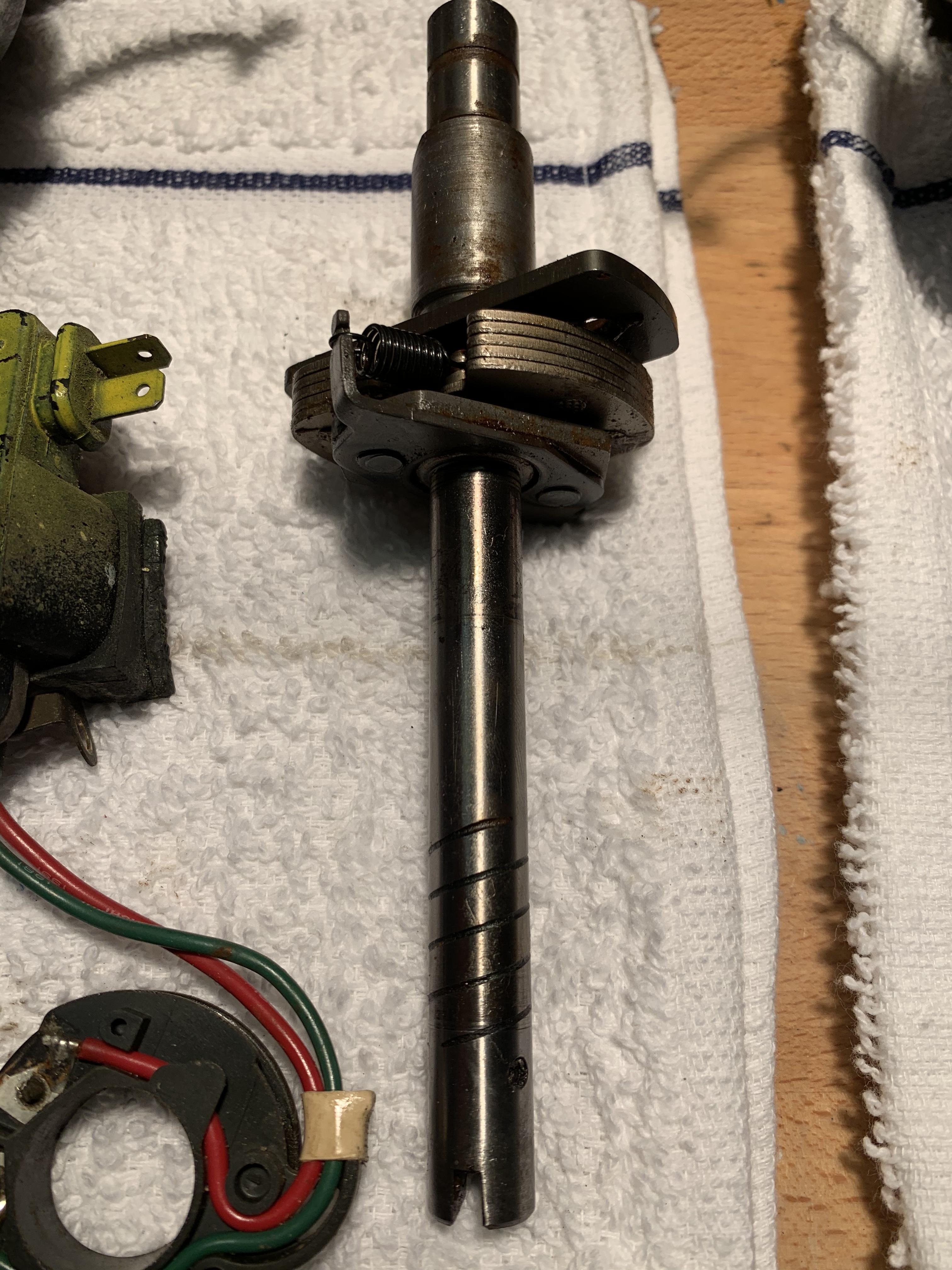

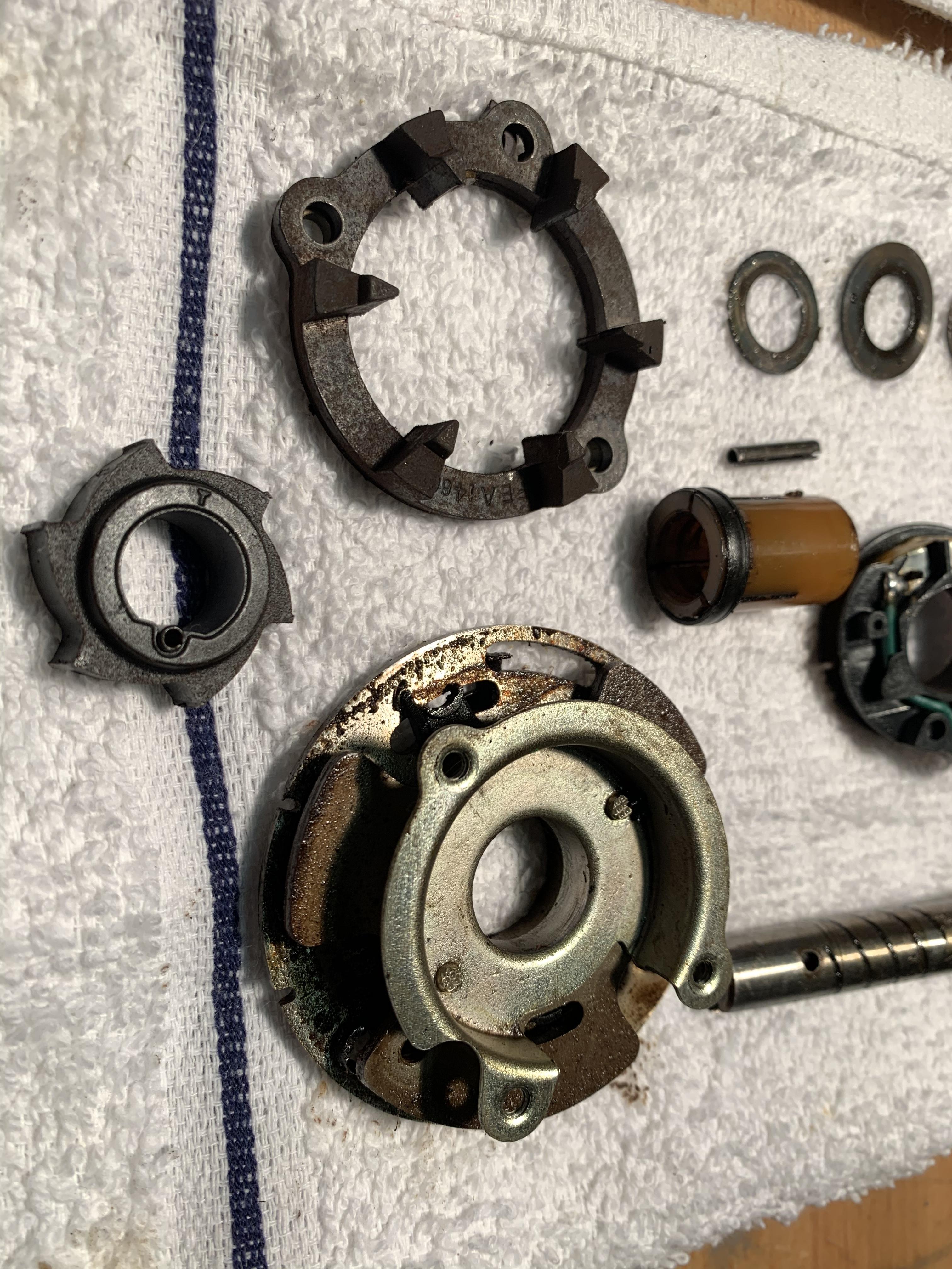

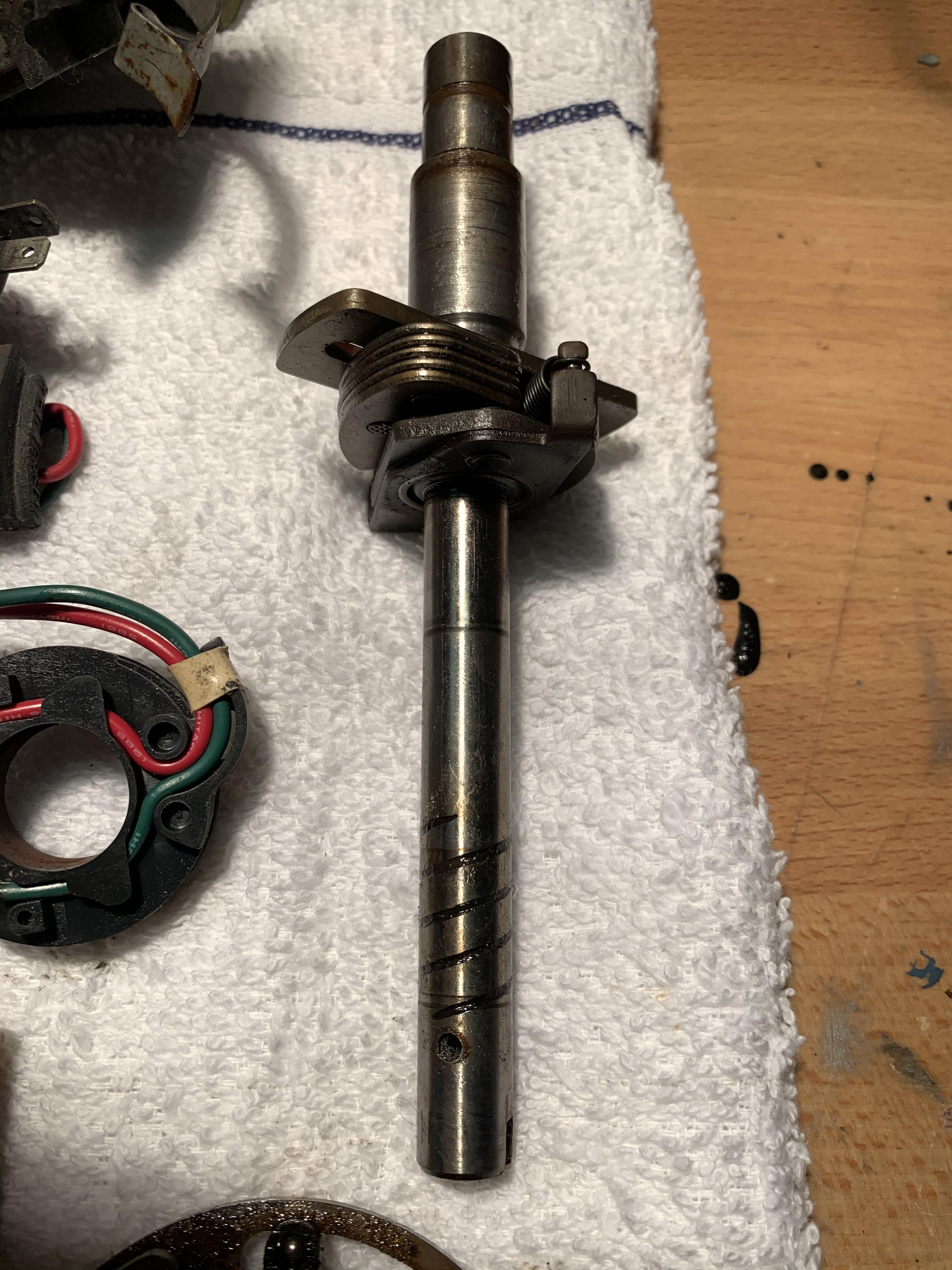

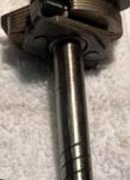

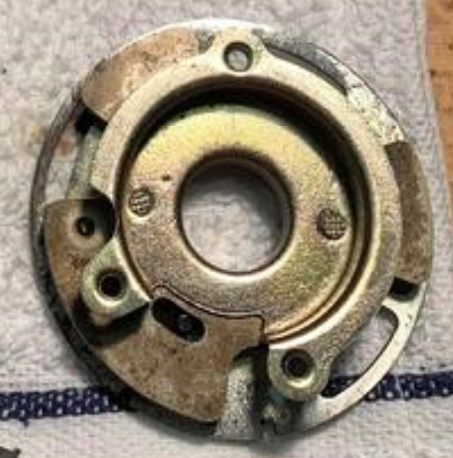

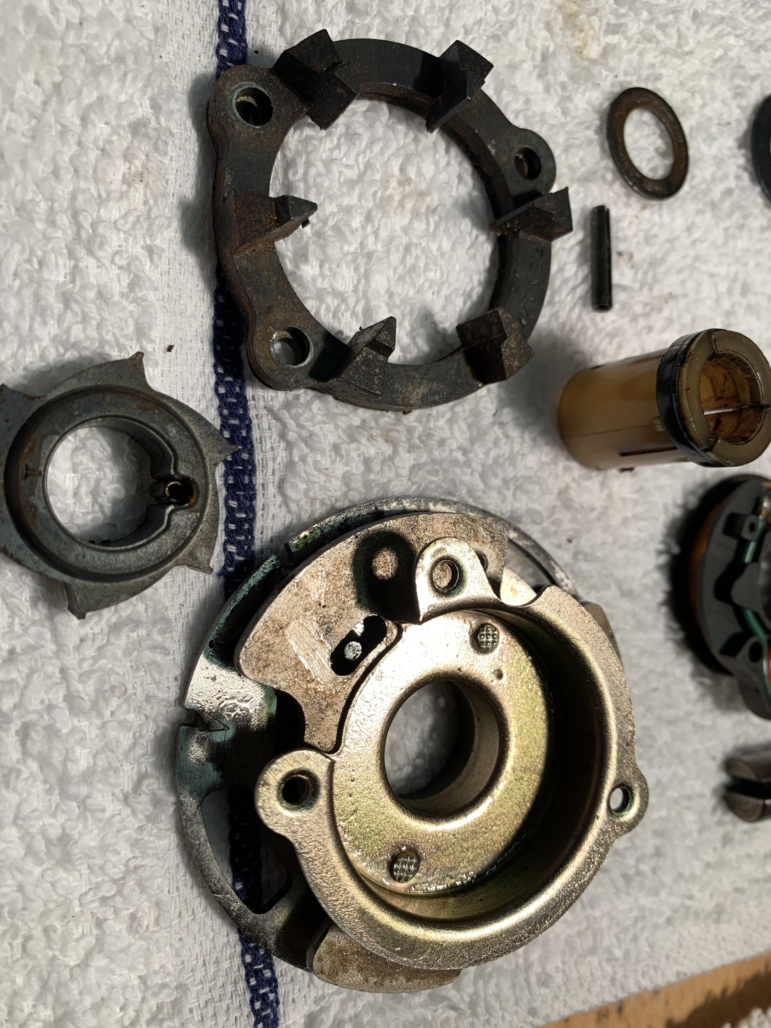

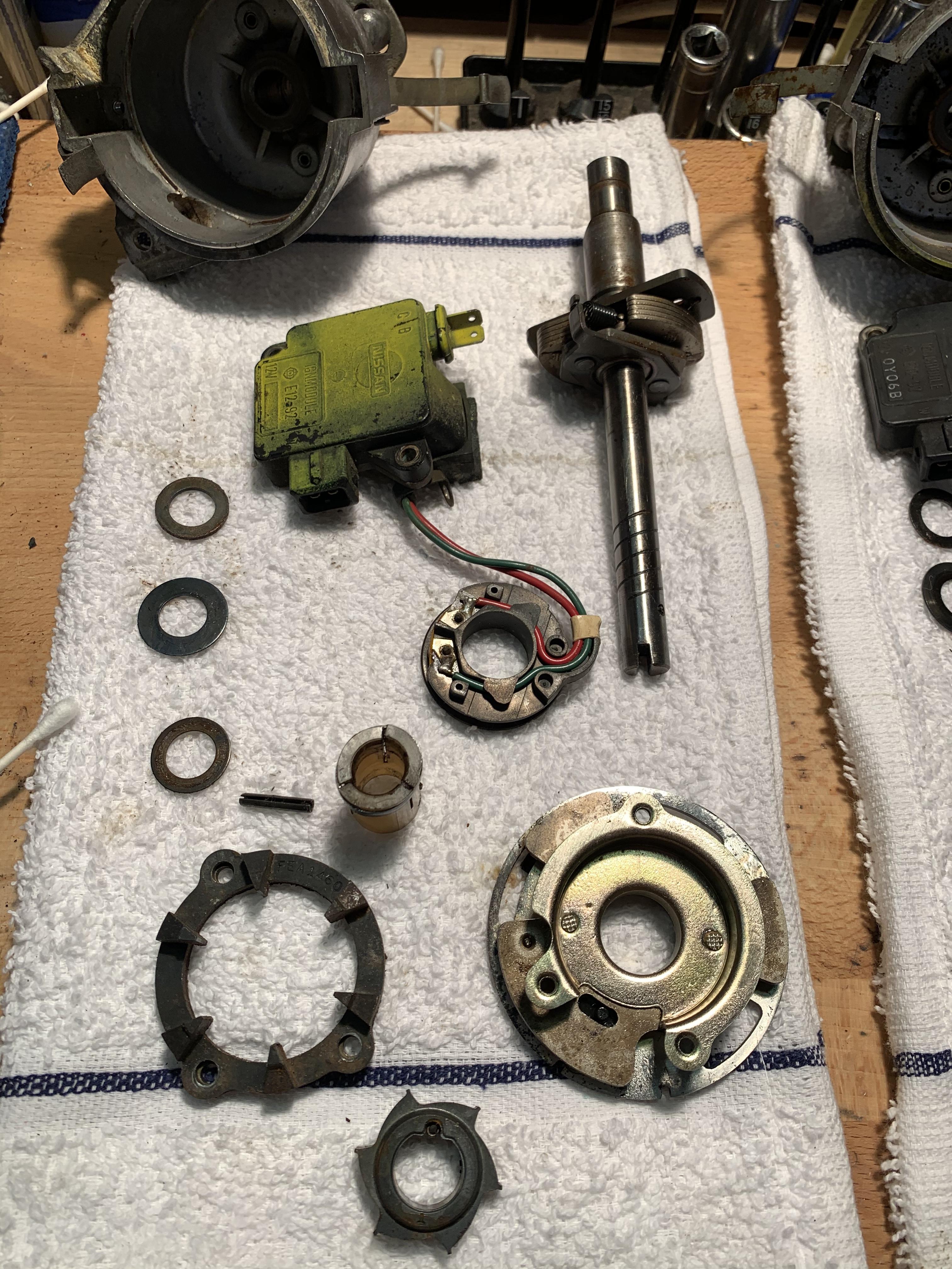

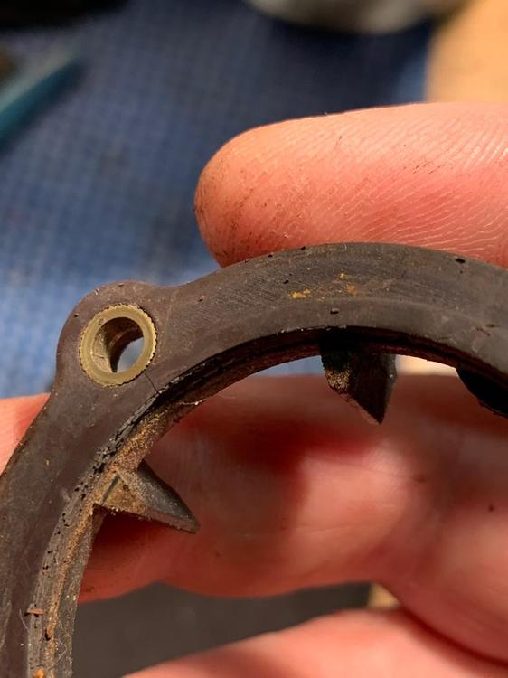

Since I don’t really know what you guys are talking about and I don’t have fancy tools like Captain Obvious I thought I’d post pics of my two distributors broken down.  I can see some parts are bad like the plastic tips and one of the breaker plates has a broken bearing holder.  The tips of the magnetic star and reluctor don’t look consistent either.   I think I can order some of these parts.
It doesn't loo terrible.  The most sensitive part is the breaker plate.  Have you tried to rotate the unbroken one yet?  Be careful.  You might have enough thee to make one good distirbutor.
And the magnetic ring is probably stuck to the bottom of the spiky ring.
I seem to recall that the metal bottom bushing from a 280Z distributor would replace the plastic ZX one.  Nissan just swapped materials.
Thanks, yes one of the magnets fell apart when I tried to pull it. It was already cracked. The other one is intact but I see one hairline crack. If I pull it she’ll brake. The breaker plate for one looks good. Had some rust on bearings that I’ve cleaned and lubricated so it probably good. I’ll see if I can order the base plastic thing and get a metal one. The shafts look good to me! 7f362bb15166e48cc9e5b6c995f8d485.jpg
