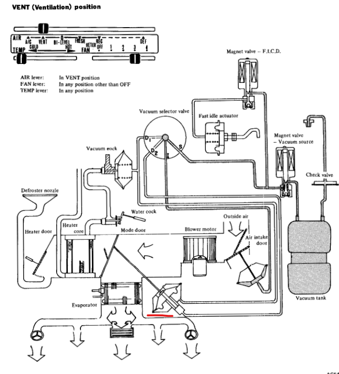

How are you testing for heat? Turning fan on and moving temperature selector to hot?
Note: the heated air is not designed to come out of the vents.
In order to get heat, the mode lever of the control unit needs to be in "Bi-Level",  "Heat" or "Defrost"
