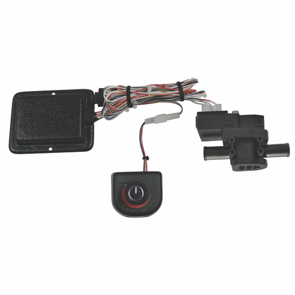

Vintage Air makes a generic powered heater control valve.  It can be controlled by any rotary or linear potentiometer (0-10 kohm IRRC) you care to use. $90USD.
50507-VUA - Servo Heater Valve Re-fit Kit with Control Knob and Pod
https://www.vintageair.com/instructions_pdf/50507-VUA.pdf

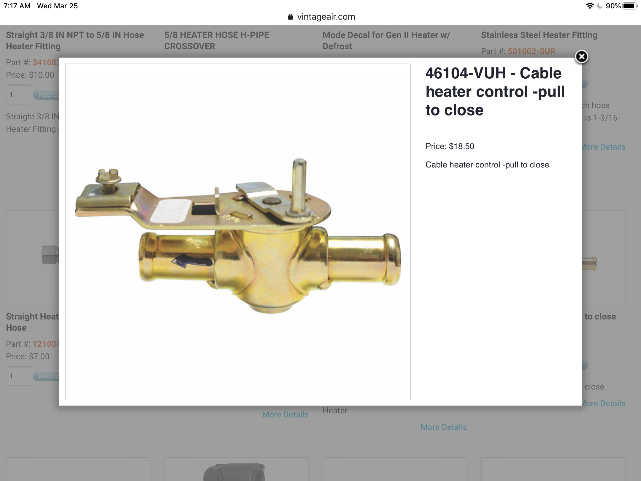

They also sell generic cable operated heater control valves.
