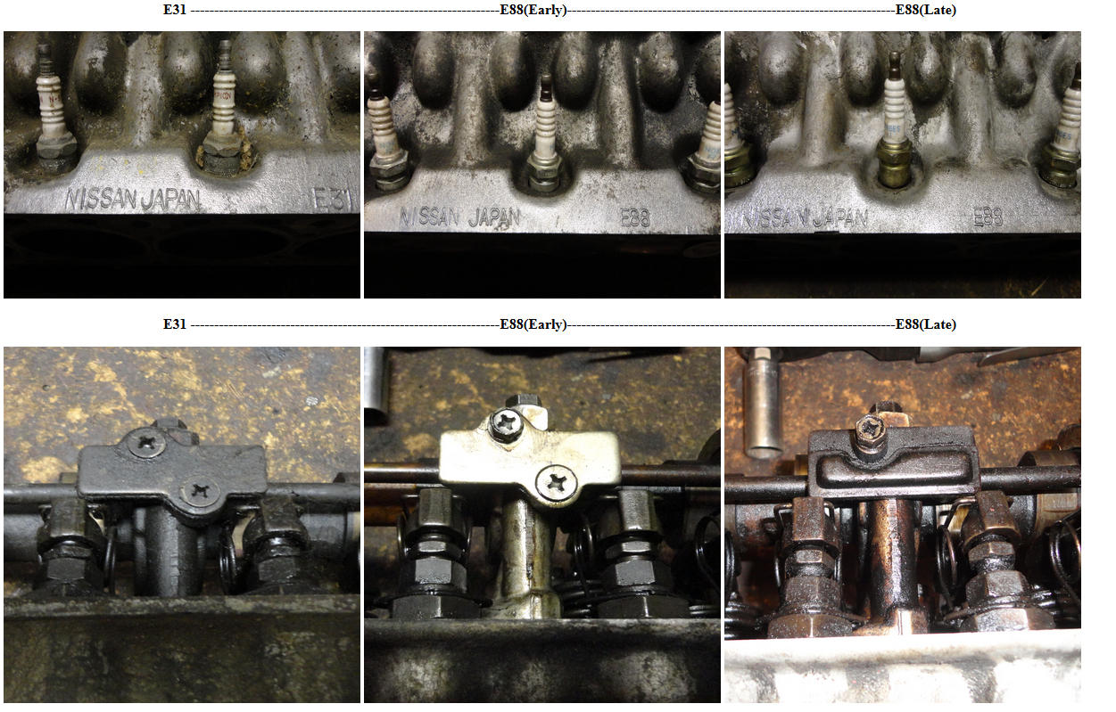

I don't know a lot about the fine details, but the E31 was used on the early E31 L24 block upto around Oct/Nov 1970.
Your 240Z should have a P30 L24 block with an E88 head.
The N42 was on the early L28 in the 280Z leaded fuel version. They changed to the N47 when unleaded was introduced.

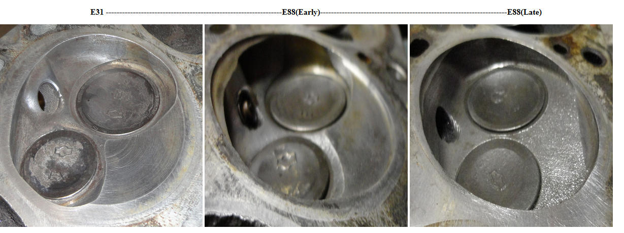

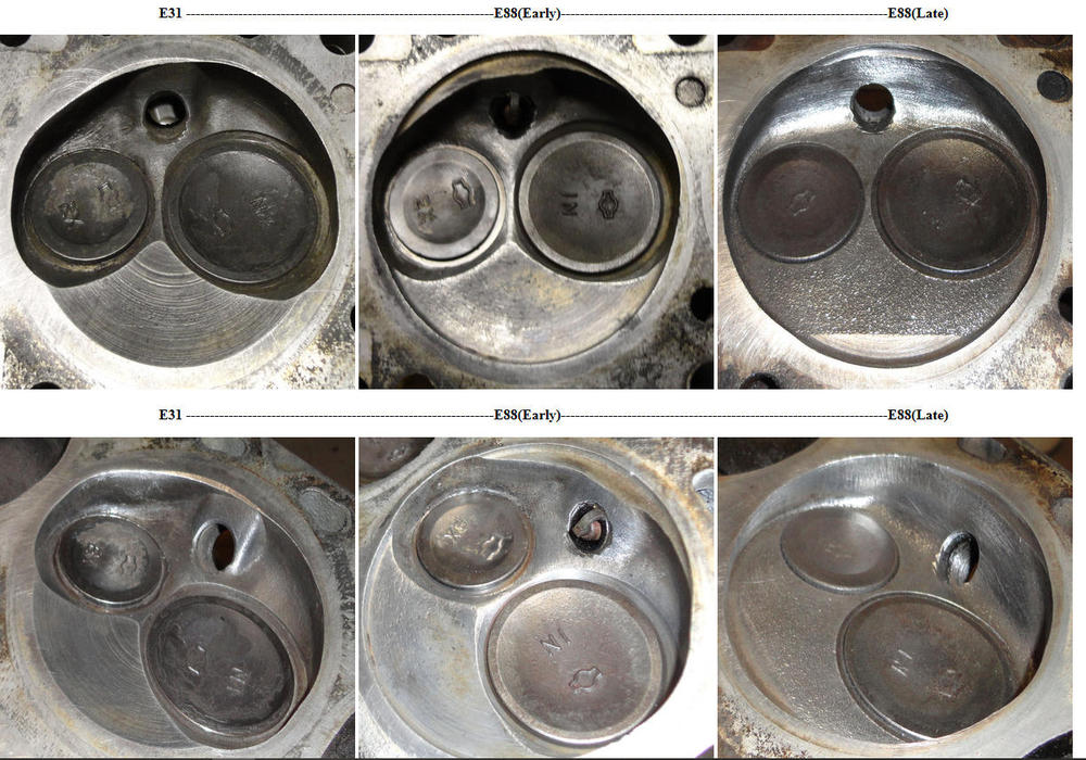

I know the early E88 had the same chambers as the E31 until somewhere around Aug 71 I believe. Not sure where that lines up with the Vin numbers. The later E88 heads had larger chambers and the E88 on the L26 got the bigger 35mm exhaust valve and the less desired emmision chambers.
The valves in the E31/E88 were 42mm inlet and 33mm exhaust. The N42 has 44mm and 35mm.
Chambers on the E31 and early E88 smaller than the N42.

The chambers in the E31 and N42 are very similar. The N42 does have a little more capacity which will lower your compression ratio a little.
Depending on head gasket thickness and overbore you would expect roughly the following compression ratio.
E31 = 42.4cc chambers  C/R 9.0:1
N42 = 44.6cc chambers  C/R 8.5:1
