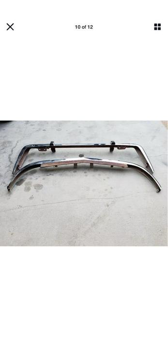

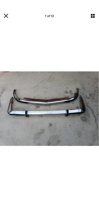

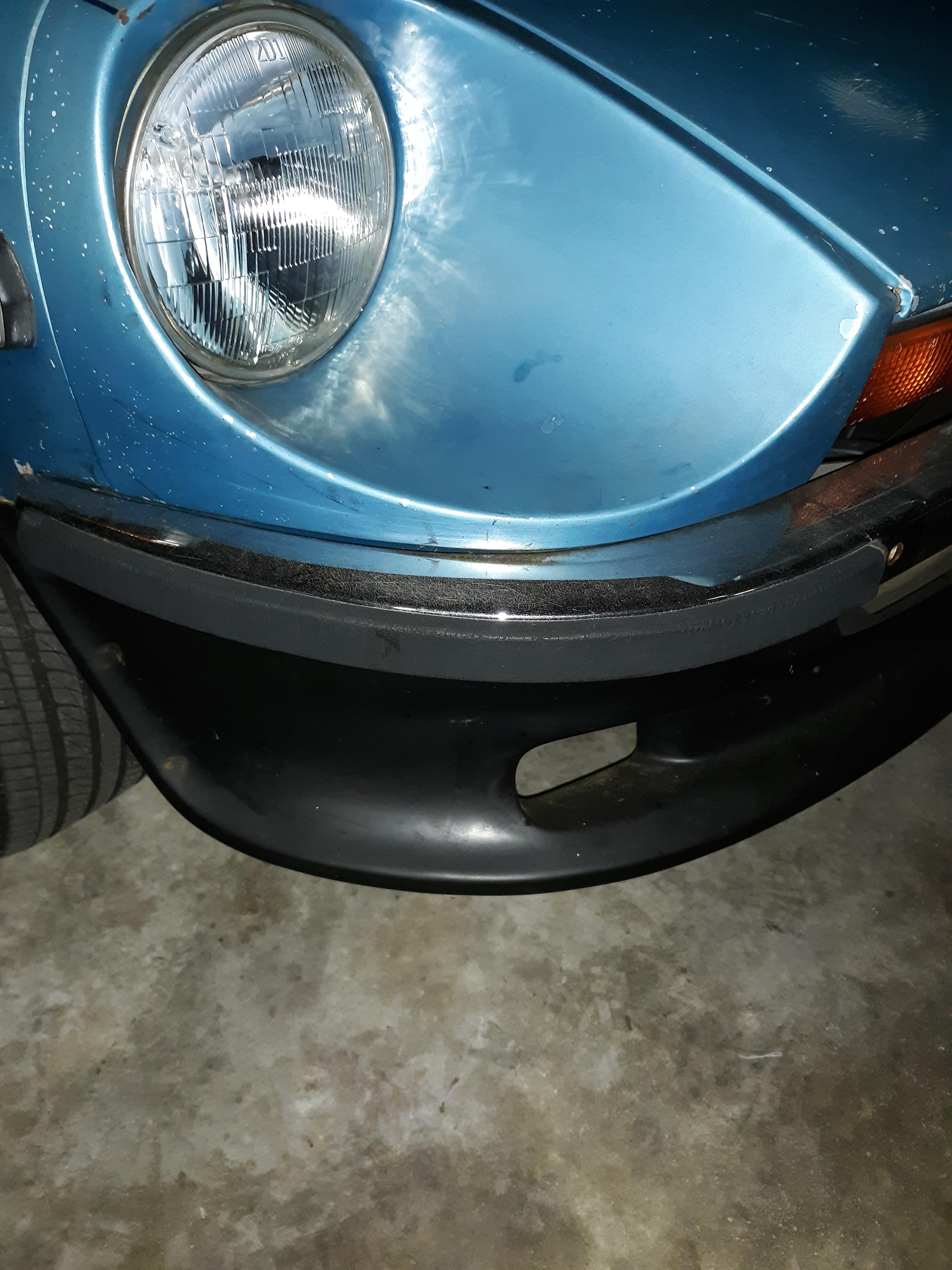

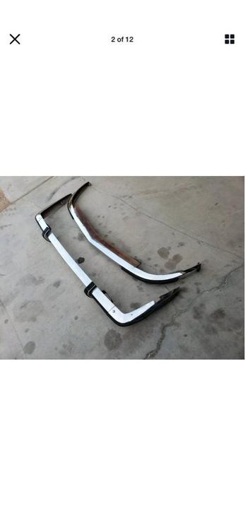

I recently purchased what I believe are a set of bumpers from a 1973 240z (eBay listing was unsure) and and am wanting to mount them on my 1977 280z. Pictures included below to help identify.
I’ve looked pretty much everywhere and can’t seem to find much information (or any conversion brackets) on how to make the swap. Has anyone here had any experience with doing this?
Should I buy the 70-72 bumper conversion brackets and try to modify them or try to find the OEM brackets and modify those instead?

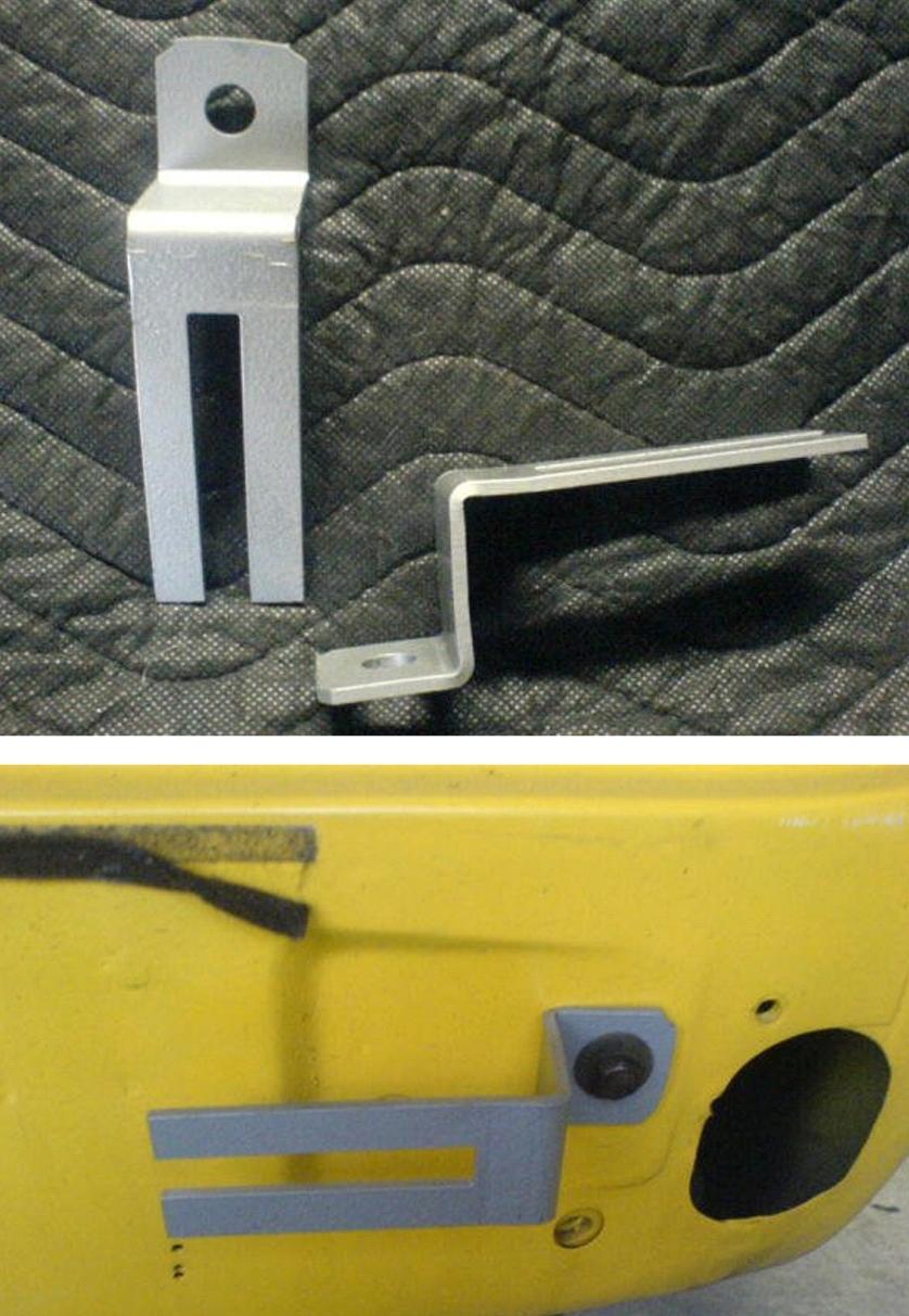

I started this adventure in 2015 to convert my 280Z. Back then there was only one bracket kit available, but it was IMO poorly designed that I decided to make my own. The back bracket was a simple bracket with a slot and one hole. The set with shipping, import duties and GST set me back €232.00default_facepalm - Copy.gif Things have changed since then and the brackets now available have improved considerably.Screenshot_20200329-120349.jpg
I had the good fortune of lending a, all be it sadly abused looking, 71 bumper to take measurements and some kind members on this forum to give me measuremnts of there bumpers to compare. It is not an exact science. The variance between bumpers and between the 280Z's I measured was a lot more than I expected. I made the slots in the brackets to accommadate the variances I noted, but they will not have enough adjustment to bridge the gap for the 73 bumper.
I can fab a set of brackets that will fit, but I need info from JingK. Pending....
