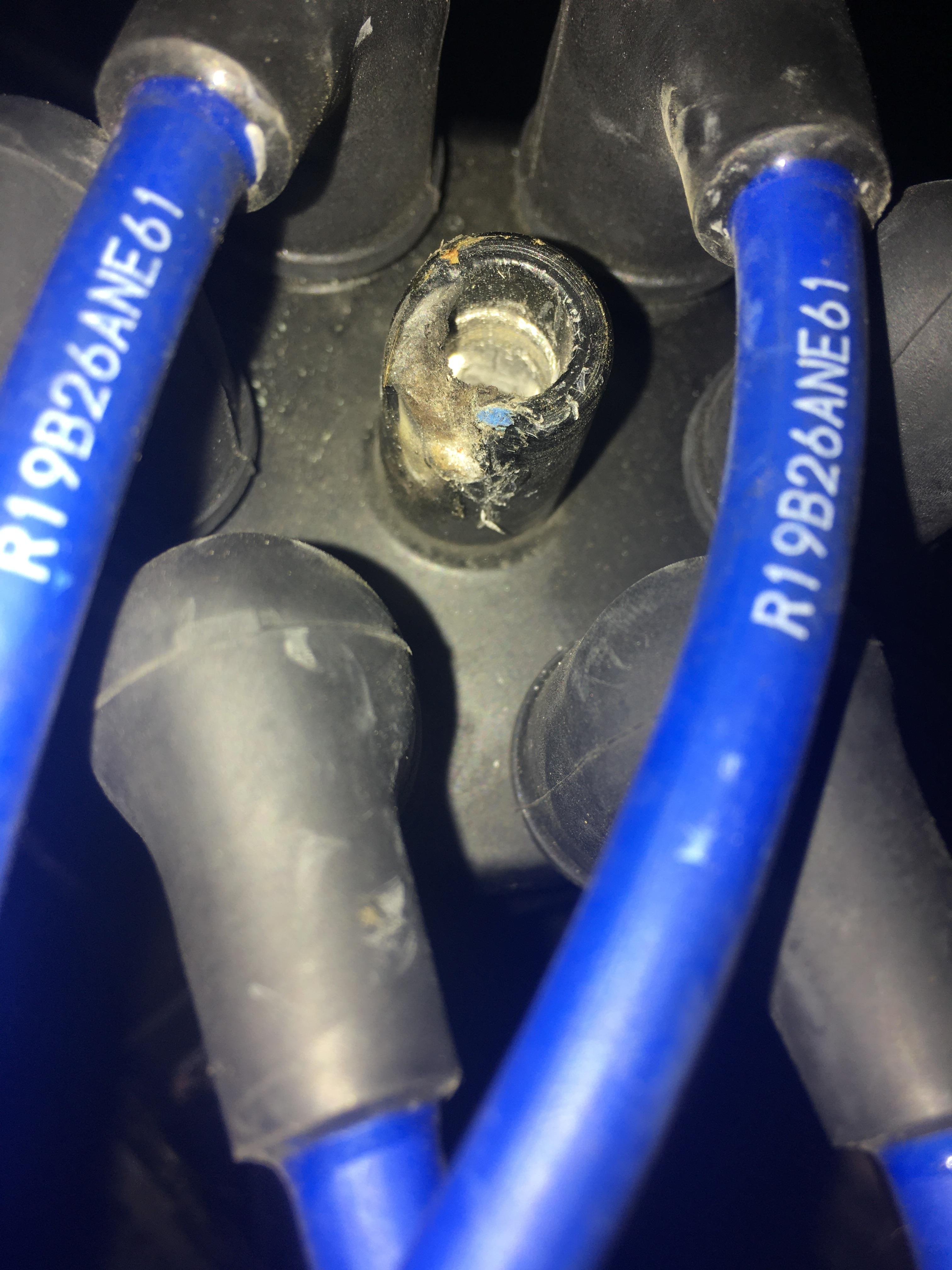

My distributor cap's center connector rubber bit seems to be melting courtesy of the HT wire from my spark coil.  Is this commonplace, or is there something going wrong here?  The car runs perfectly fine and only noticed this by chance...

I would say a bad connection or corrosion is causing heat which is melting the cap
+1 for this reasoning.
I also once found that happen when the boot and connector were not fully pushed home and it was arcing onto the cap/collecting moisture causing corrosion and resistance.
To elaborate on what @Patconsaid, if you don't have  the coil wire firmly seated against the contact in the distributor cap, you WILL have arcing between the wire and cap. This arcing will heat up a destroy the center post on the cap.

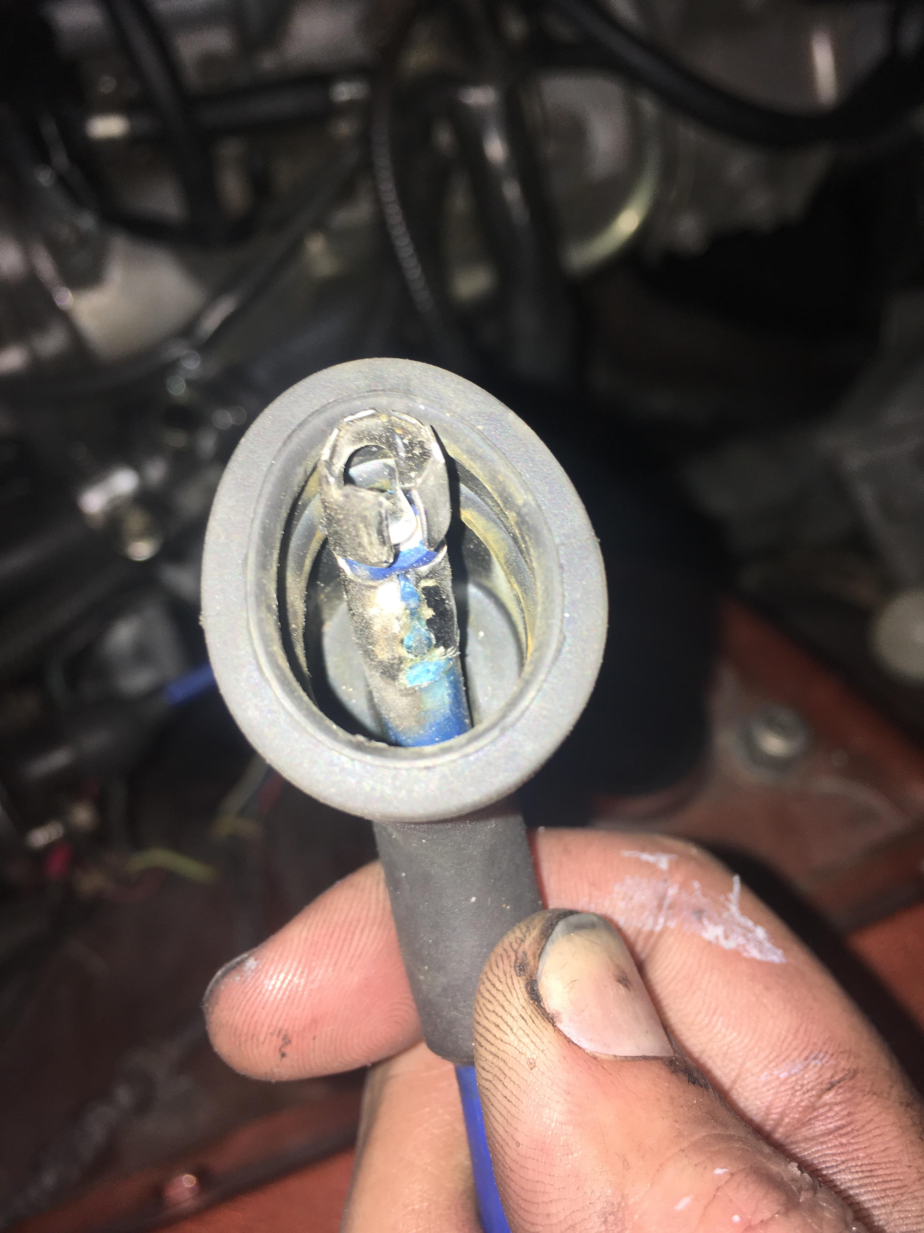

I just checked and the majority of the terminals in the cap have at least some form of mild corrosion going on (but no melted terminals).  The cap and wires are only about 6 months old - why are they corroding so quickly?

Your cap probably has aluminum terminals, and you wires probably have some kind of plated steel terminals. Two dissimilar metals will eventually corrode due to electrolysis. The anti-ox will work, just don't use too much. (Better dizzy caps and wires will have brass-like terminals and not corrode as fast).

You've probably hit the nail on the head - the terminals definitely aren't brass.  I'll put some of that goop in there and hopefully that will be the end of that.
