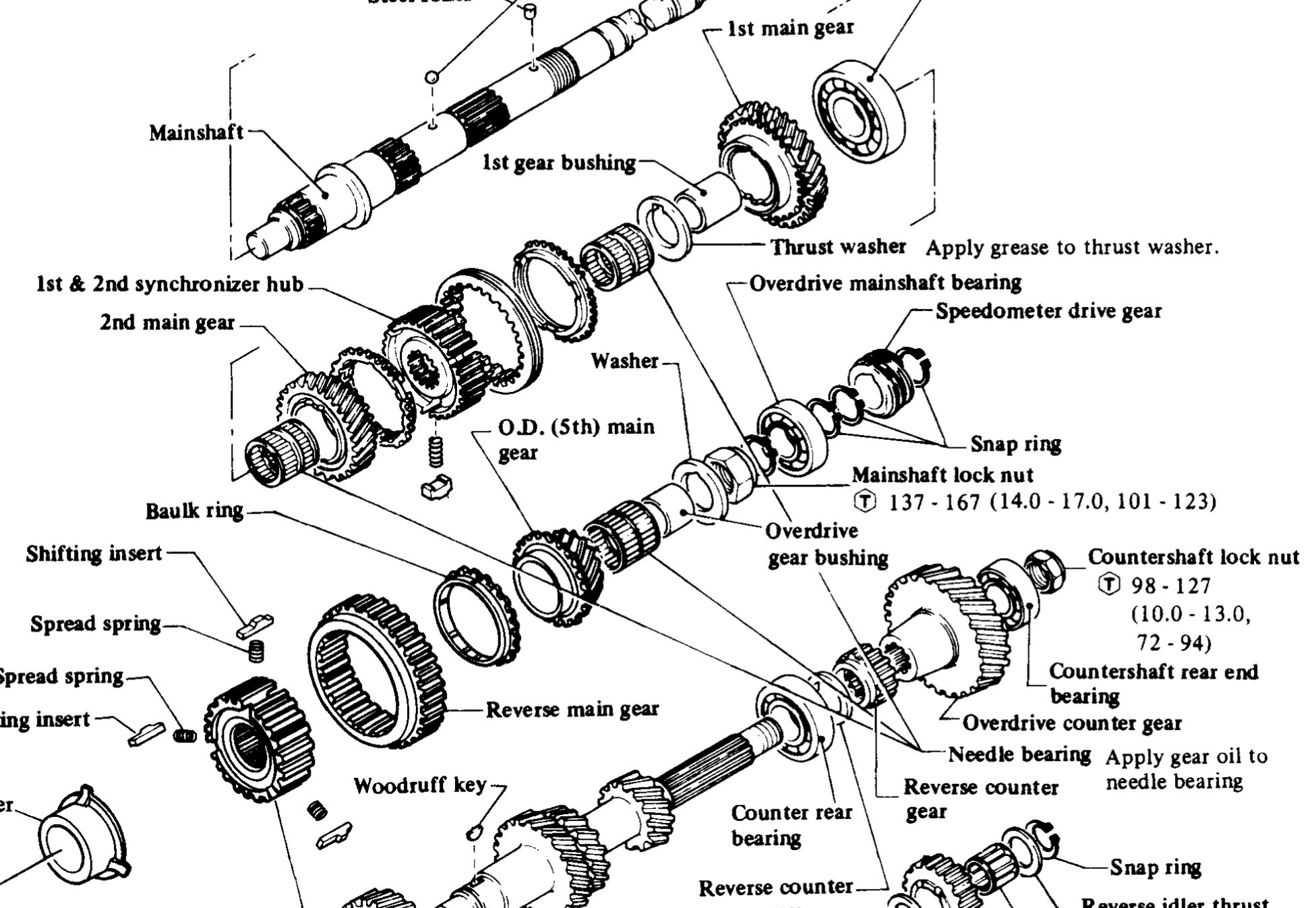

IIRC that endplay would be decided by the roller race under that bearing. Did you change any bearing parts or gear? I am pretty sure you dont want that to be loosely tightened.
I reused the old "overdrive gear bushing" but used new needle bearings in between. If the old one was "too short" in length, it could cause this issue right?

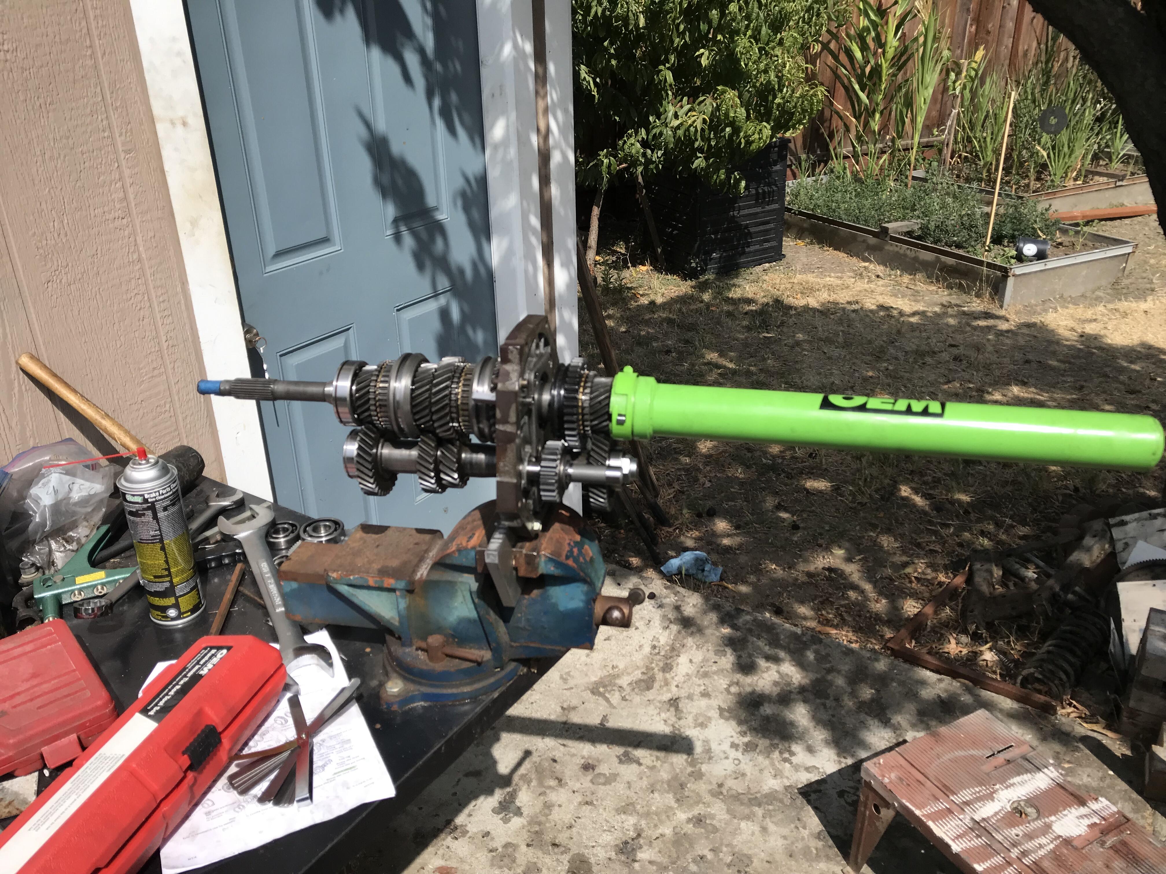

@EuroDat I torqued the main nut to 110ft-lbs the clearance is around 0.25mm on the 5th gear. That’s 0.05 tighter than OEM spec.
oh so its not locked, that's good. could be a tolerance stacking up issue with the new bearing. If it was me I would mic out the old bearing and compare to the new, maybe even just reinstall and check again to see if old bearing gives you clearance per spec. If so and new bearing is indeed larger (unlikely but if) then i suppose you could get a flat stone and carefully sand down the washer. better to mill it but that may not be practical. I know I had a hard time finding that inner race, i had to  order from japan, I did not like the idea of a new bearing on an old race.
Edited by Dave WM
0.25 is OK. You will not have any problems with that clearance if you use a good quality oil like MT-90.
dumb on my part about thinning the washer that would do nothing...
I was at my desk this morning, and it looks like the older 1980 gearboxes have a tighter tolerance than the “close ratio” 81-83 boxes. I’m not sure what gearbox this is anymore, it had a  RHD main shaft, but a CR tail housing…. It’s a mix. I think I’m happy with the end play at the moment, everything seems to be in “spec”

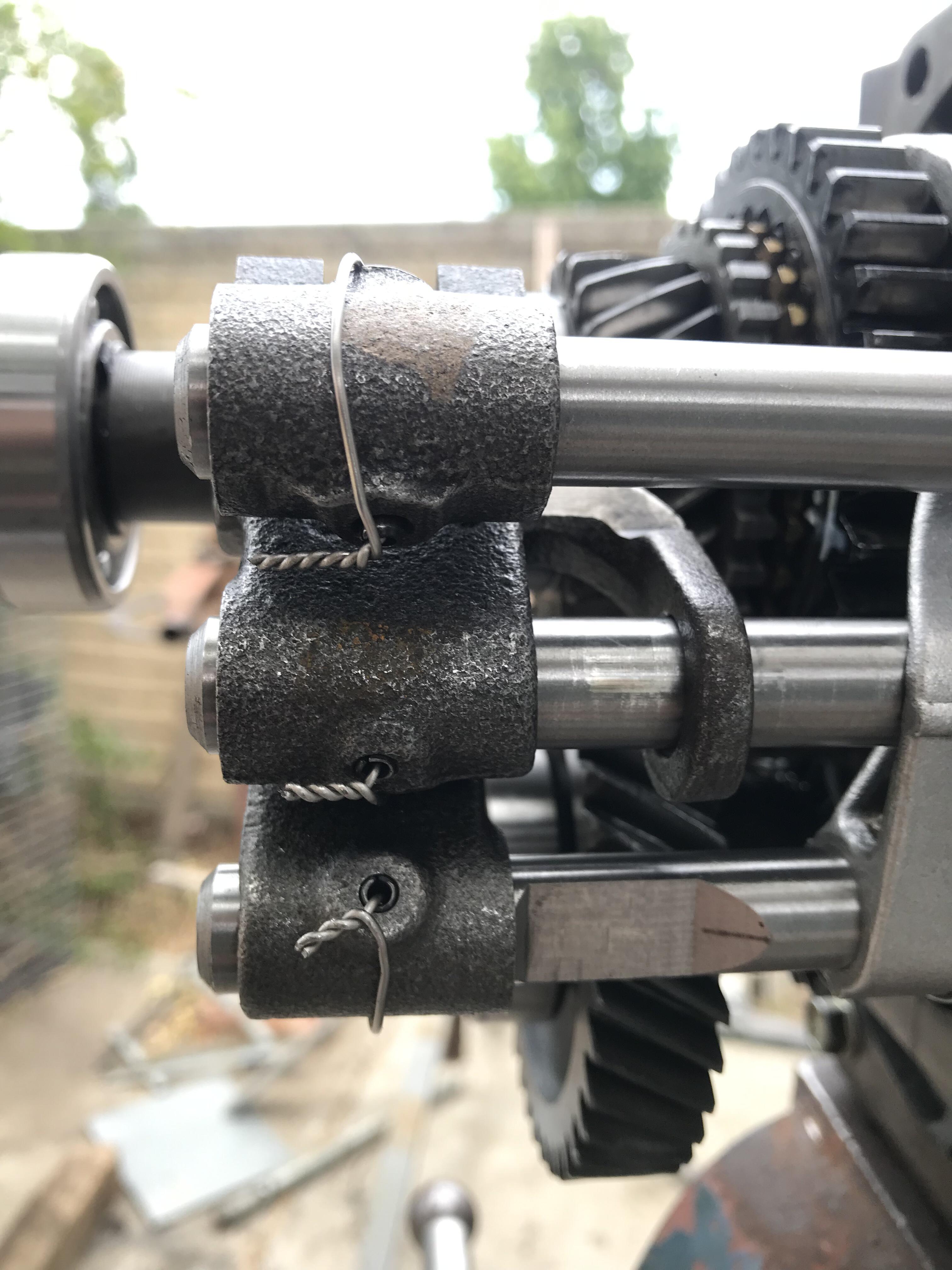

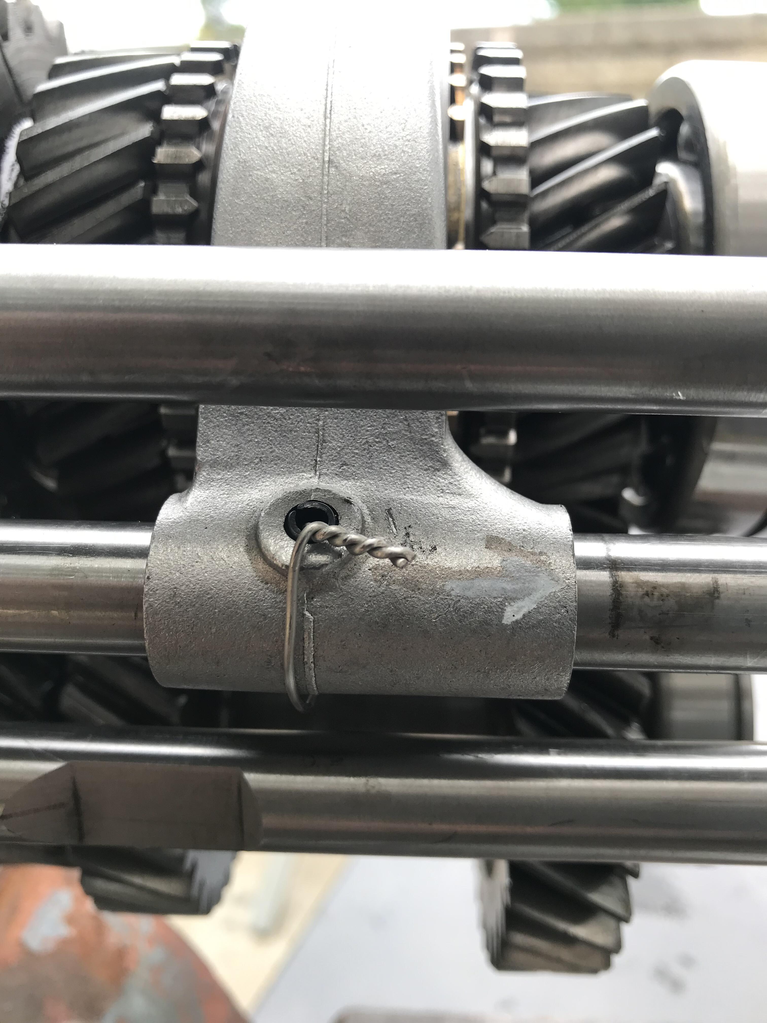

On a side note, I thought about safety wiring these roll pins, to avoid any “lost shifters” at the track. I don’t know how I feel about the “looseness” of the wire, and it wearing down the aluminum shifter forks…. Am I just thinking too much about it?

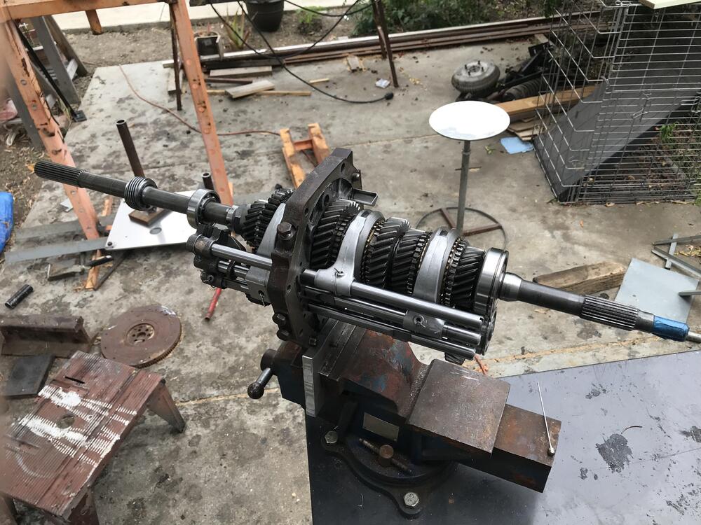

I’m not 100% on the shifter fork orientation for 1/2 gear. I saw an old photo that @Patcon posted and I think it’s right… no image in my phone or in the manual…
It looks pretty good, the housings are washed up. Hopefully I can get it buttoned up tonight, and installed tomorrow after work.
Pretty sure that I've read about doubling up on the roll pins.  Pin in a pin.
Turns out that you can buy them that way too.  Also, coiled spring pins.
https://www.jackstransmissions.com/my-cart/store-home/double-roll-pin
https://www.grainger.com/category/fasteners/pins/spring-pins
It's in the right way. It wont fit the other way. The other end where the selector rod passes through colides with 3rd and 4th when you fit the fork on backwards.
If you feel comfortable wiring the forks it shouldn't do any harm. I take it you want to wire them because you're worried they might fall out or work their way out. They shouln't fall out that easy.
I have only ever seen two 71B with them double pinned like @Zed Head said. One was for a rally car and the other was unknown.
