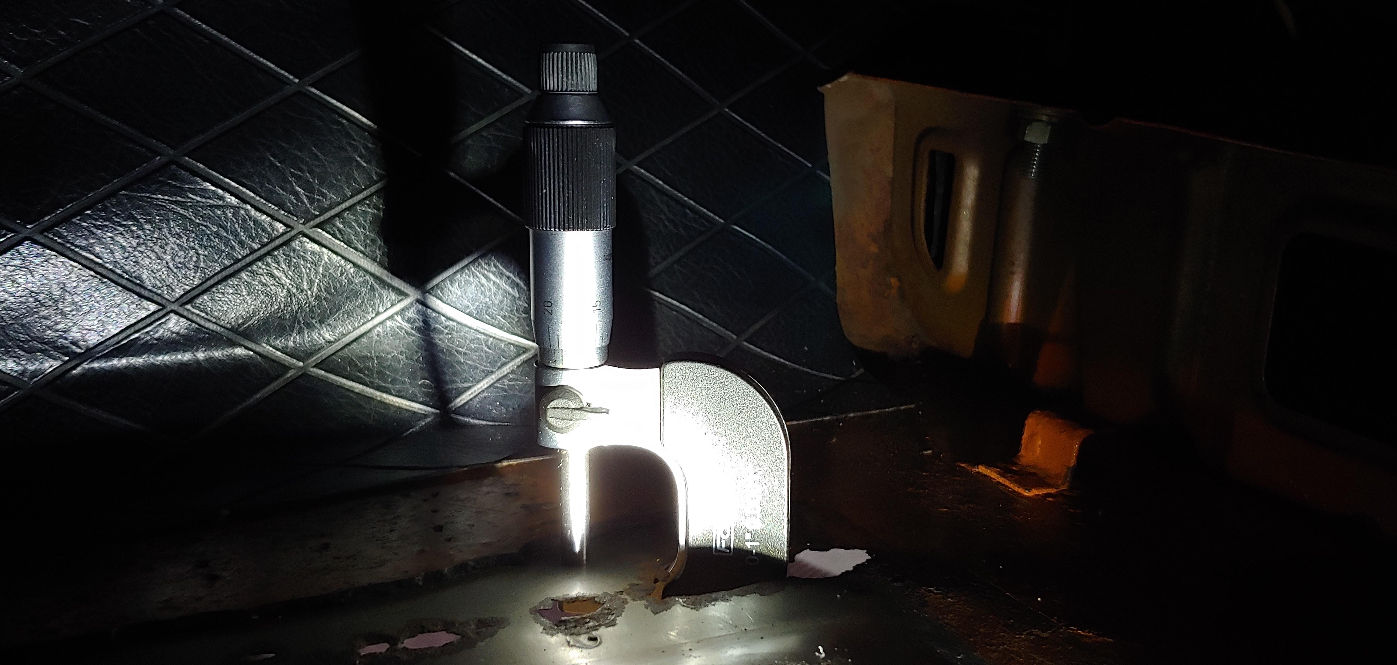

Couldn't get it with my vernier but a micrometer worked for the floor pan, to sound metal through a rust hole. The drain holes were not large enough. Measured .044" (1.12mm).

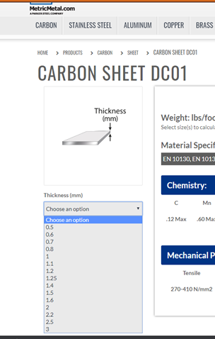

We'll probably never get a better measurement of the factory floor thickness than that.  Closer to 1.1mm than to 1.2mm, so let's call it 1.1mm then.  BTW, both 1.1mm and 1.2mm are, according to a modern supplier of rolled sheet steel (Parker Steel / MetricMetal.com), legitimate standard sheet thicknesses for bulk metric rolled sheet...

Unfortunately, this is one of those cases where the measured thickness doesn't align very well with American gauge standards...
  •  0.044" places the floor panel right at the lower (thinnest) boundary for 18-gauge.
  • Conversely, the upper (thickest) boundary for 20-gauge is just 0.0389".
So, we can consider the factory floor panels to be either thin-ish 18-gauge or way-out-of-spec 20-gauge.
We can also say that the floor panels are the same thickness/gauge as the main outer body panels (which, interesting to note, are commonly considered to be "20-gauge" but are, per my notes above, closer to 18-gauge than they are to 20).
In the end, 1.1mm is probably the correct representation.
Comments welcomed.
It looks like the top side of that sheet was uncoated (but rusty). Is the underside coated with anything? Paint? Tar?
I'm thinking that maybe between a rust hump on the top side and maybe some coating on the underside, you're measurement is a couple thousandths too thick. It would only take five thousandths less to make that a 1mm thick sheet. In the end, however, I don't think it matters... People will (should) use what they can get, and although I haven't checked, I suspect finding 1.0mm thick sheet isn't the easiest thing to do in these parts.

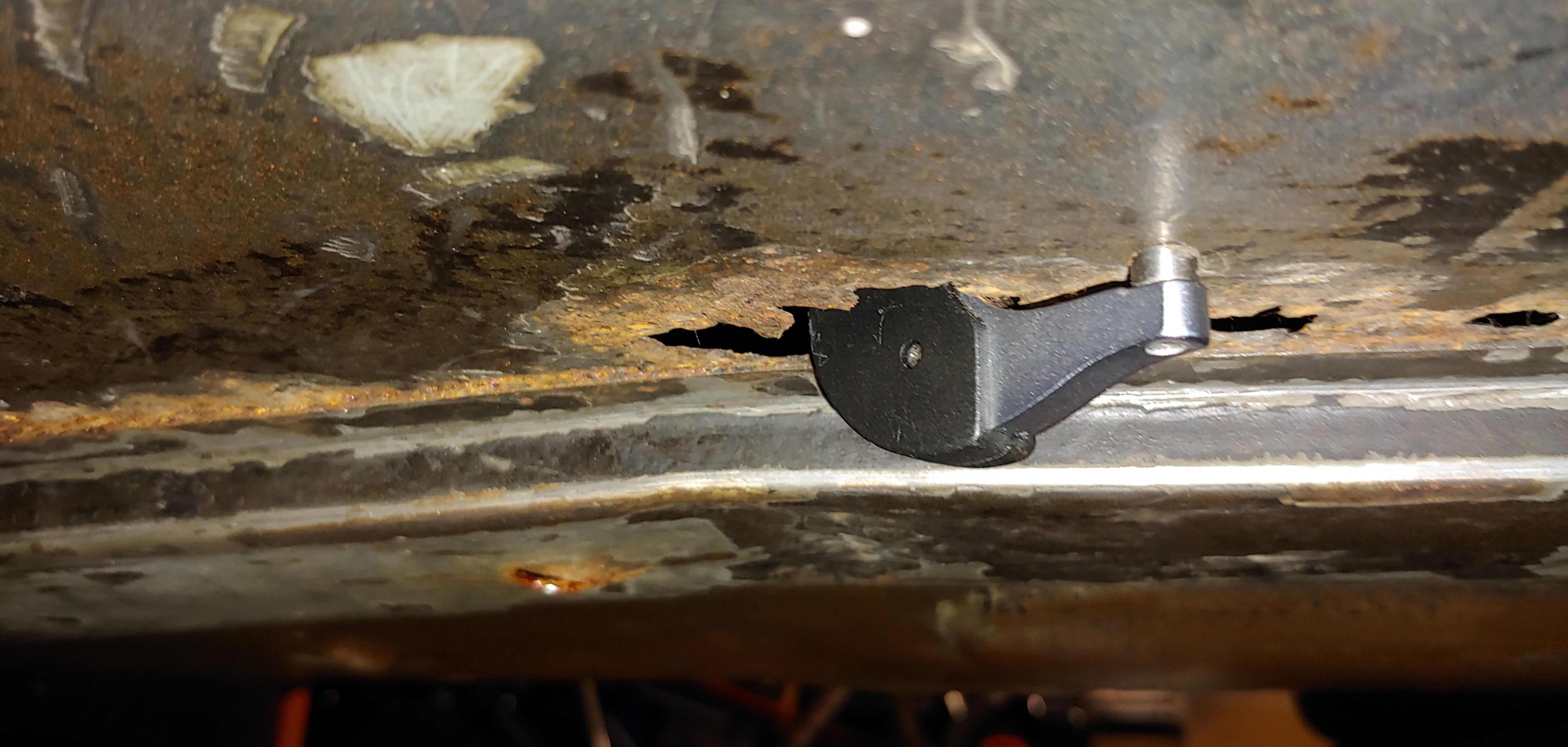

I did my best to take the measurement where it was clean bare metal on both sides. Here is a picture from the underside. No sanding has been done, just solvent cleaning after removal of undercoating and the tar mat inside.
