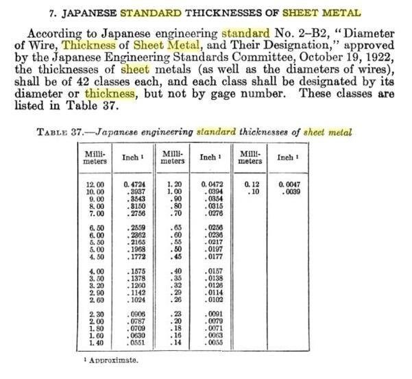

Here are a few references regarding Japanese cold finished sheet steel thicknesses and tolerances.
I like the second table, esp. the fact that the standard dates back to 1922 and therefore encompasses the period when the S30 was being built.  It indicates that the 1.1mm thickness offered by contemporary supplier Parker Steel (see my earlier entry in this thread) is not really relevant to the sheet used for the S30 body panels.  It looks, instead, like 1.2mm (0.0472") would be closer to the truth.
The JFE brochure provides some interesting insights into the cross-section of sheet steels available to modern-day automotive/manufacturing engineers for body pressings.  With techniques like hydroforming and materials like high-strength and ultra-high-strength now available, things are a lot different than they were back in 1969.
Yes, I was also happy to find that table with available standard thicknesses from the period. With enough volume and modern methods manufacturers today definitely have more options. I plan to remove my seats on the long weekend so I will have better access to measure again. I will report back with my findings.

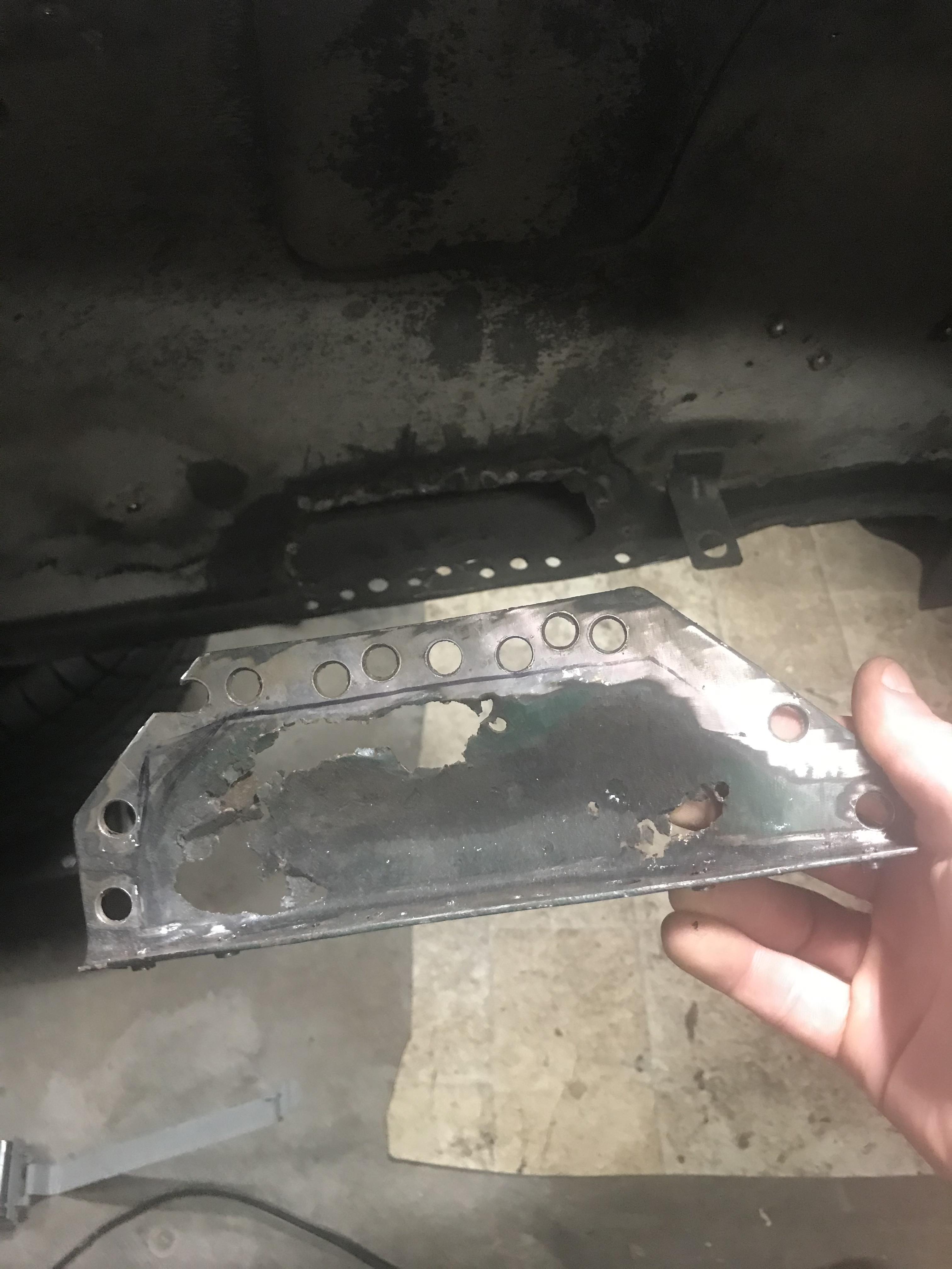

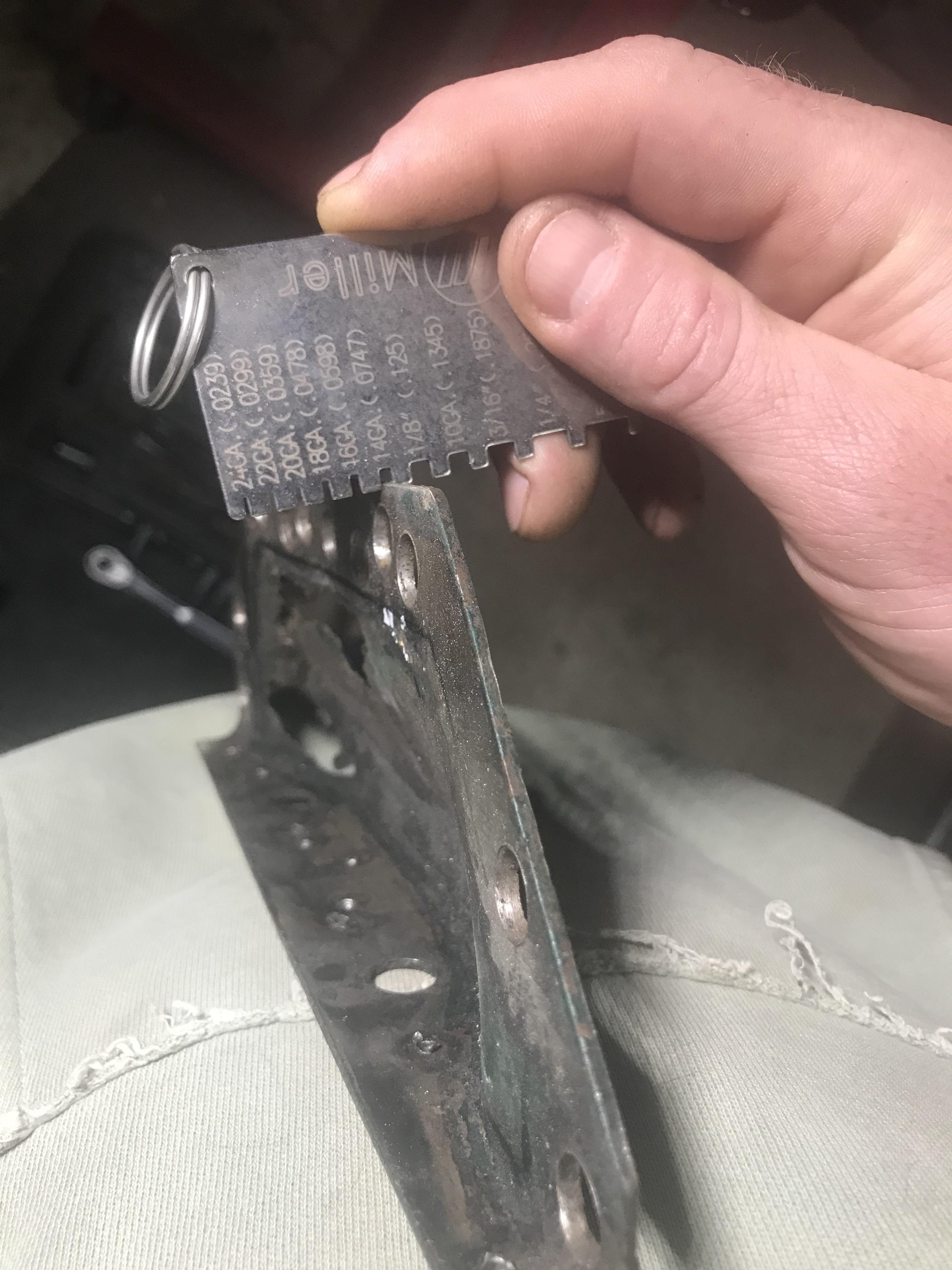

How about these pieces from the front wheel wells?  Must be 12 gauge, and some of the thickest sheet metal I have yet encountered on my series 1.   Anyone know of where to get these prefabbed, or an easy way to make them?  I cant bend/form that thickness...
Edited by AZStory
2 hours ago, Mark Maras said:
In the pic it looks like all the perimeter bends are usable. I'd consider cutting the bad (missing) parts out, leaving all the bends that are usable, and welding in inserts.
It's true.  Outside diameter is good metal. Unfortunately its where the complex bends are that's rusty. You can see the lines where I started to draw out my cuts, but I'd really prefer to buy two if I could, both sites are like this.  I'm a little surprised that this isn't more of a documented issue for other folks too...maybe I got lucky.
Not trying to hijack this thread though. Wanted to share this piece's thickness.

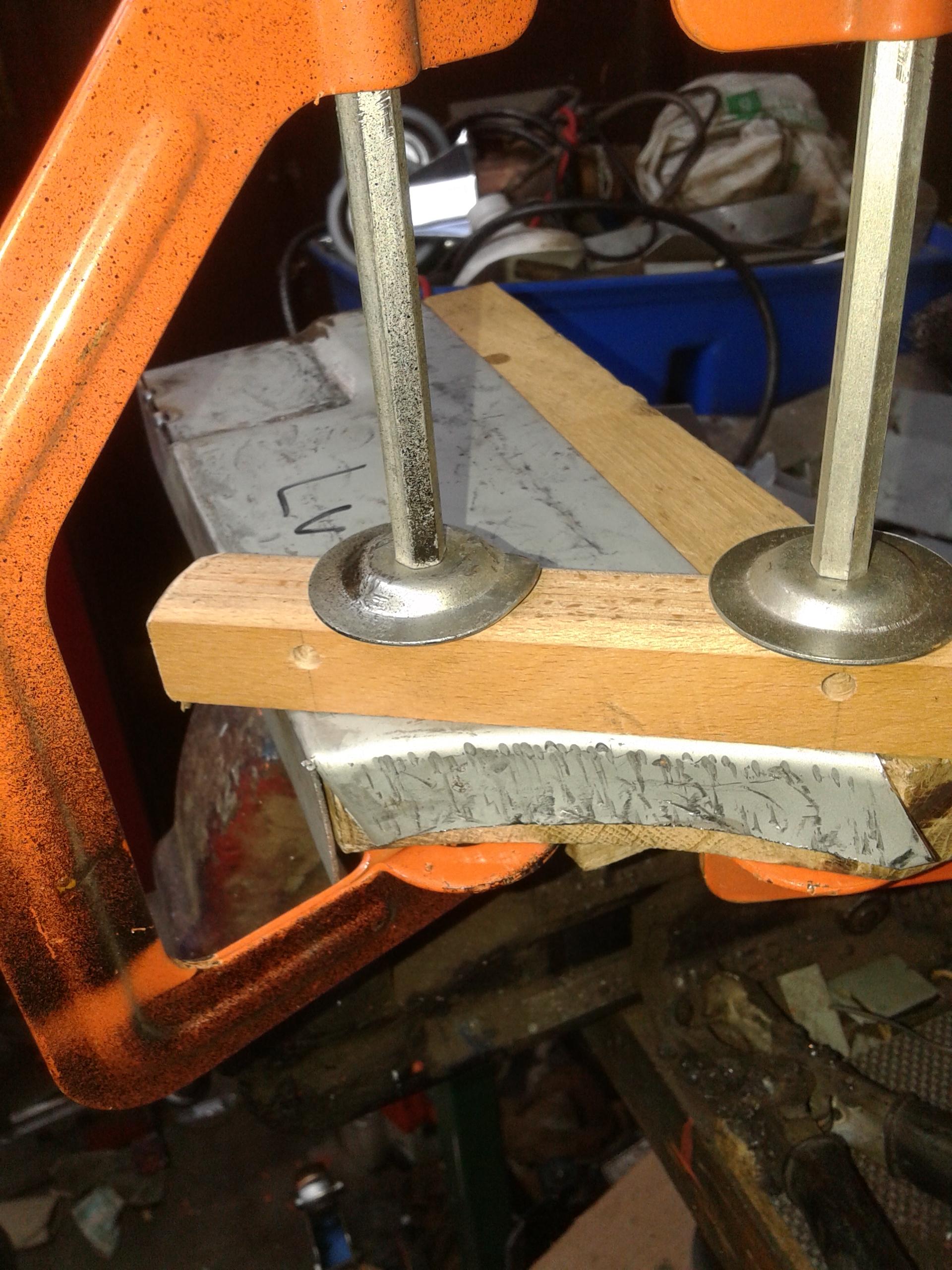

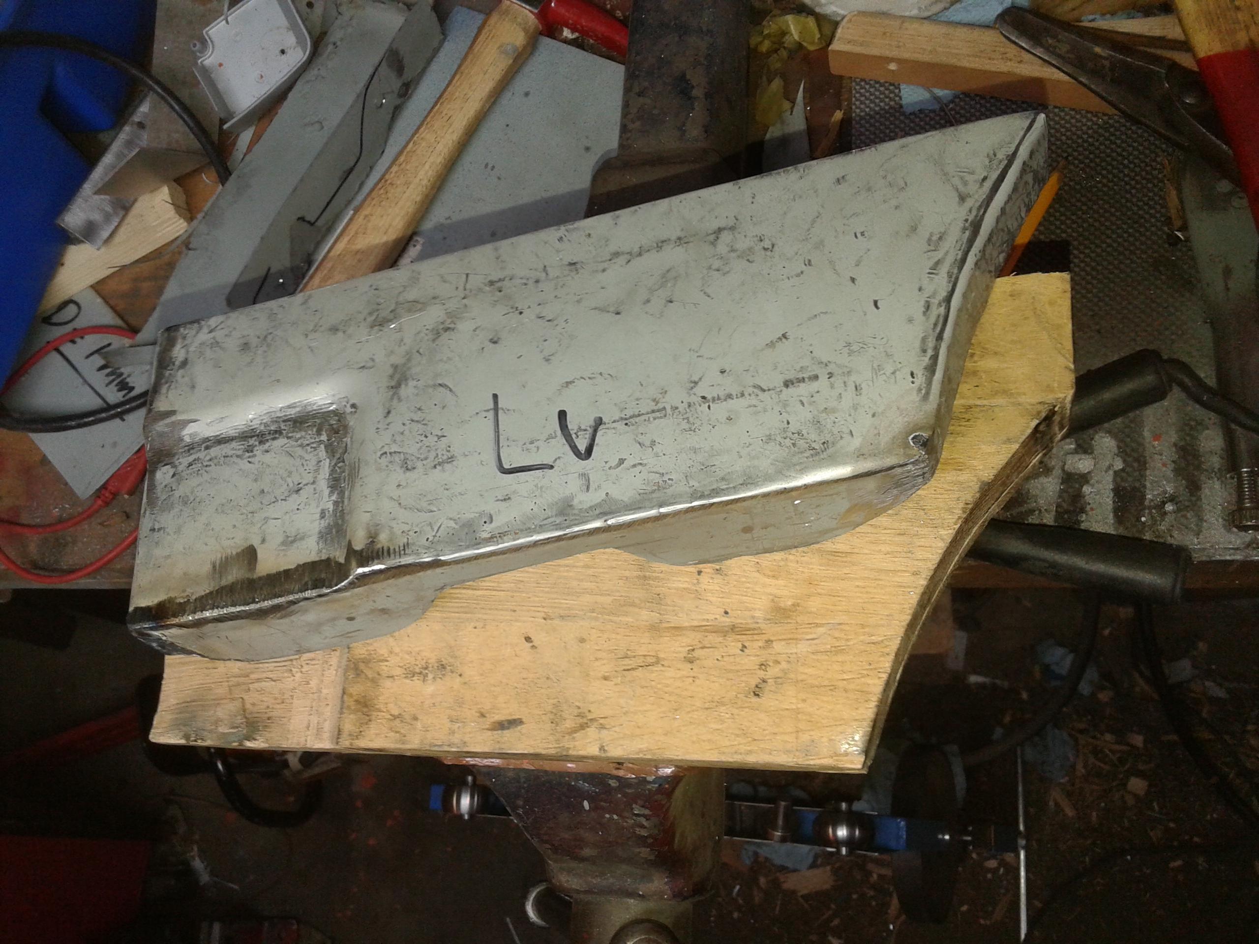

first cut of the "floor"part, you have to weld that one or a new flat piece onto it later.
As the piece of steel is only 2 mm you could easely make one on a piece of oak wood. Make a piece were the old piece fits in exactly.
a bit of woodworking and some hammerin.  like this for example..
(This is a piece for a 280zx frontfender, made out of 1mm steel, some welding needed on the edge low right and a longer weld in the left lower layd part.)
I really like this idea and hadn't thought to make a wood form to hammer over.  Thanks for sharing this.
And use a piece of metal shaped like a (side) banana peel.. sort of..  why? The upper piece will bend as you hit it with a big hammer. And make it square after you made the big dent.. think about it, you'll get the picture. (make the edges with a chisel (for steel obviously… my translator could give no good word for it but i mean the chisel that you use for breaking stone walls and can be used to make a nice edge in sheet metal.)
Also use some clamps and then make the bend.. or whatever you need to do.
