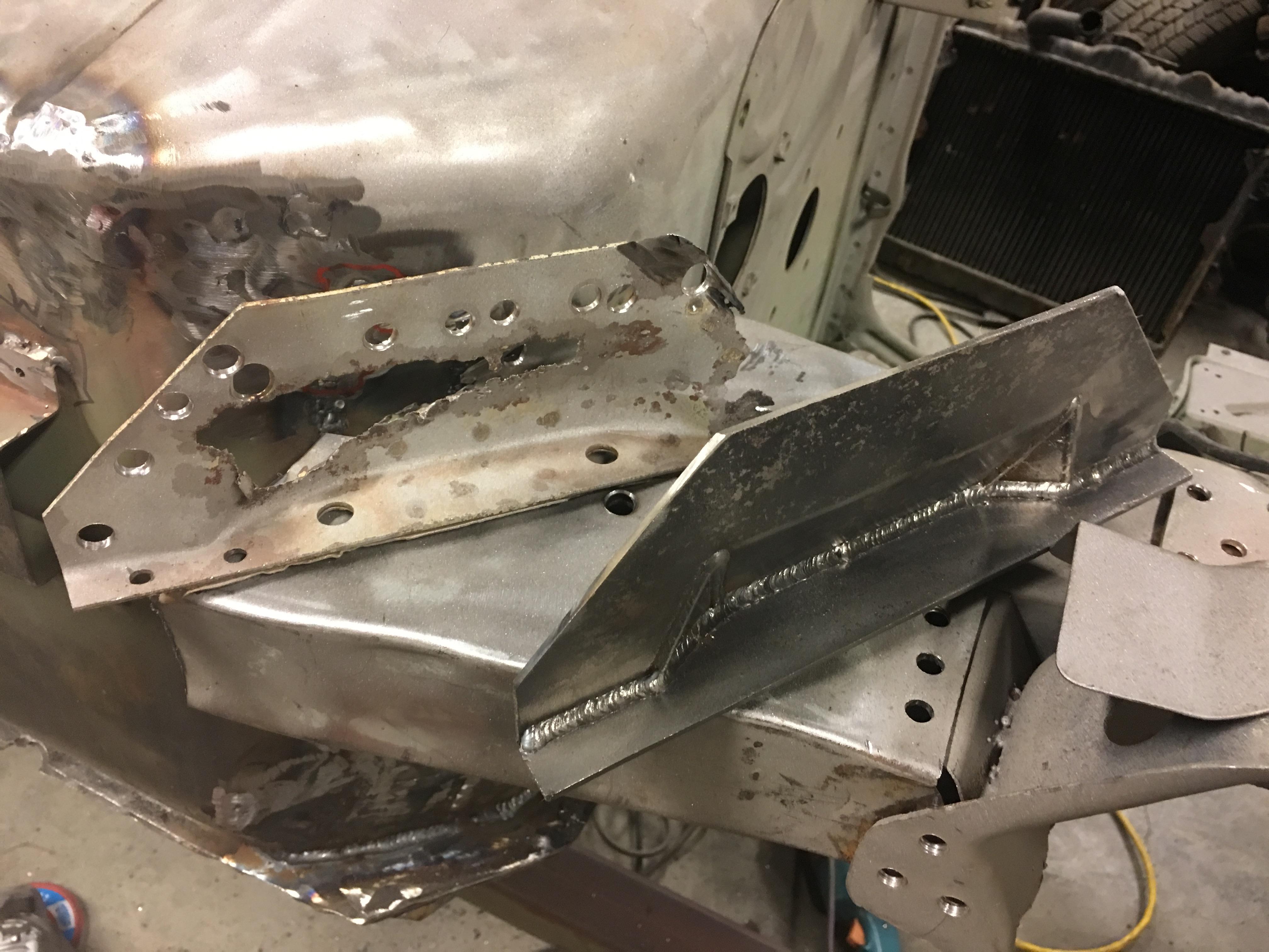

I'd just like to clarify that in my photo, my thickness gauge would not clear the sheetmetal on the "pocket" piece at 14g.  I think it's 12g sheetmetal.
Edited by AZStory
Point noted.  However, 14-gauge sheet can be anywhere from 0.0697" to 0.0797" so your measuring gauge (sized at the median thickness of 0.0747") could register a 'no-go' even though the piece actually was made from "14-gauge" steel.
More likely, however, is that this piece (like most of the other steel used in the S30)  was made from sheet steel rolled to the metric standard by a Japanese steel mill.  It seems very like that this doubler/reinforcement piece was stamped from 2.0mm stock (which nominally converts to 0.079" and would therefore likely register as 'too thick' for your measurement gauge's '14-gge/0.0747"' slot).
Note also that 12-gauge is a big jump up in thickness from 14-gauge...  0.1046" vs. 0.0747", so an increase of 0.0299"... which is almost 1/32".  From your picture, it doesn't look like your there's a mismatch of 0.03" between the S30 part and the 14-gge slot in your measurement gauge.  It also looks like your 12-gauge slot would be way too big...
All things considered, then, I like "14-gauge" for this part because it's very close* to what is most likely the real truth -- which I think is 2.0mm.
(* 2.0mm/0.0787" vs. 14-gge/0.0747", so within 5% using the nominal design thicknesses).

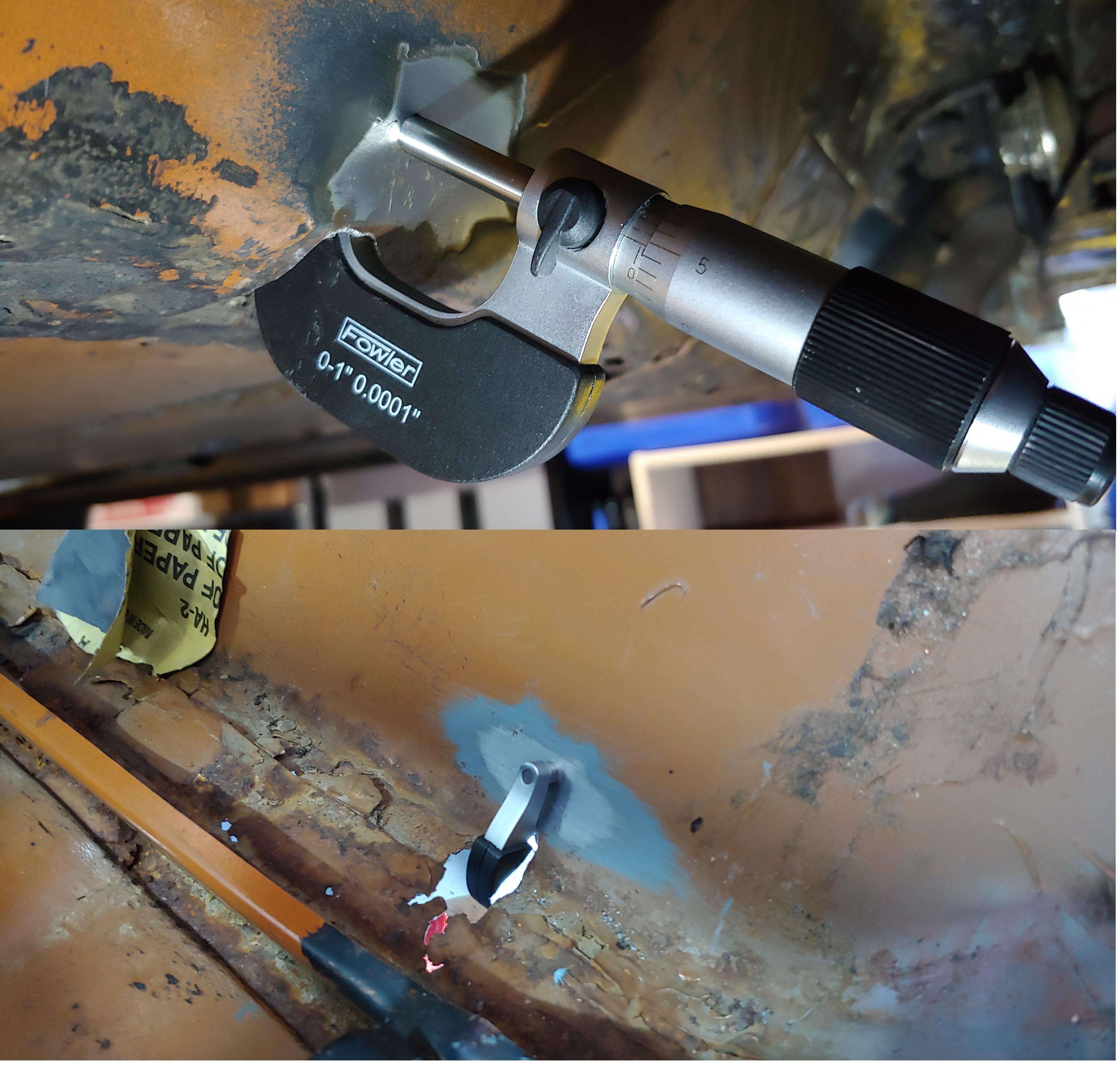

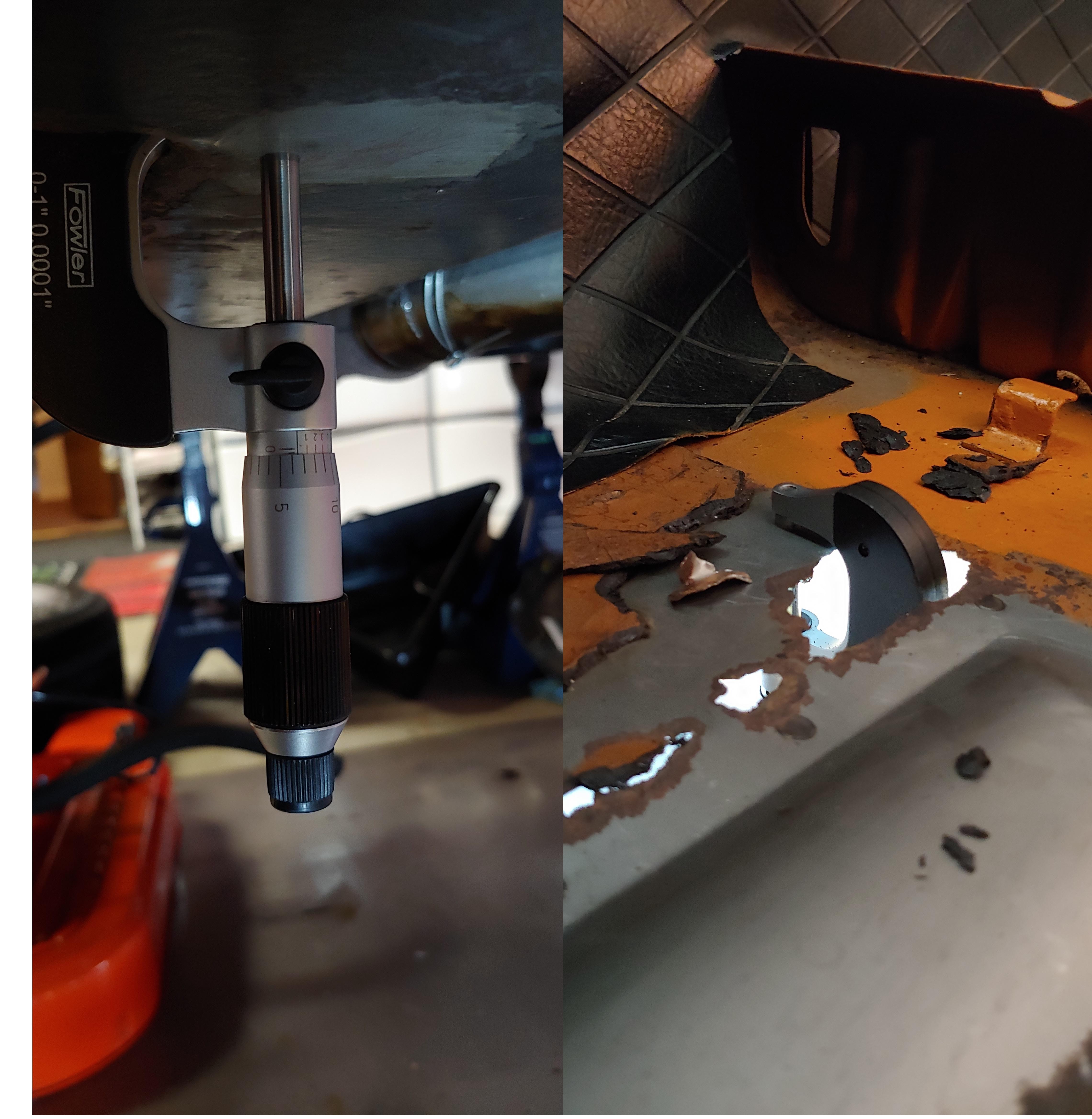

This morning I re-measured my floor pan thickness with seats out and better light, the new reading was .040" (1.02mm). However with the better light I noticed that there was still original paint on the under side that was quite thick. After scraping off some paint I measured again and the new reading was .0315" which equals .800mm. My car is a 7-70 production date.
Here is another floor pan measurement, this time for the mid floor section behind the left seat. Measured .030" (.76mm). Most likely 0.8mm thick sheet metal. Again about the only good purpose for a rust hole.
