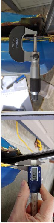

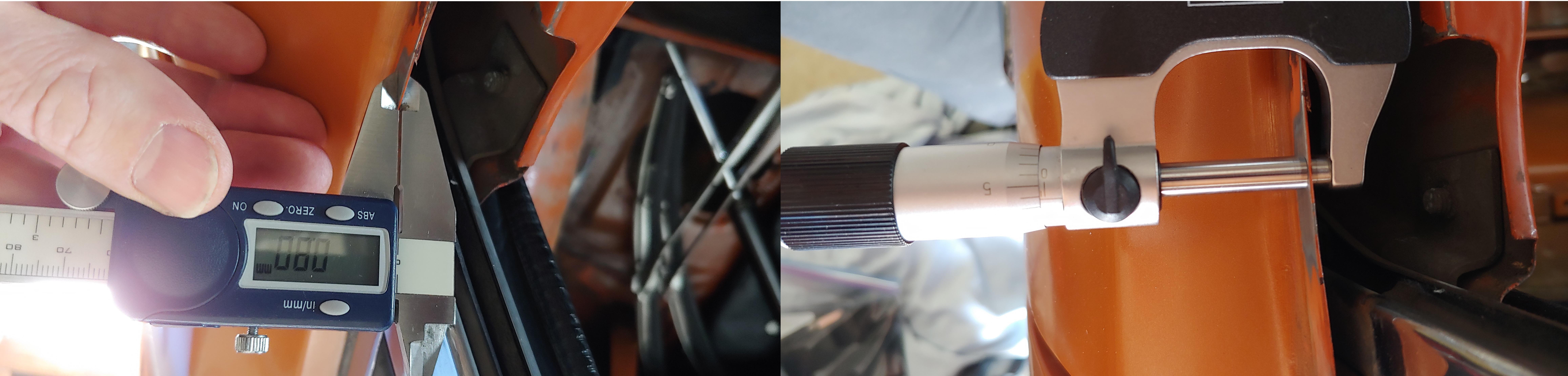

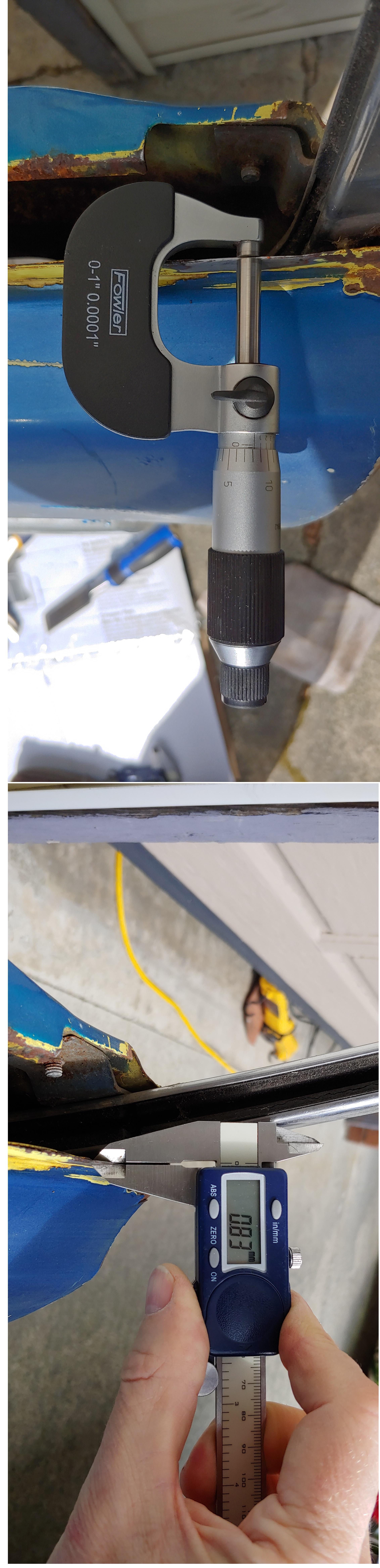

Here are measurements for both doors and from a LH door from my 12'70 parts car. All measurements are bare metal taken from the top window edge with the chrome strip removed. The door handle openings are too small to measure through.
7/70 LH door vin 06521 measurement by micrometer: .031" (.79mm) by digital caliper: .80mm

7/70 RH door vin 06521 measurement by micrometer: .033" (.84mm) by digital caliper: .84mm

12/70 LH door vin 16531 measurement by micrometer: .033" (.84mm) by digital caliper: .83mm

Sorry, I don't know how to rotate images when uploading, they look correct on my computer. Also regarding measuring, I prefer to use a micrometer when possible as it is more precise. When measuring with a digital or vernier caliper I find it best to only use the end of the jaws for measuring sheet metal, when using the full length of the jaws flatness of the sheet metal can effect the measurement. Also I find it's much harder with a caliper to get a true reading while taking a picture.
