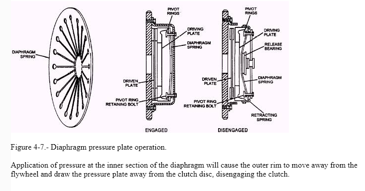

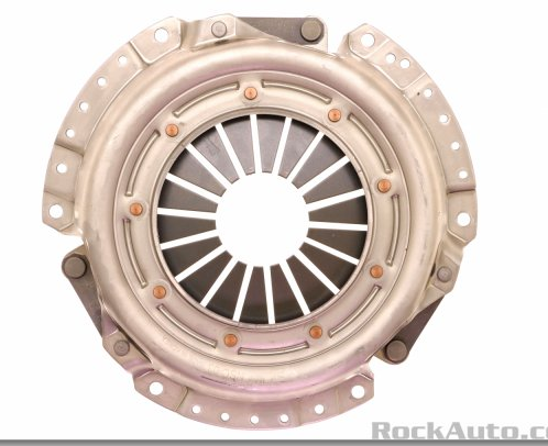

Looked through the peep hole in the transmission.  When the clutch was not pressed in, only some of the forks on the pressure plate were pulled back while others stayed pressed towards the back of the transmission.  Not sure if I'm explaining that correctly because I've never actually looked up there before or know how it's normally supposed to work.
One more thing.  Those fingers are actually all part of one single sheet of steel.  Called a diaphragm spring.  It can break and shift, not moving the plate anymore.
But if the fingers aren't even the pressure plate assembly is probably broke.  Details don't matter much.  But they're fun.
http://www.tpub.com/basae/90.htm
Edited by Zed Head
The only thing that pushes the fork back is those "fingers".  It's a big round spring.  Looks like only one finger is working.  I'll bet the clutch pedal is really easy to press down.
I think your pressure plate is broke, somehow.  It's odd though that the fingers are staying down, in the release position.  Regardless, it's not right and I think you'll have to drop the transmission to figure out what is happening and fix it. Can't imagine a fix any other way.
