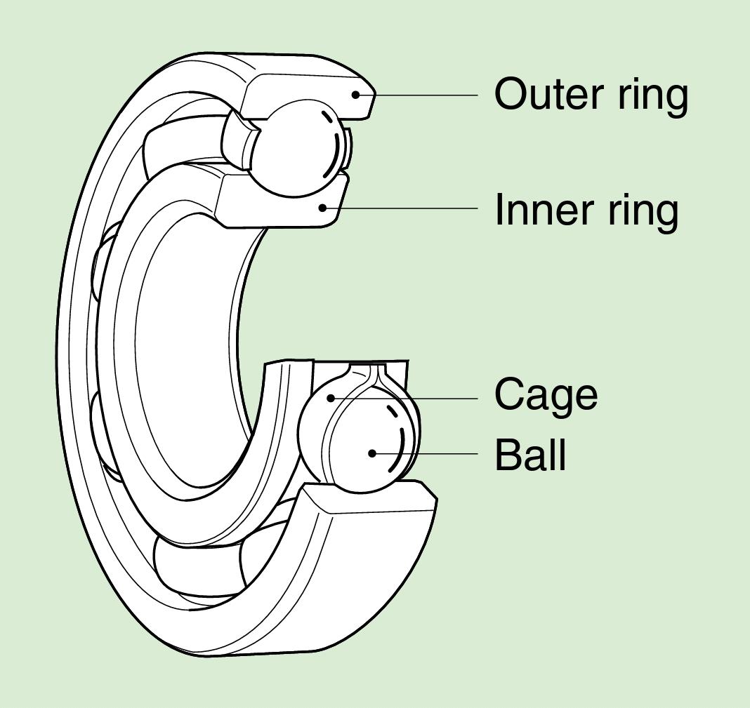

Looks like what is left over from a failed bearing cage (retainer cage)
That happens often when some foreign material gets lodged between the balls and the inner or outer ring (sometimes called race). The ball or balls jam and stop for a moment, but the cage is pushed further by all the other balls. This splits the cage open and then it fails shortly after.
The top left bearing in my photo shows the rivits clearly in your last photo.
I would advise at least replacing the bearings. You wont know all the damage until you strip it down.
