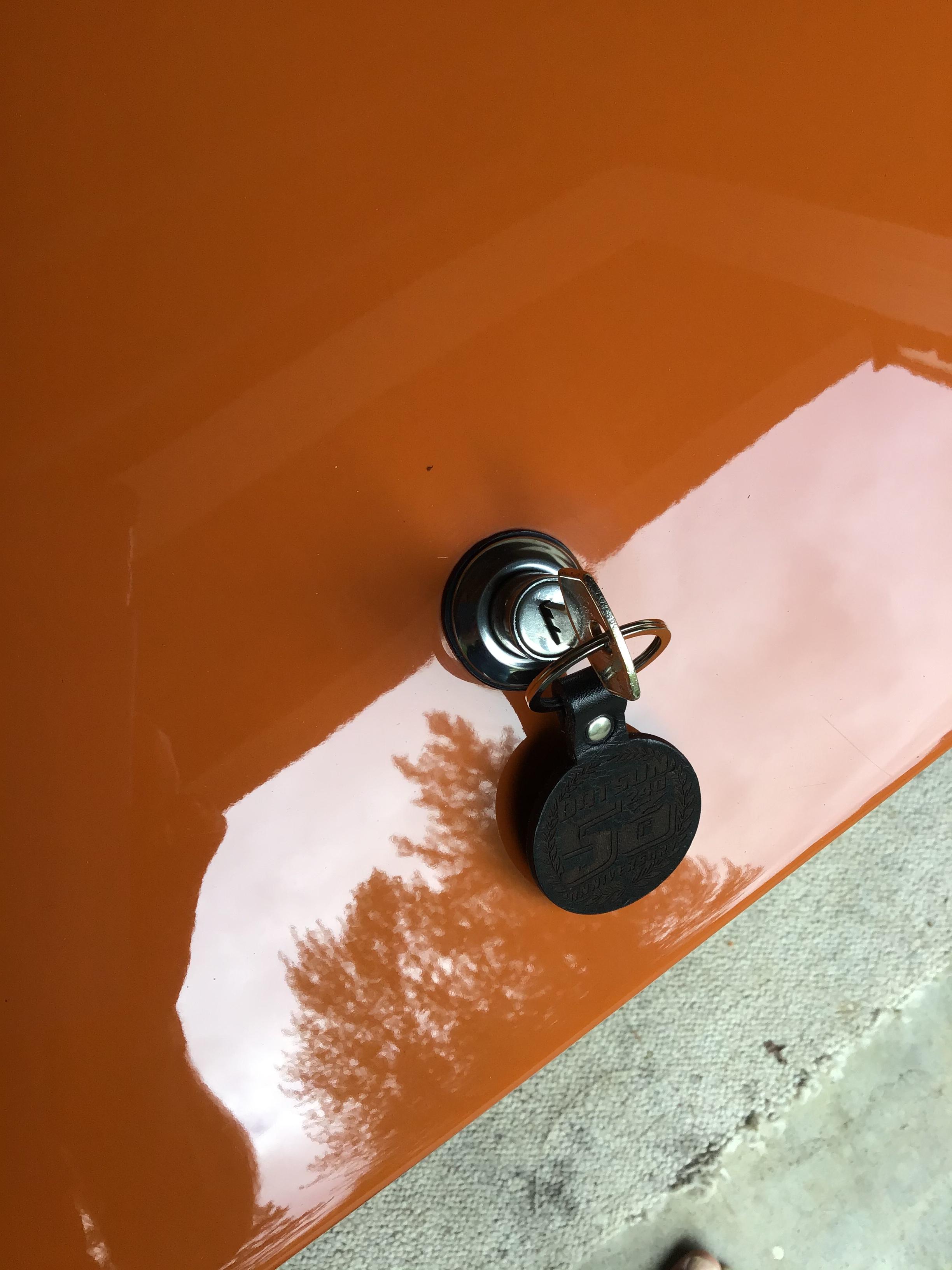

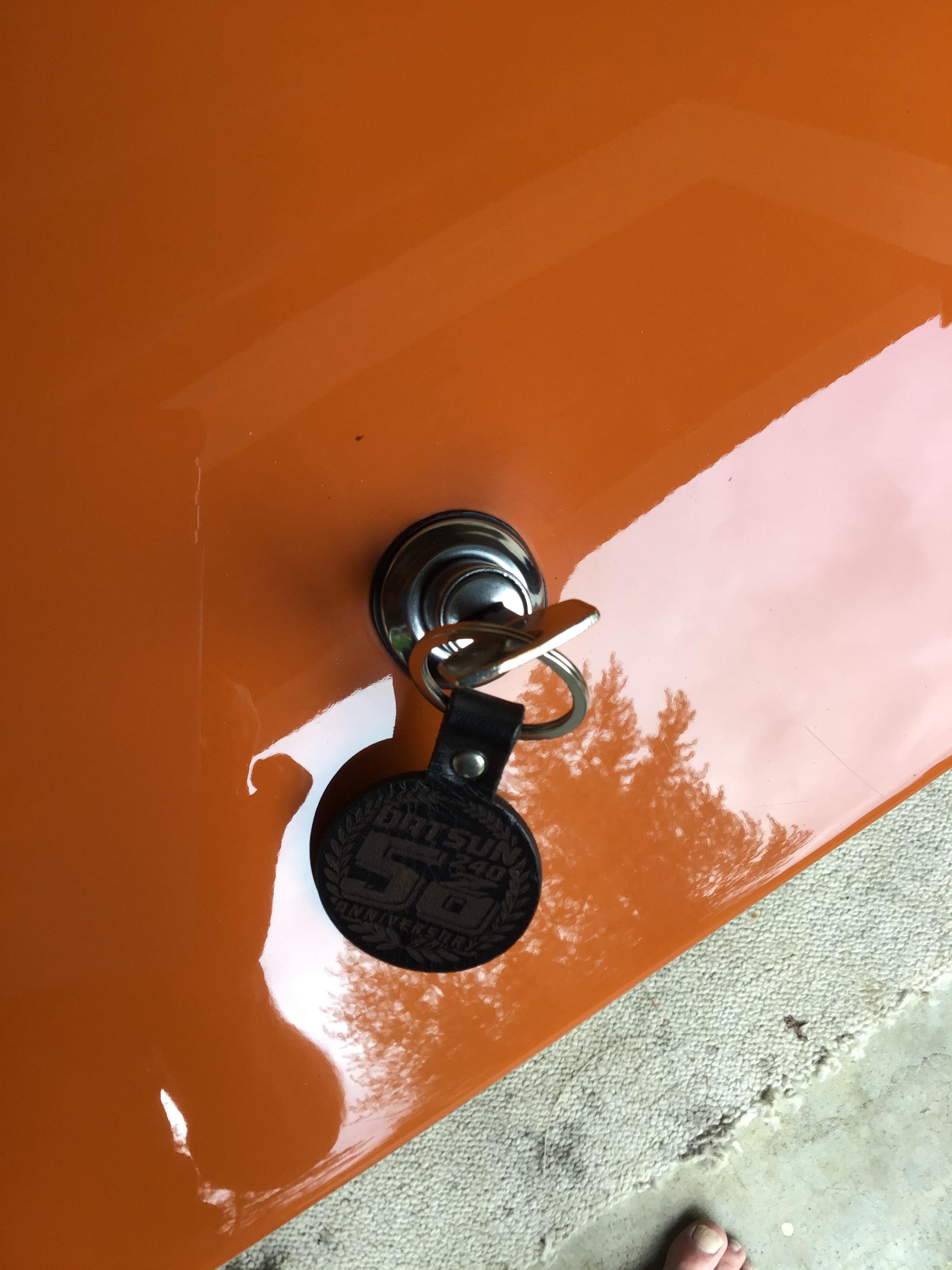

i assume it is unlocked now. So does the key fit into the key hole?  Will it turn?
on my 71 vertical is locked, horizontal is un locked. If it won’t turn then the issue is with the lock mechanism and you need to re key it. I think? They can match it to your current key.
locked
unlocked
I had to jiggle the key in my lock and make sure that the button was fully up to get the key to turn.  All the key does is lock the button in the upright position.  Makes it impossible to press down.  I think, as I recall from my 76.  For sure though, you have to hit the right spot to get the key to turn.

when I’m is locked the button goes down but doesn’t move the latch.
That's what CO said also.  I had forgotten if it was stuck up or just inactivated.  My lock worked great, I just didn't use it much.
They key point I was trying to make was that my key action was not smooth and easy like the ignition, glove box, or doors.  It took some fiddling to get the key to turn.

The hatch is currently unlocked, and the key is horizontal.  With the hatch fully closed, no amount of wiggling or jiggling the key will allow the key slot to turn vertical.  The key DOES work the glove box lock!  (Thanks, Captain, I didn't even know there was a lock on that.)  This key must be original, it is very worn, has a faint "N" on it, and has an oval head.
So it seems the ignition lock was replaced, and has a different key.  The other key should work everything else, but won't lock the hatch.  So, I'm going to take that lock out and see what I can do with it.  I just wanted to make sure I had the right idea before doing that.  Thanks to everyone!
