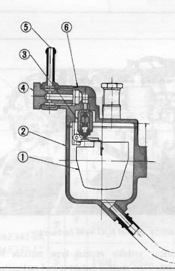

This is the bothersome part.  I'm not an SU guy.  But the float bowls should not be siphoning empty with the filter's emptying.
The car should run as long as there is fuel in the fuel bowls. Every time the filter runs out of fuel the car will keep running until the carbs are dry.

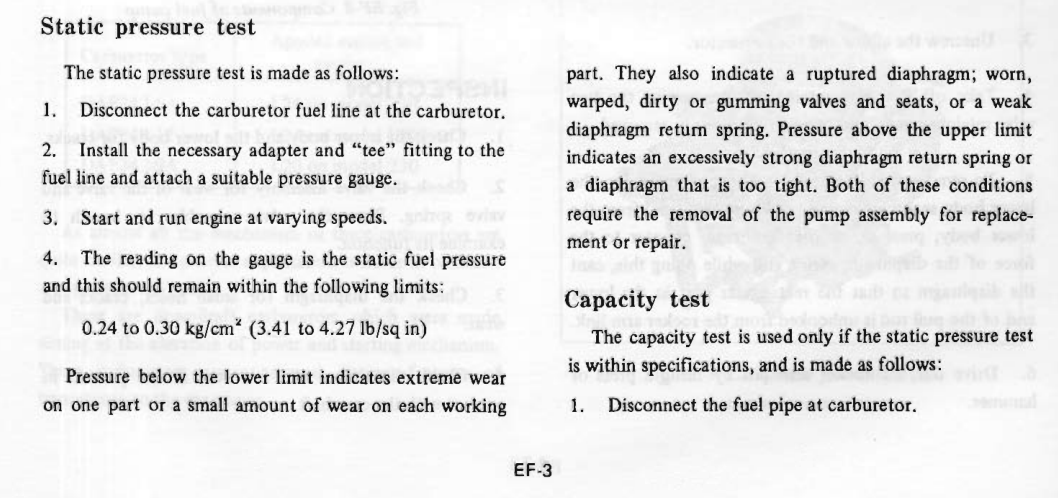

31 minutes ago, Zed Head said:
I think that the heart of the problem might be the bad valving.  Have you checked pressure, and capacity?
I have not performed the specific test. However, I think it's clear the Delphi fuel pump is the issue. Maybe the non original pump design is actually a better design.
