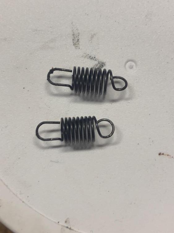

1) One of the springs is completely missing.  Nobody seems to have these in stock anywhere. I suppose I could run with just one spring for a while, but it's not ideal.

Advice? Don't try to operate with just one spring. That will throw off the mechanical advance curve. Too much advance at too low of an RPM.
I think distributors are easy to find. Might be easier to replace the whole thing than to get one spring.
I've got a 240 distributor that came to me disassembled and incomplete... Don't know what year it's from though. What is the number on the side of yours?

It looks like mine is a D612-52. If yours has compatible parts I'd happily take it off your hands. Send me a DM and we can talk details if you're up for letting it go.

If you're parts aren't compatible I'd still like to try to revive this thing.  Has anyone tried finding the right springs on e.g. McMaster-Carr?  I figure if I can find the specs (k-value, free length, diameter, etc) for the originals I should be able to find a suitable replacement somewhere.
Well I found the distributor basket case I was thinking about, and it's a D6K82, so I was apparently very wrong about it being from a 240. In fact, the info I have indicates it's at the complete other end of the spectrum and came from an 83 Non-turbo.
But here's the good news... The mechanical advance specs are similar to your D612, and if your distributor is SUPPOSED to have two springs, then I would assume that using one spring from my basket case is going to be way closer to the original design than just one spring. in yours
So short story? Whatever you want from this distributor is yours for the shipping. Just let me know.
