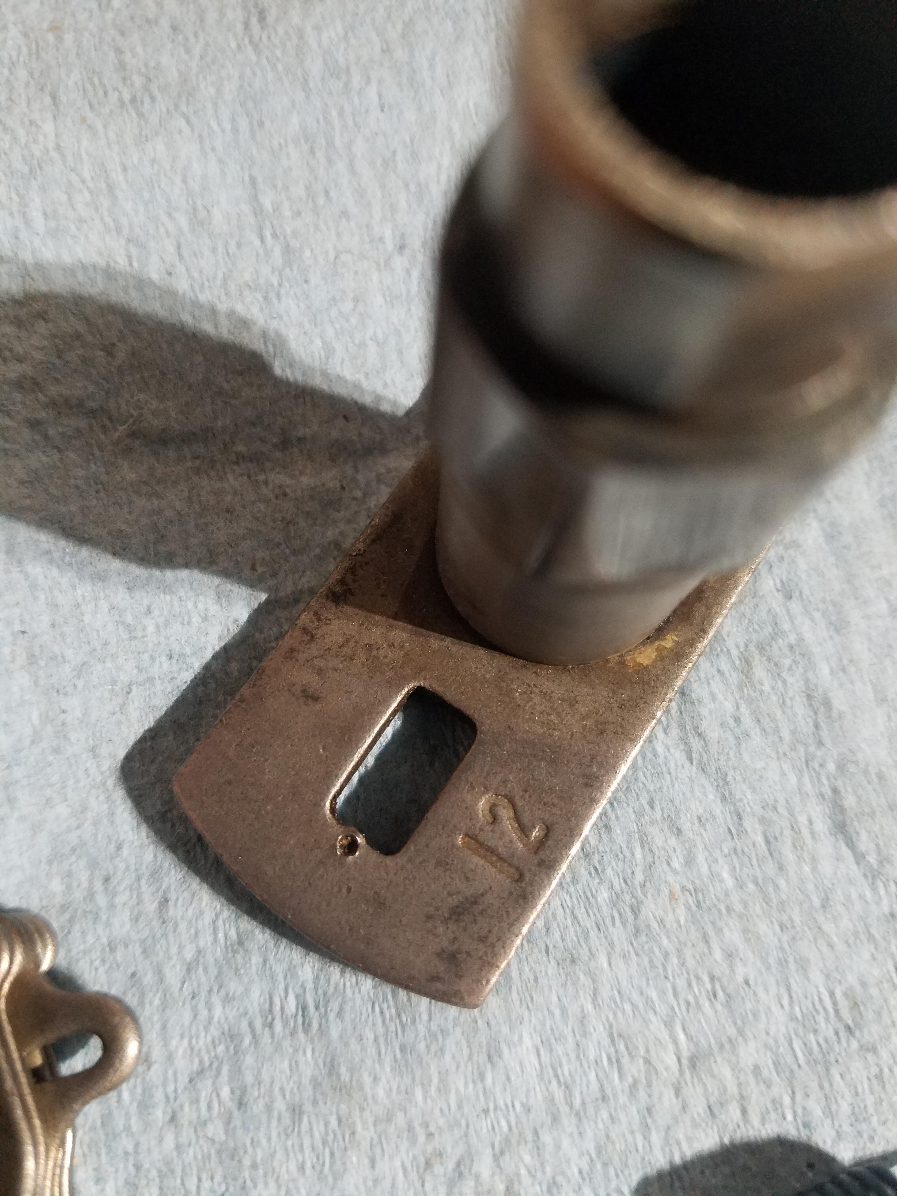

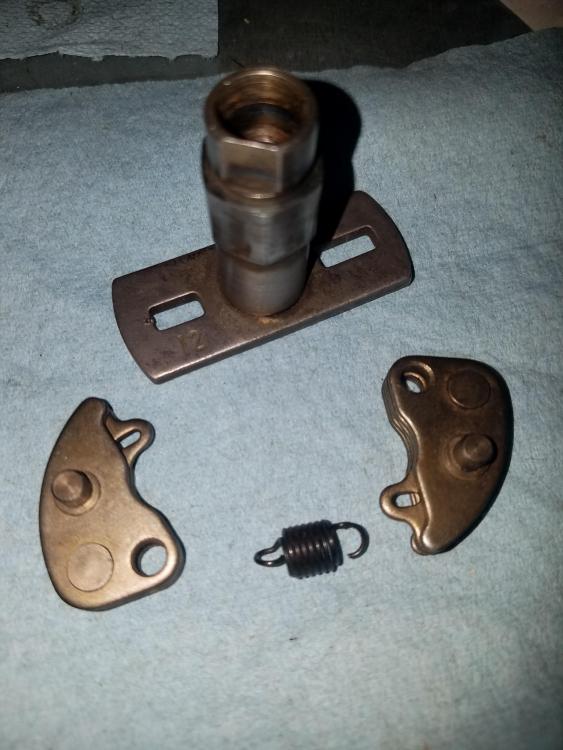

Removed a D612-52 from a 4/70 and found only one spring, not too many early units fall into my hands, so I'm not clear if they were to have one spring or two at this point. I believe someone else had been in there prior to me as you can see the cam took a hit where they just slightly closed the slot prior to the weights normal max swing.
After seeing this thread, I had to go out to the garage and check out my
D612-52 dizzy I picked up on eBay, supposedly off of a barn find parked
in 1978.  Also came with a nice set of Sumitomo plug wires dated coded
1977.
anyway, after tearing it down, it also only had the single spring, FWIW.
Dan
Dan
Yep.. I had my 240z 1971 distributor cleaned up 20 years ago and... IT HAD ONLY ONE SPRING IN IT..  May be a modification from Nissan?  Could be that there is something in the service bulletins Nissan regularly brought out? ??   I to wondered then why only one spring but i did'nt change it in 2 springs and it ran and runs still with one spring till this day!
