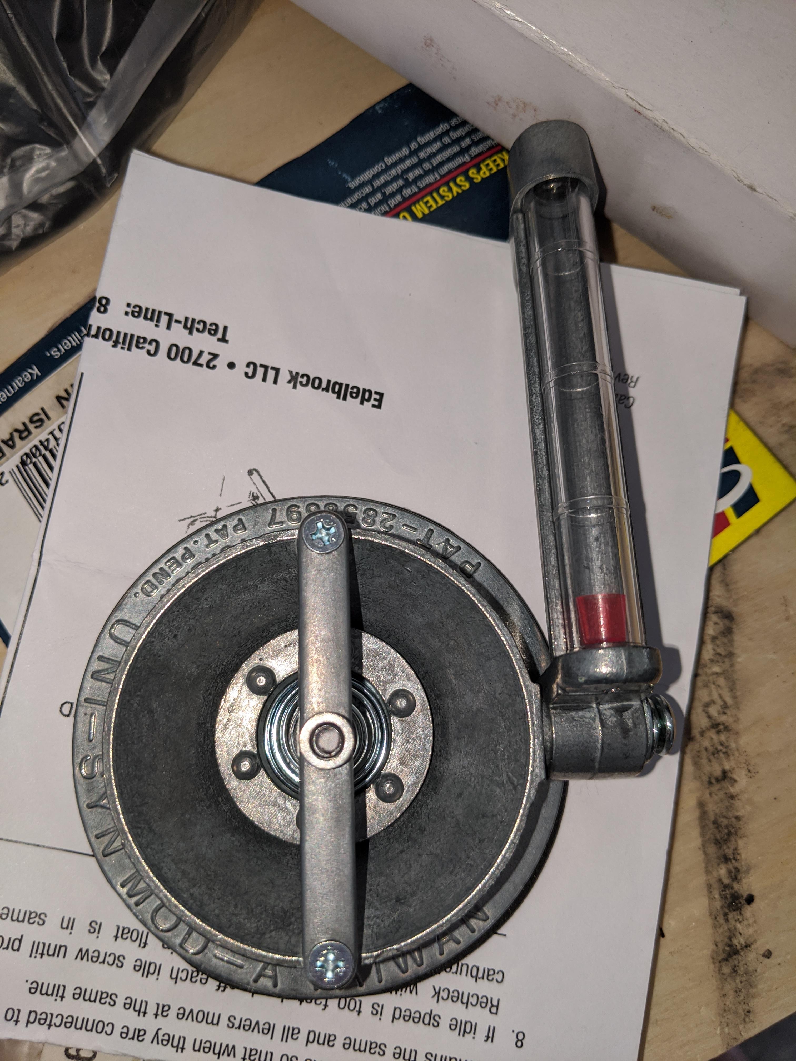

Btw, the original owner had this in a box of stuff. Anyone used one of these to tune a flat top successfully? Something tells me I'm going to run into several vac leaks in the process, and now I'm considering replacing with some MSA headers. My head is swimming.
Hi Dadsun--
Mark is right. You will need the Uni-syn  as an aid to balance the airflow in your carbs regardless of flat top or round top.
I wouldn't be spending money on a header until I found a true need for it. The header is immaterial to vacuum leaks. It might help with engine compartment temperatures, but until you've driven the Z hard enough and long enough to reach those temperatures how do you know it needs that as a remedy?
