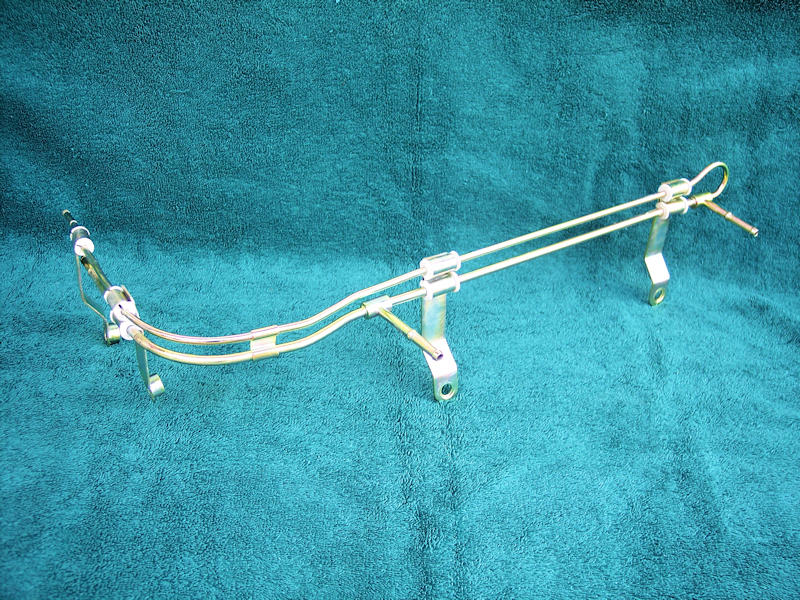

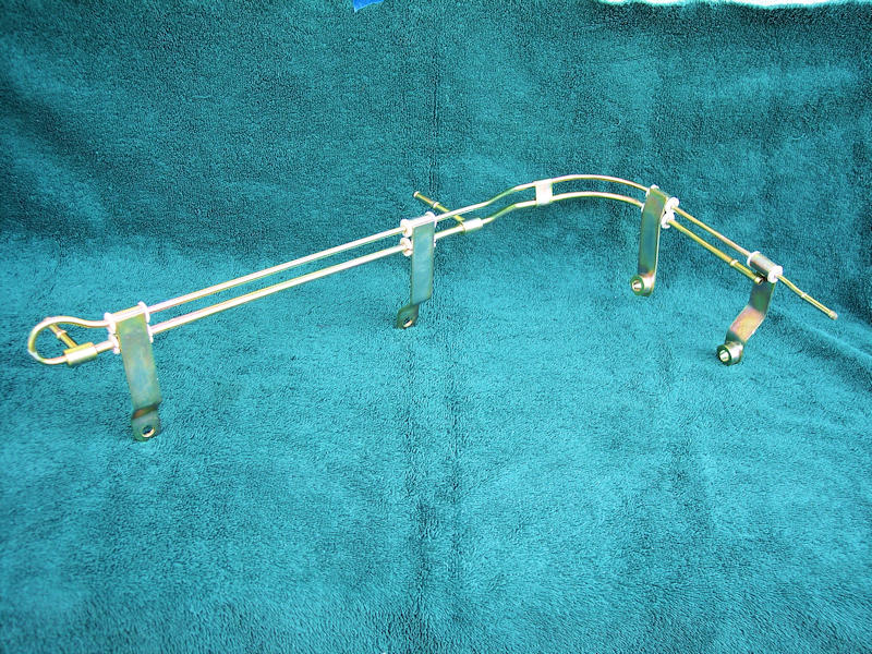

The insulation blocks on the carbs and mechanical fuel pumps help prevent direct heat transfer from the head. The heat shield does a similar thing - a barrier between the exhaust and the carbs. If your car is relatively unmolested, you probably have a heat shield already in place.
BTW - if you ever decide to tart up your ride a bit, I have a replated fuel rail looking for a good flat tops project!

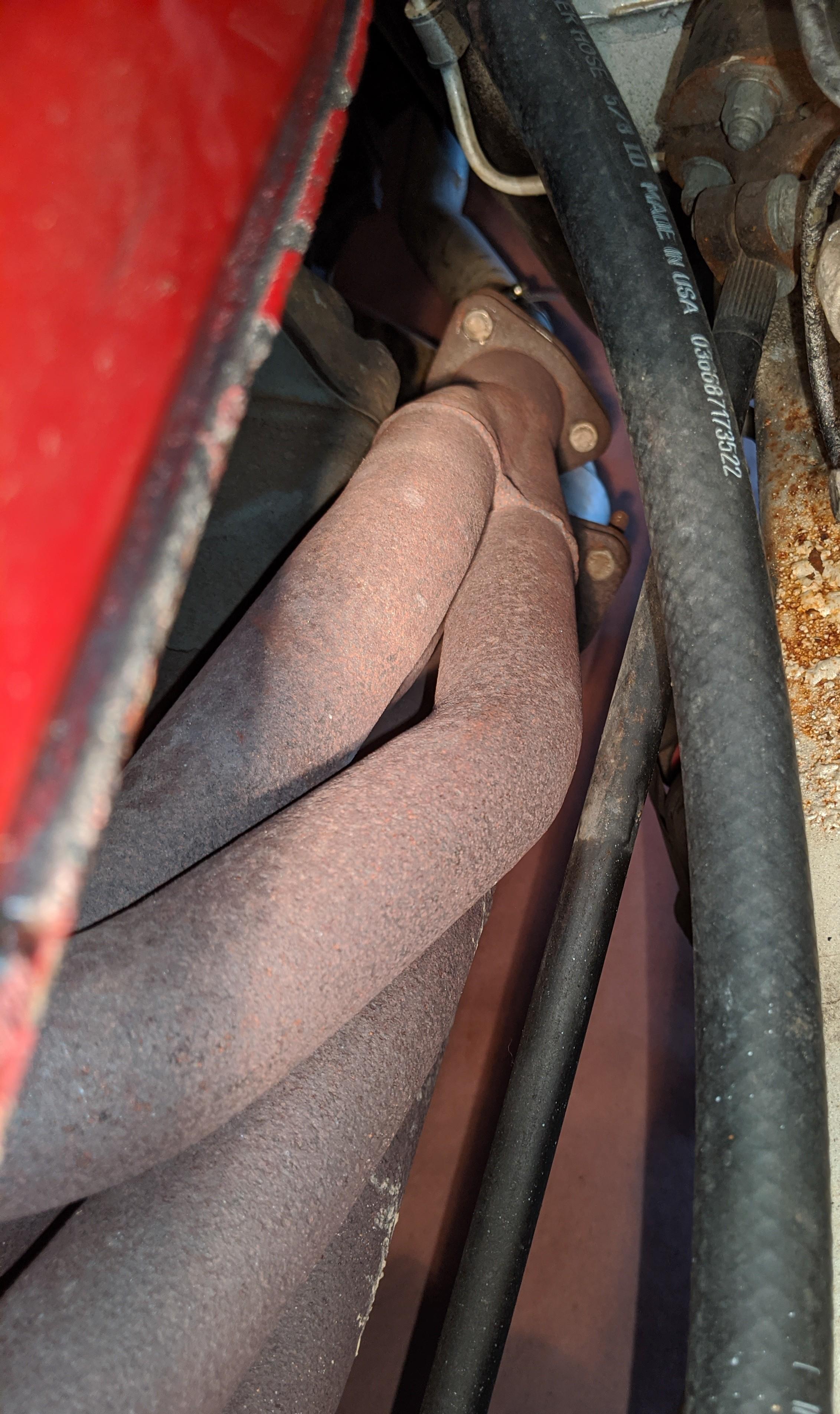

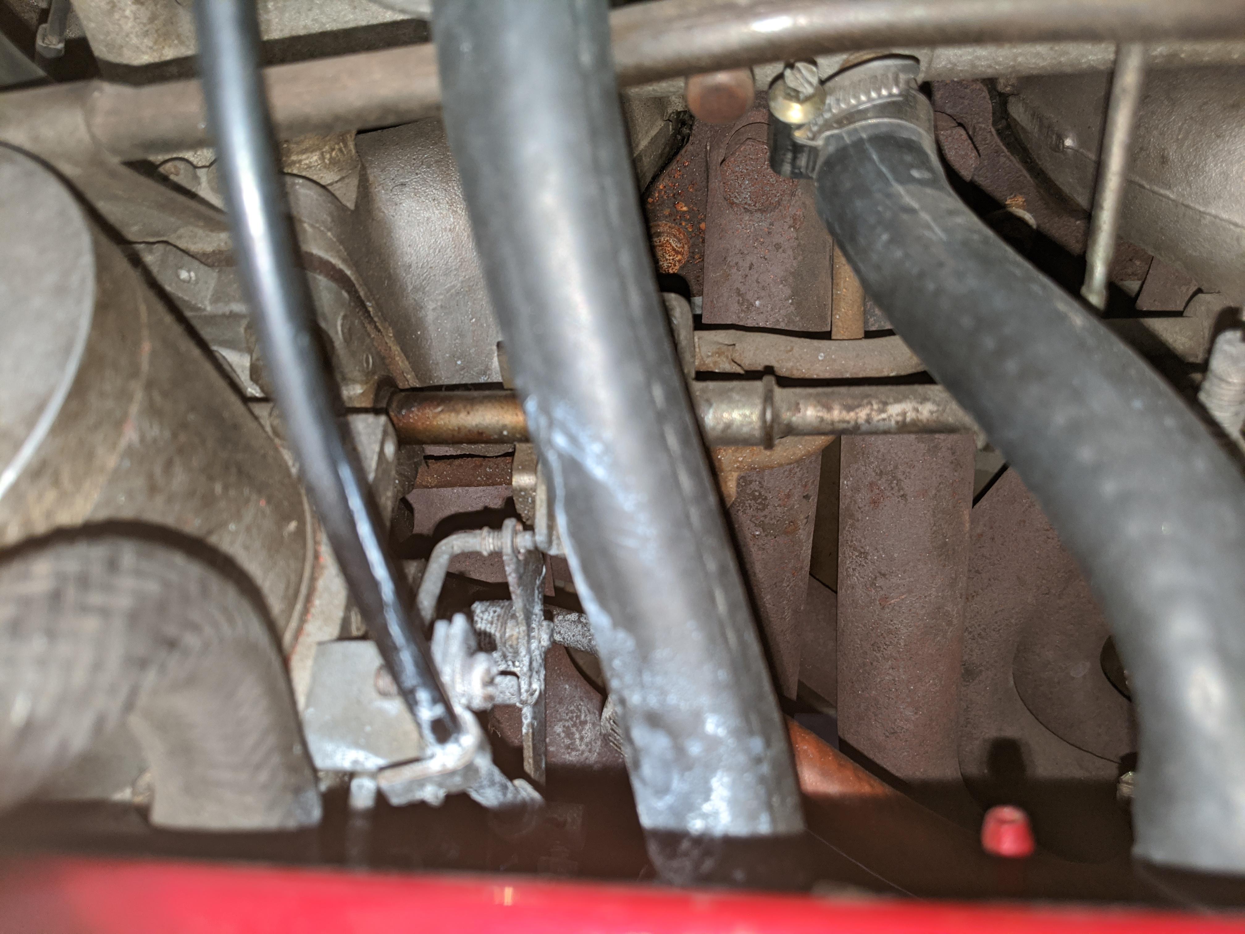

No heat shield currently. See pic.
18 hours ago, Dadsun said:
From this picture it looks like you already have headers and the air ports have bolts in them? If I remember correctly back in the mid 70's MSA had headers with the ports in addition to "comp" headers without the ports with a warning that they may not be legal in your state. If those are headers, are they 6 to 1 or 3 to 2 with a "Y" connector and do you have 2.5" exhaust?

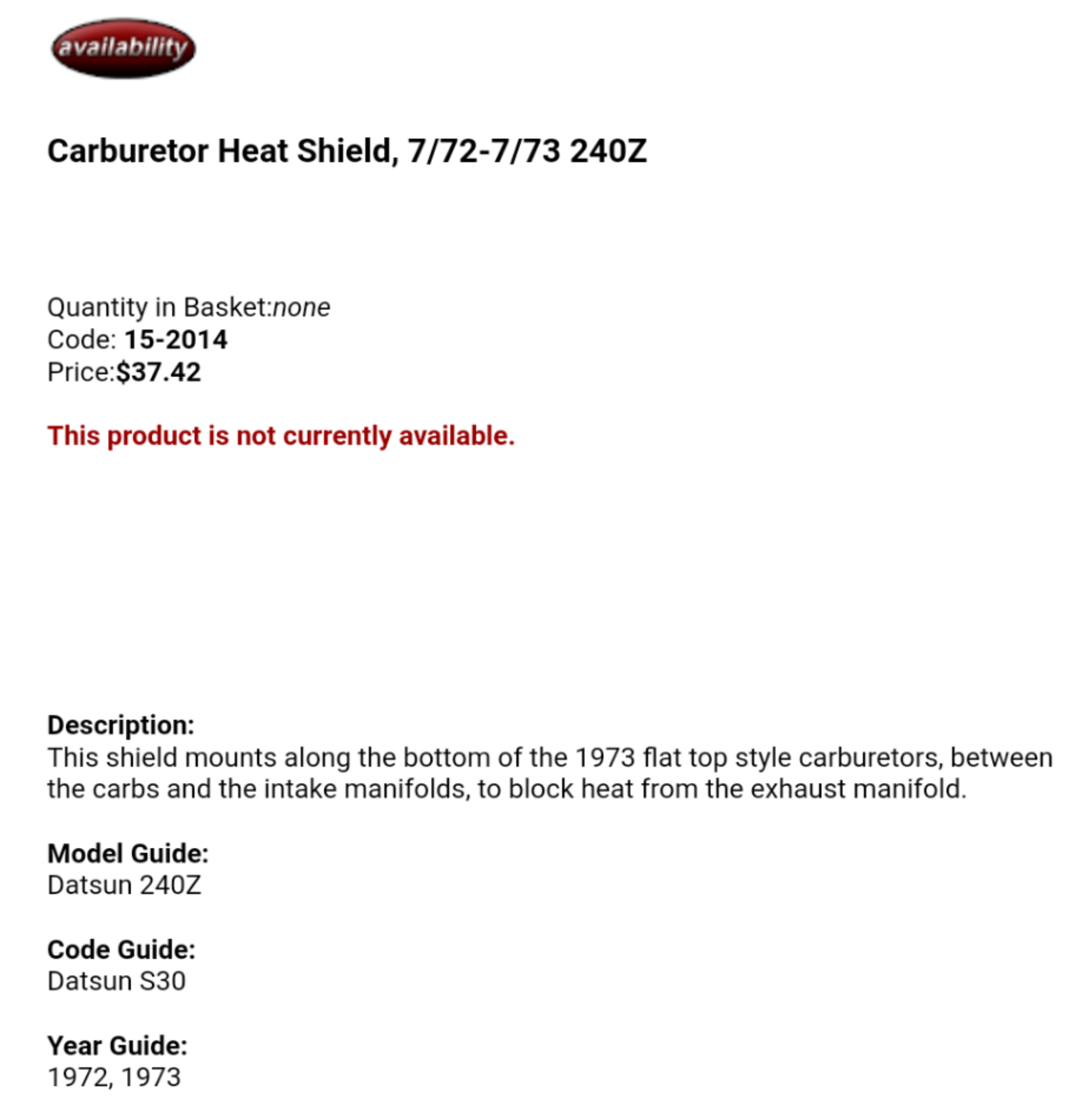

As for heat shield it looks like ZCarDepot has them;
https://zcardepot.com/products/carburetor-manifold-heat-shield-stainless-240z
