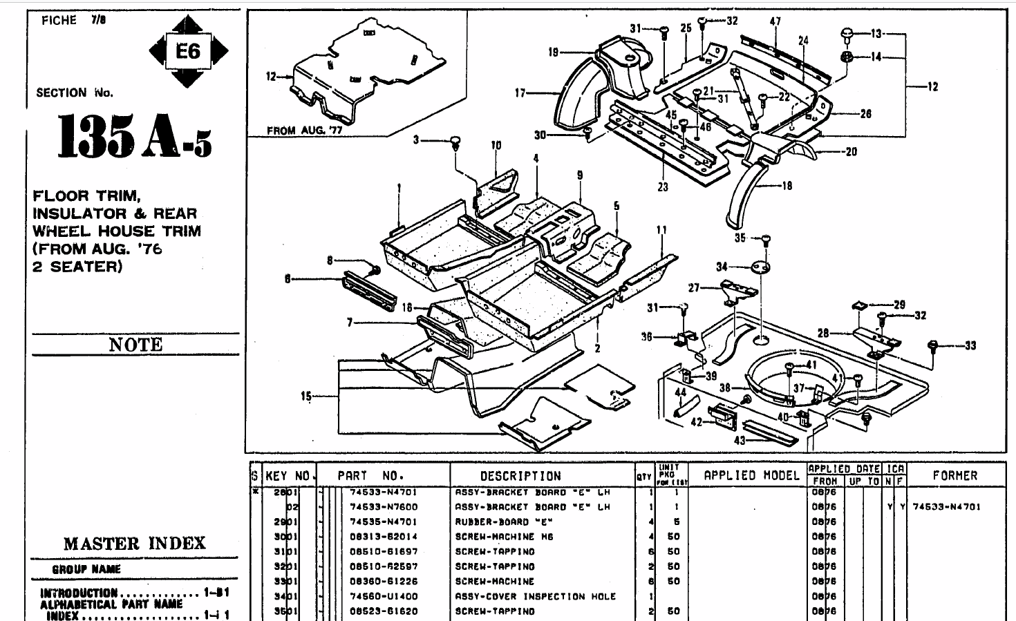

So I'm confused then... If you got the "improved" 77-78 cars, it sounds like (other than the engine), it's the same thing I have.
So why don't you have that convenient access port-hole in the rear deck for the fuel sender unit? is yours an early 77 or something?
Access port hole *should* be on all post Aug 76 models. Key #34. Did not search for 2+2 applications.
Unsure if the microfiche sold by the club covers *only* export to US models...
Thanks Wayne!
So AK, I'm not sure if you've got the access hole or not. Your sheet metal deck looks different than mine. Starting in 77 they put the stiffener frame rails on the interior side (top side) instead of underneath (gas tank side). My guess is that since they had to use the raised floor for the spare tire anyway, they figured they had the room and moved the stiffener braces. It doesn't look like you've got those braces.
Another way to tell... Do you have a full sized spare, or the collapsible inflatable one? I'm thinking you've got the full sized spare and rear decking that we would call "76" over here.
There's no guarantee that what we call "77" over here has to be the same as what you got in the UK.

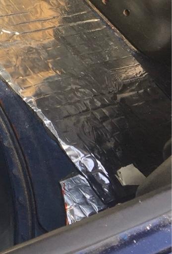

To be frank I don’t know what spare wheel I’m supposed to have as my car had a few owners before me. It did have a diamond cross wheel with a full size tyre on it and VERY old rubber. So I would say it’s safe to assume it was designed for a full sized wheel.
When I finish home schooling* later today, I will go to the garage and remove the sound proofing in that area as I am very intrigued!

I couldn’t take the sound proofing off, however I’m pretty sure I have the bump but not the hole / inspection lid below it.
Having said that, my fuel sensor is on the back of the tank in the same place as a 240zeee further back from it so I’m not sure it would have served a purpose for me anyway.

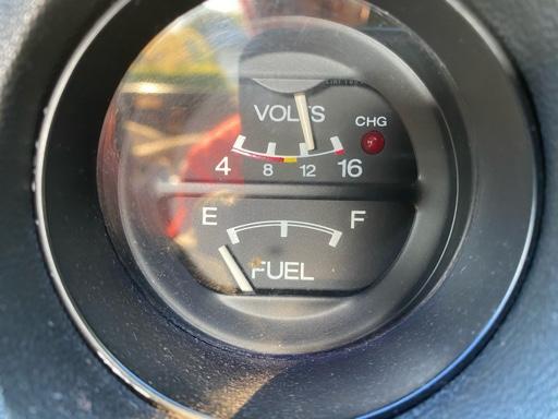

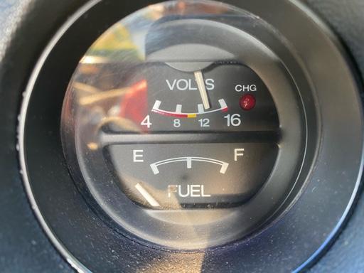

Finally, I’ve been investigating fuel smells and drained the tank with the full intent to drop it. But as it happens my courage and time ran out so upon further investigation I found some deteriorating breather hoses inside the car. Replaced and no more smells - for now.
Why am I telling you this? Because:
Here’s the gauge with ignition off ....

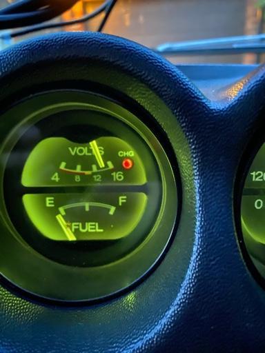

And ignition on but totally drained ...
65db7860806e642f124ecf1dd61a767c.jpg&key=2c1e31d6b305e02dde9f87cc0fb94799d3328fbe777d2e395a47812f7716e64d
And with 9 litres or just under two imperial gallons poured back in ....
30d7aeb7d25019ce95bf5271d94eab3e.jpg&key=b4934005ad7cc1cefd07b8ad20306ef96e03ad729867552bc943b86a277e463b
Unfortunately I didn’t measure the impedance as I was in a hurry to beat sunset (which is currently about 20:50 here) and de-grump my wife.
Yeah, your fuel gauge looks like it reacts the same as mine. Always too low. I haven't done anything else with mine (since I cleaned up the connector right at the sender unit), but I fully expect my issue is inside the tank. Murphy's law pretty much demands it. That Z hasn't come back around on my work sheet yet. I've got all sort of other car work to catch up on. Today I changed the plugs on a V6 Kluger. Including the three invisible ones in the back... That's no fun.

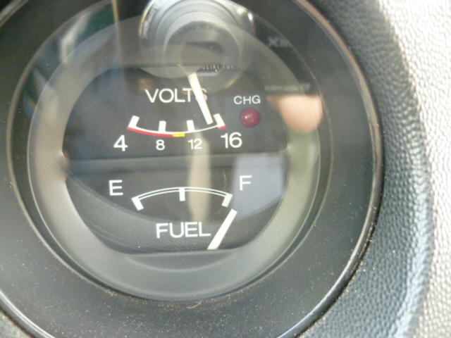

I filled up my gas tank yesterday for the first time since cleaning the connector pair at the sender unit, and guess what!!!!??
My gas gauge now reads significantly higher than it used to before cleaning that connector. Here's a full tank now. It used to read at about 7/8 full (even when full), but now it looks a whole lot better:
So for me, cleaning this connector made a big improvement:
I may still pull the sender unit out of the tank for inspection, but the priority just dropped down on the list a bunch!
