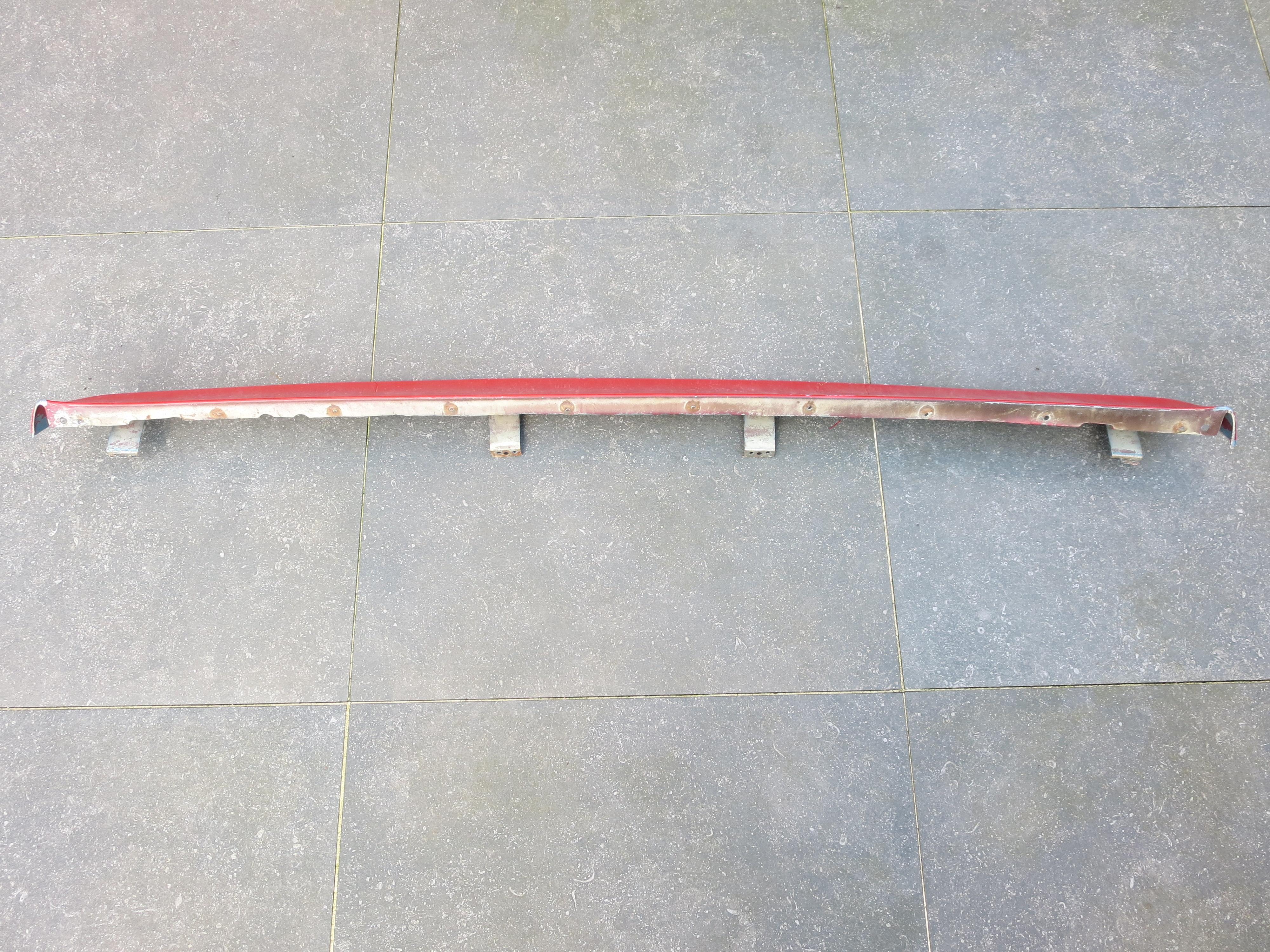

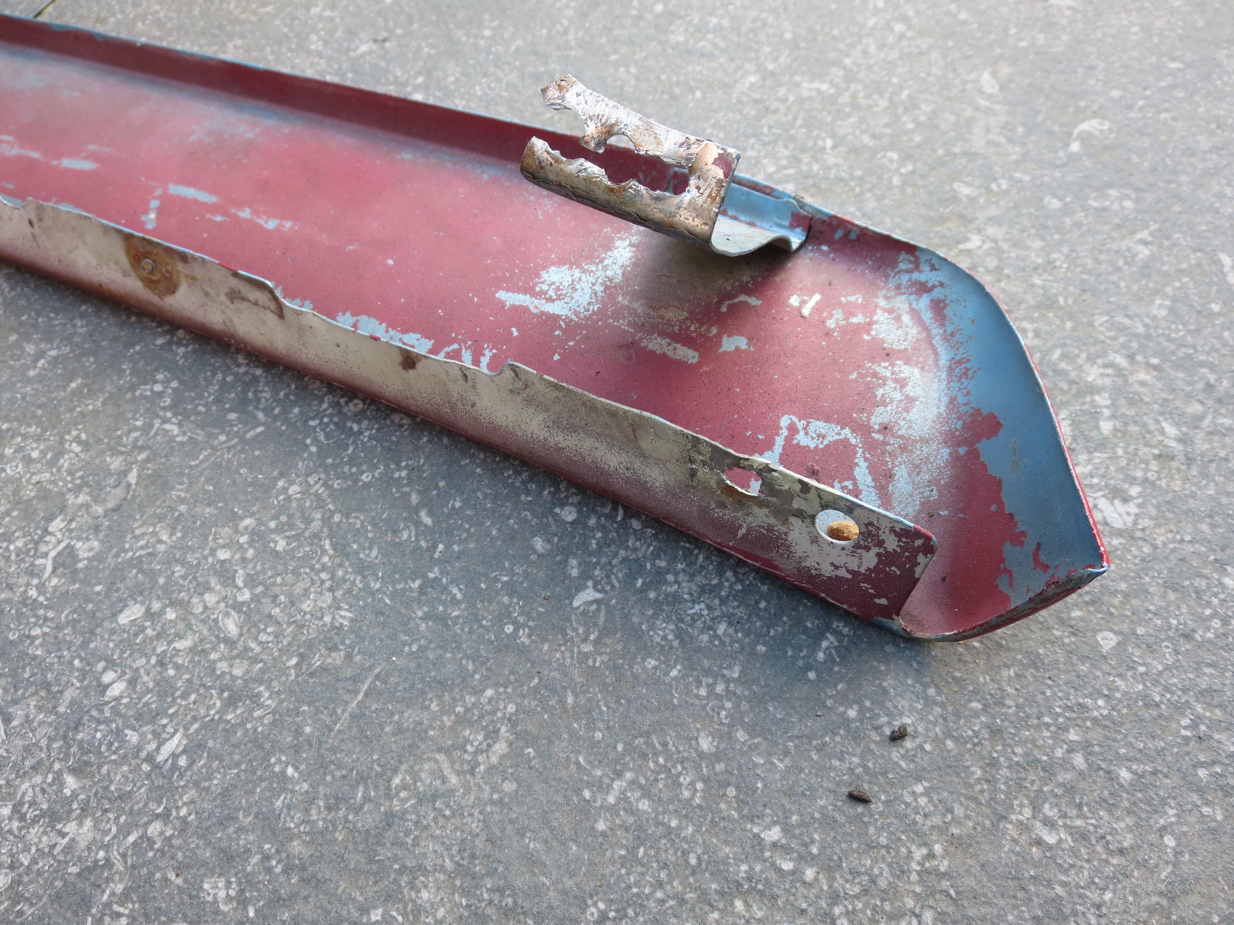

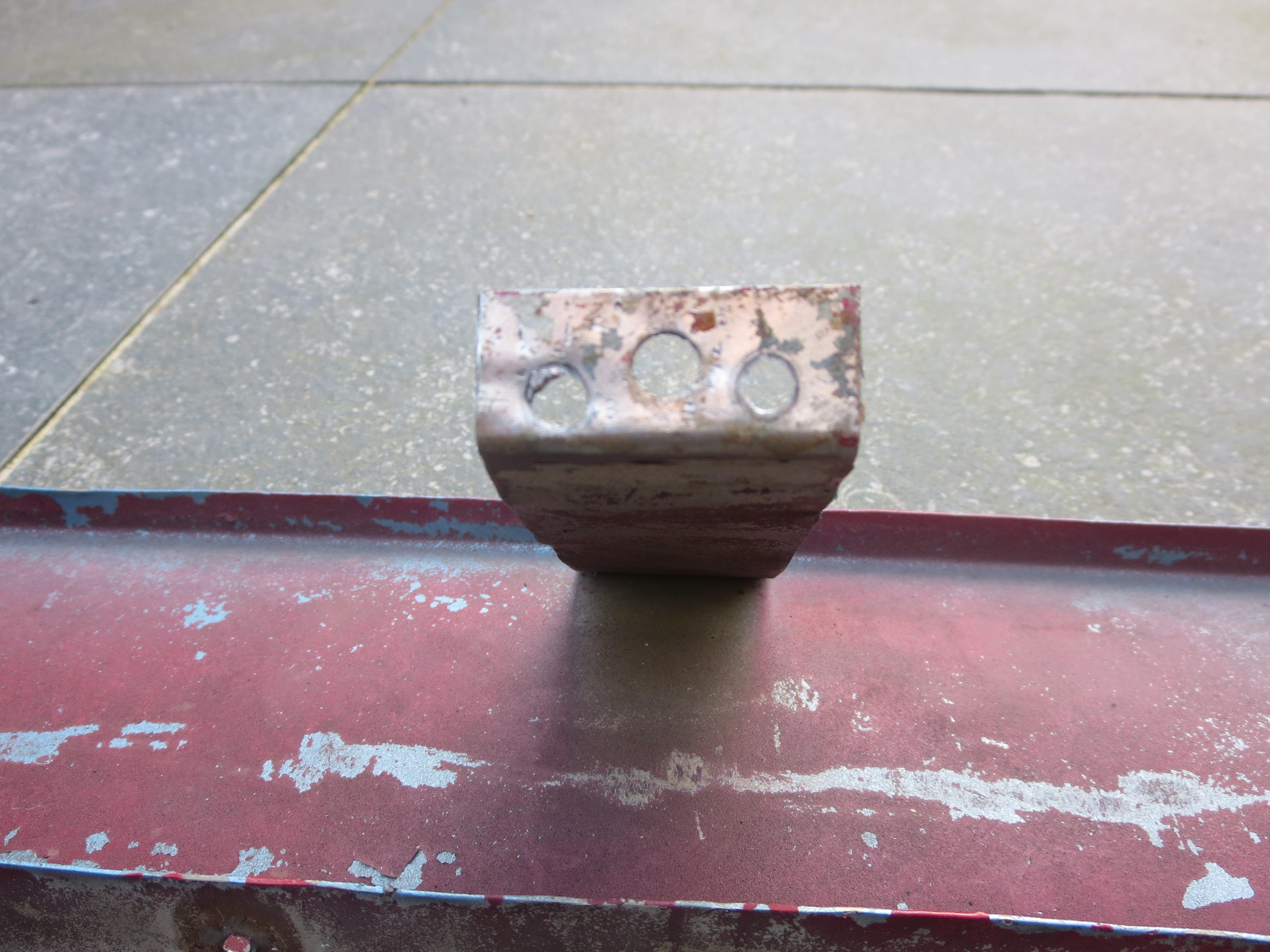

Those support tabs on the sight shield have three and one tab even had four not so evenly spaced spot welds. I managed to remove mine without too much damage too it.
I took some photos of mine a while back to help someone with removing the shield.
Another interesting thing about the mounting of this shield is the dimples in the valance on the body. You can see their mark on the photo 2214. They are about 20mm in diameter and 2mm high. Located at every spot weld.

I used a simple drill bit, but didn't go all the way through. Rolled the drill around while drilling to mill the spot weld away. Then pushing the sight shield up and down until it broke loose.

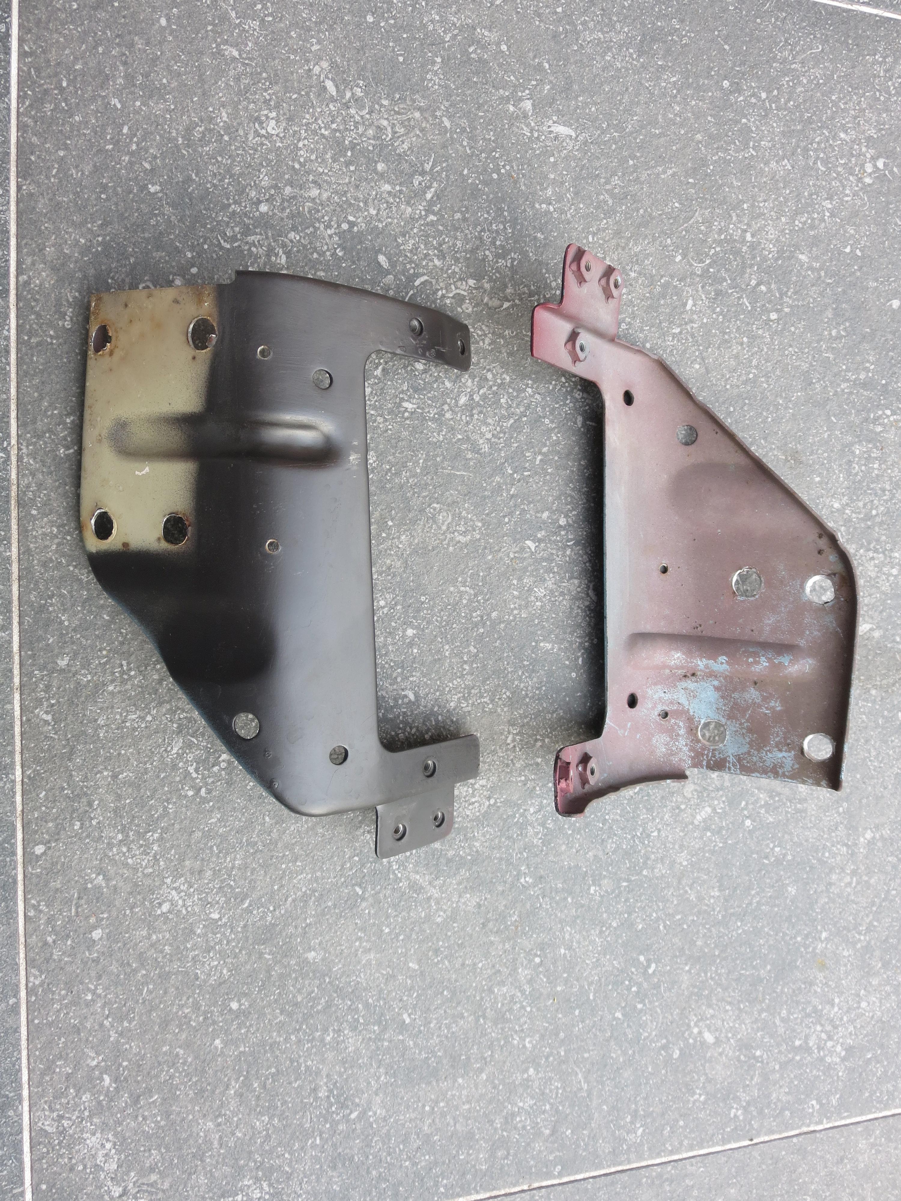

No photos of that, but I do have some photos of the front 280Z turn signal brackets.
