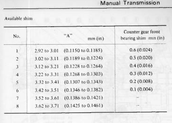

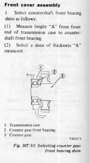

Just thought of this - don't lose the preload shim in the countershaft bore in the front cover.  It might be stuck in there, hidden, but you'll need it and the odd sizes aren't available anymore.

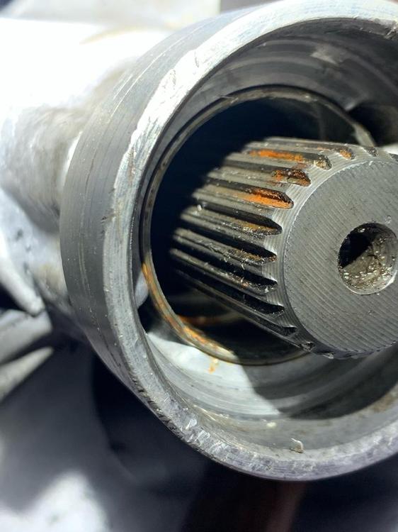

BTW, I might hold off on buying that Omega Bushing that EuroDat had in the parts list. I don’t see how it’s a problem. Am I missing something? I put the rear housing back on after calling a transmission repair shop. The guy said do a test fit see if there is play? Noting even touches this bushing as far as I can see. What have I missed? He said he can replace it but to see first is there is play and unless I’m missing another part that comes in the other side I can’t tell if this is required or not. I feel like an idiot. The transmission idea was beyond my pay grade. I just want it to go away with minimal risk. I tried hammering it how using a socket that fit right on the bushing lip. Didn’t budge and I didn’t want to mushroom to end of the bushing so I stopped.

Slip the slip yoke in to the end of the transmission and wiggle it around.  You should also check the slip yoke surface for wear, it can get grooved if somebody let the seal wear out.  I haven't seen a spec for play, I think it's kind of a gut feel thing.
It will feel looser without the seal in place.
I don't have a yoke available.  Its in the car.  I guess I'll just roll the dice and try not to screw this up and follow Dave WM.   Also, I'm going to leave that other side of the bearing in.   When the transmission blows up driving to Nashville going over the mountains (if that ZCon happens), I'll then have time to reflect on my decisions I made today.
