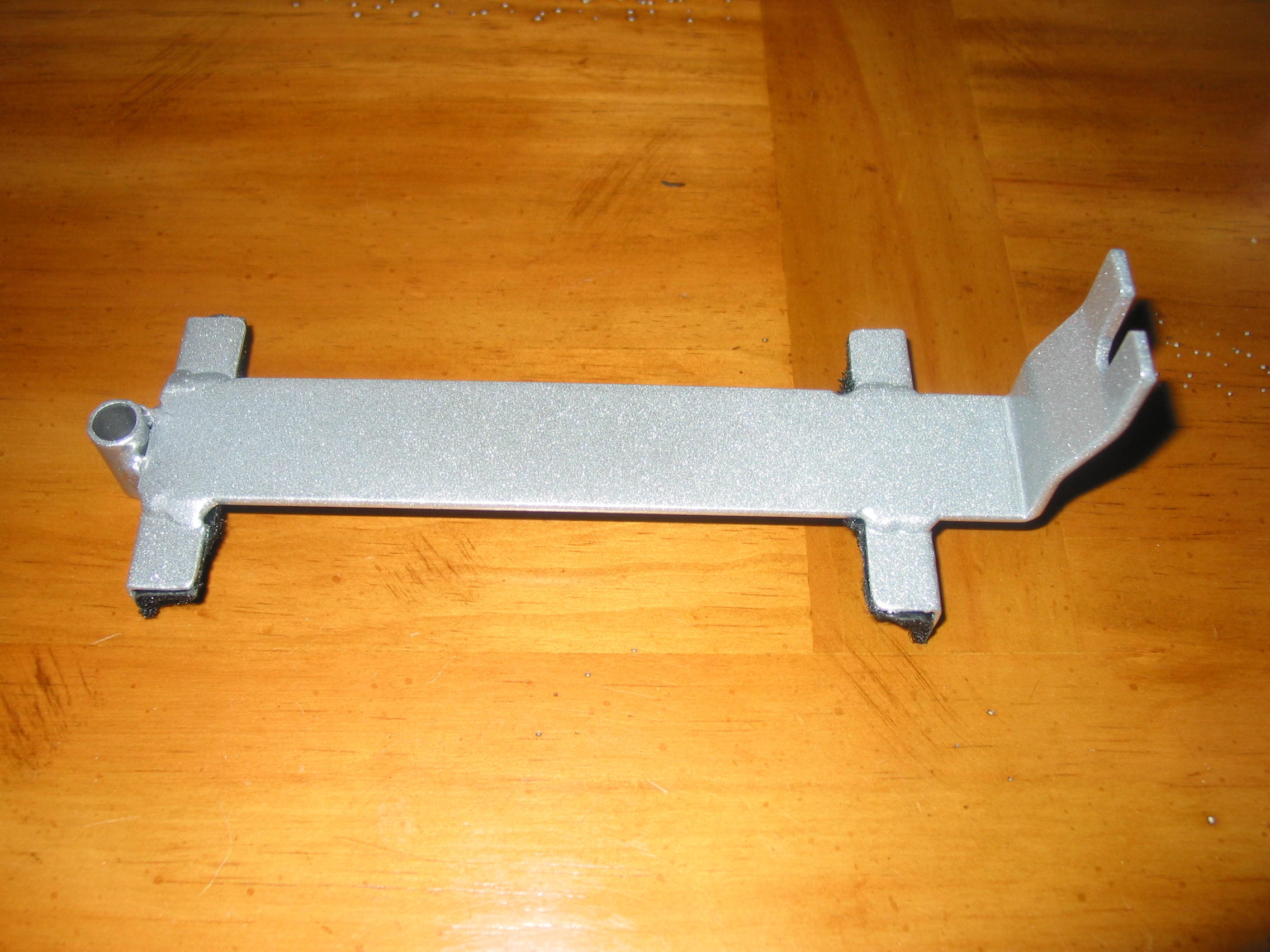

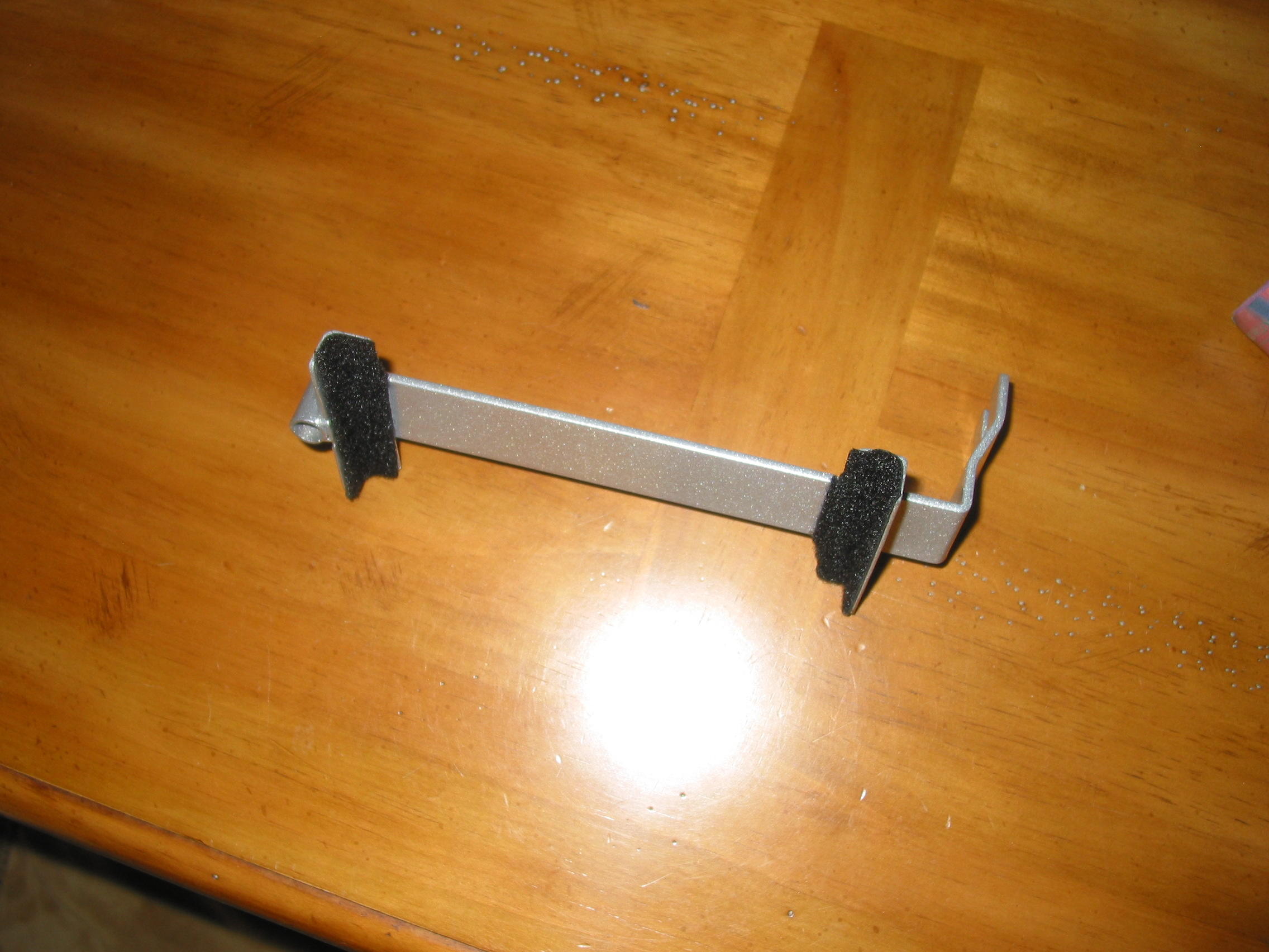

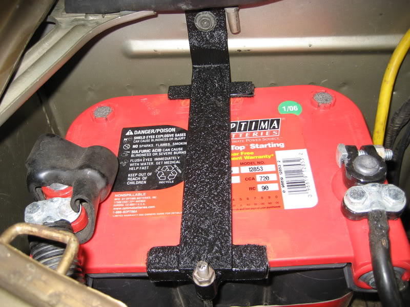

I make my own hold down brackets.  With a few bucks in metal from HD, and some work, I made this style hold down.  They work great on Optima batteries, but the design can be tweaked to fit most batteries.  I used some velcro as a pad where the bracket touches the battery.  Somewhere on this site I even put a CAD drawing many years ago.

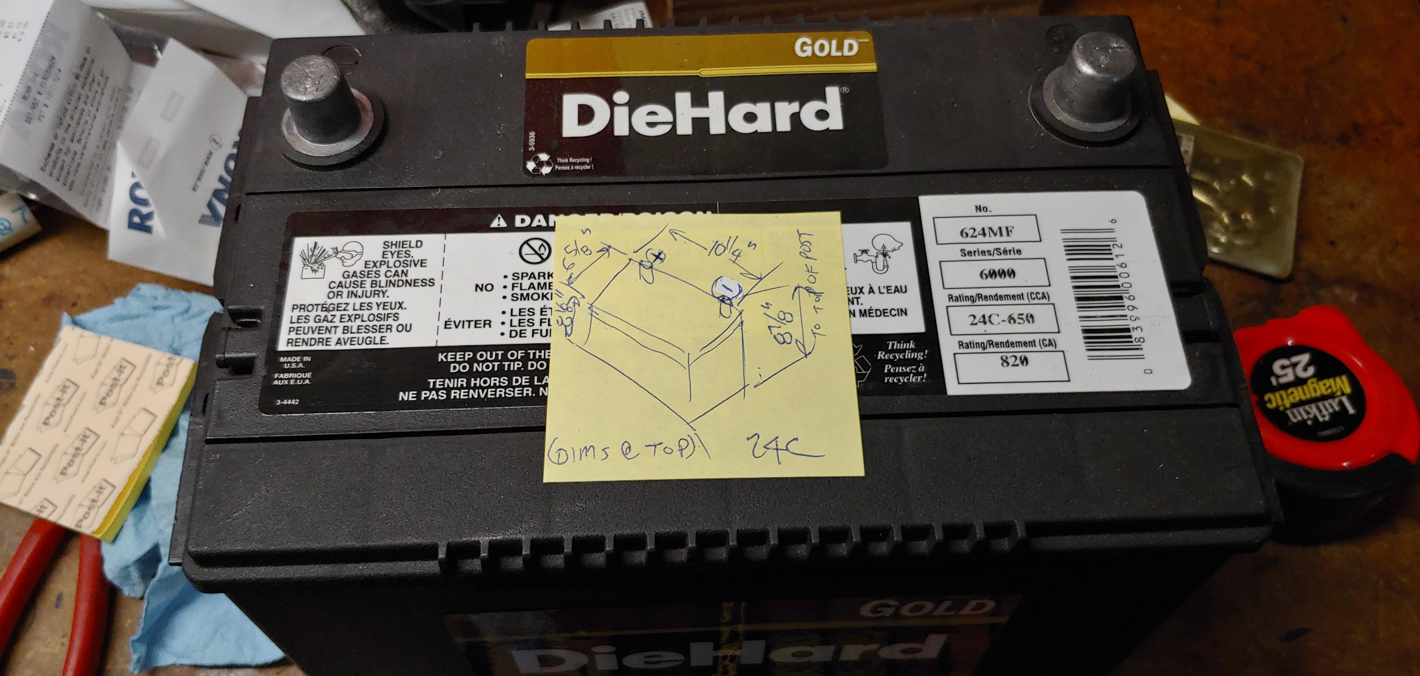

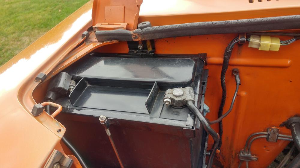

Has anyone been successful at finding a battery that fits plus has no vents out the top or out the sides?  I would think the old Datsun sheet metal would like that.
I have been using a DieHard Gold Group 24 battery (same terminal location as OEM) that has top vents but is flat on top and works with the stock cover. Like @Pilgrim mentioned to have no vents you would have to go to a gel battery.
