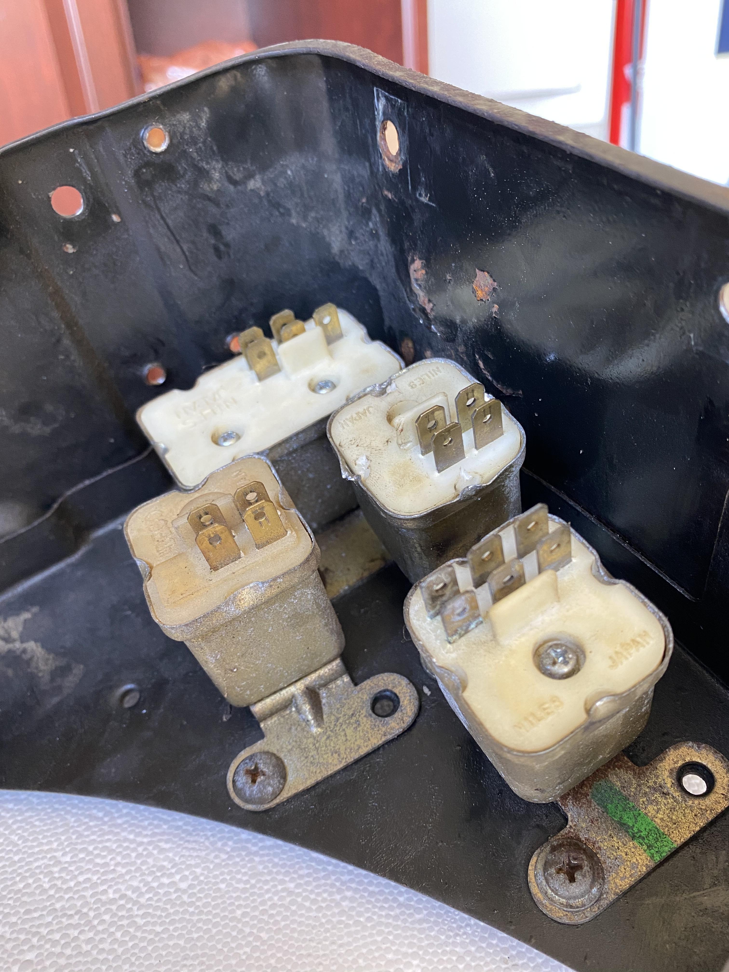

So my engine doesn’t start and while it cranks there is no volts coming to the fuel pump. I tried to look for my fuel pump relay and most people say it’s under the driver side for a 1977. However, in my case, it’s not in there but in the engine bay right next to the battery. I’ve looked at the relays and they seem okay. I can send photos if you guys request. Another thing I checked out was the afm and it seemed perfectly fine too. I test I read online was to try starting the car and open the afm flap to see if the pump would start but it didn’t so I believe it might have something to do with the relays.

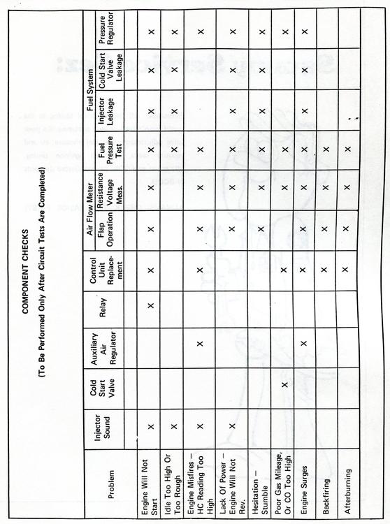

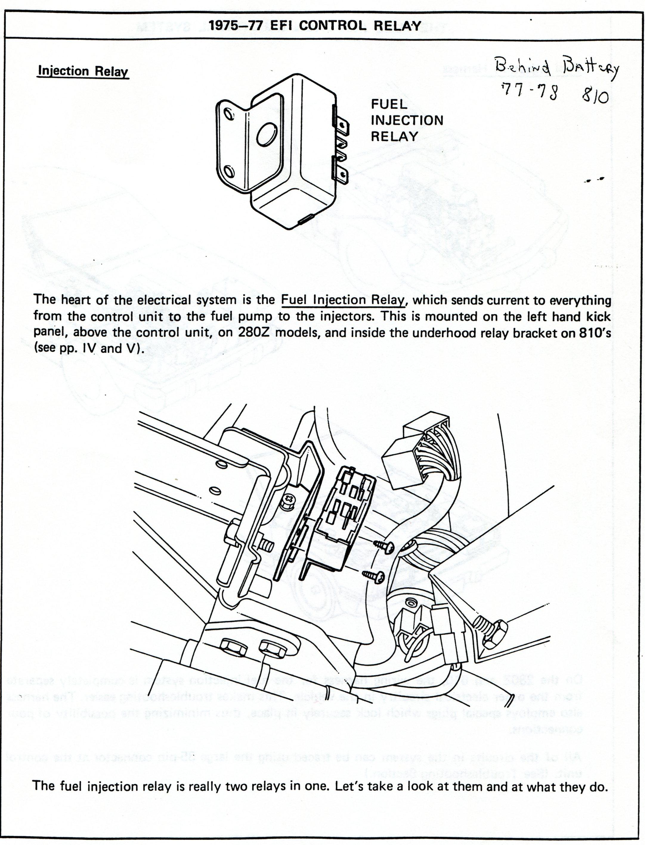

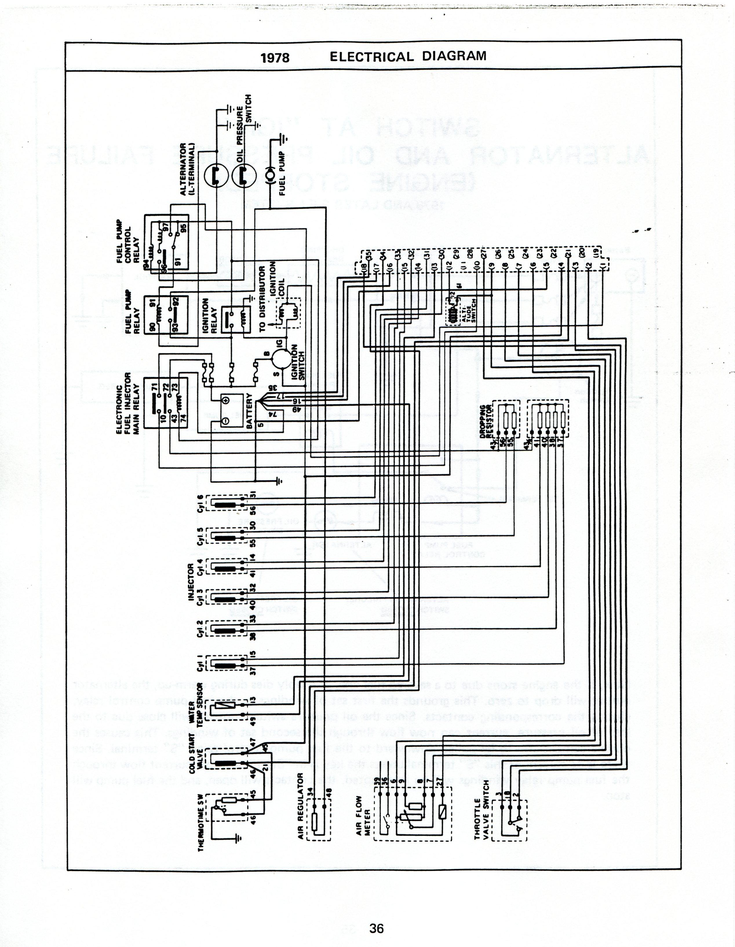

Congratulations on your first project. First I think we should back up and see what year you have. I have a 75  and 75-77 FI was much the same.
The FI manual you need is the 1980 version as there are changes. In 78 the FI relays were located under the hood according to the FI manual and they show 4 on the schematic just like in your photo . Are you sure the car is a 77? Did you look at the production date on the jam of the drivers door? If this is a very late 77 it might have the newer 78 relay upgrade. Maybe some one of the 77-78 owner could chime in?
Look at the items I've enclosed and if you have the 4 relays then the schematic could help you track down the wiring, it's for a 78. I have seen both FI manuals somewhere free to down load , but if not I have copies of both you can have. It's almost essential to get a Datsun 280z Service manual as it is really the best for an owner to have.

Yeah that relay under the drivers side dash doesn’t exist for me. I tried looking for it under there but it’s just not nor is there the two wires supposed to connect to it. I checked the old pump and connected it to a 12V battery and it worked fine and blew all the oil out of it. But when I installed it back into the car and tried starting it I got nothing. I checked all four fuses and I got electrical signals from them and from the relays and fuses in the engine bay. My theory is that the wire got cut somewhere along the passenger side so my priority is the check the connection under the passenger seat with a dmm and see what’s going on. When I get the chance I’ll let you guys know the exact year. Thanks.
Trying to chime in here on the location of the FP relay. I have a 78 280 manufacture date 1/78. By chance did you happen to check behind the passenger seat. It’s mounted to the rear of the seat support with the harness running over to a grommet above the pump assembly. Worth taking a look.
