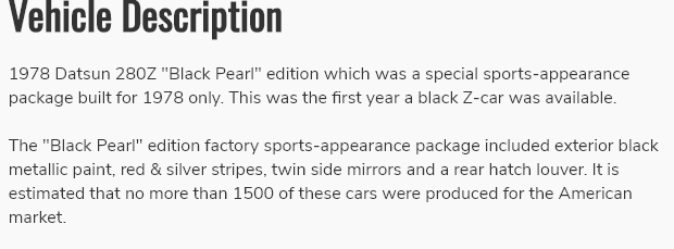

This site says that "Black Pearl" is paint, stripes, an extra mirror, and a louver.  So, look for holes or witness marks where the mirror and louver was installed.
https://classiccars.com/listings/view/910782/1978-datsun-280z-"black-pearl"-for-sale-in-beverly-massachusetts-01915

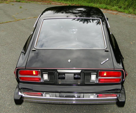

Here's a picture that seems to show the bottom brackets for the louver.
Edited by Zed Head
https://www.classiczcars.com/topic/64032-new-owner/?page=2#findComment-600280
