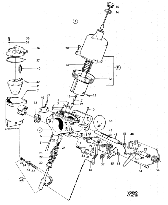

Fast forward to the post rebuild, engine starts great again and the rear carb is still running bunsen blue on the colortune. I'm using this carb as the reference, and balancing the front one to match. I'm pretty new to the carb world, so I'm not sure what variables can contribute to lots of fuel at the jet. May be I assembled the mixture screw wrong? Are the two washers supposed to be closer to the bottom of the carb, or closer to the knob?

Here's what my original, nasty never touched SUs have. A thin washer almost like a smoothe flat surface for that spring to go against up top but nothing on the bottom. Sorry I can't be more help.
@zKars do have any idea? Thank you. Cliff
Hard to see without disassembling a few, but most of the ones I see do NOT appear to have a flat washer between the spring and the big hex nut #28, unless its much smaller and thinner than I can see. Other than increasing the spring pressure or giving the spring a kind of base, I don’t see that spacer washers are needed for anything in particular. There isn’t anything in the drawing, #29 is just a spring
