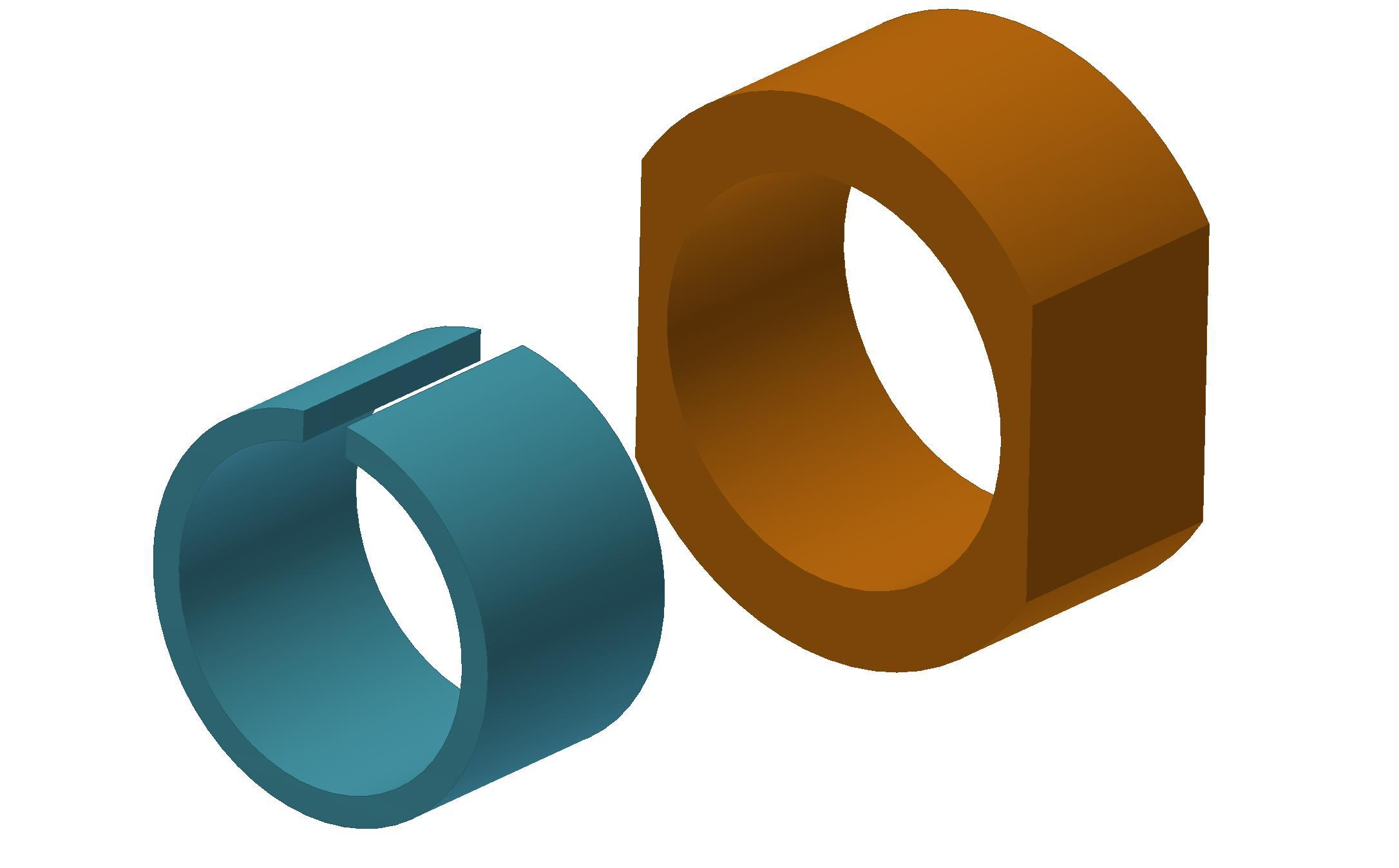

Would it be any easier to make it this way?
The inner and outer sleeves would have to be welded (plug weld through the flats), but it might obviate using a broach or a shaper.   Since I have neither, I'd have to make it something like this.
The inner sleeve could be turned to a thickness of .125 to clear the key.

Creative thinking, but having the shaper (and hopefully a broach close to what I need?) I don't think it would save me much.  I'd still have to put the slot in the inner piece and for that, I'd use the shaper. Would be a little easier since I could do it as an external operation instead of internal, but not enough to warrant two pieces and welding.
I'm not stifling the creativity though! Certainly a way to make use of the tools you have to accomplish the task in a different way.   :beer:
And I like your pic a lot. I wish I had a CAD package I could use to whip up stuff like that! I'm still drawing by hand!  LOL!
I'm running Inventor 2020.  If I'm making anything at all, I'll create the models first.  I have found my productivity is significantly greater as opposed to figuring it out as I go.  Also, my material waste due to errors and rework time dropped to near zero.  Mostly, its benefit, as I'm sure you know, is as a design checking tool.

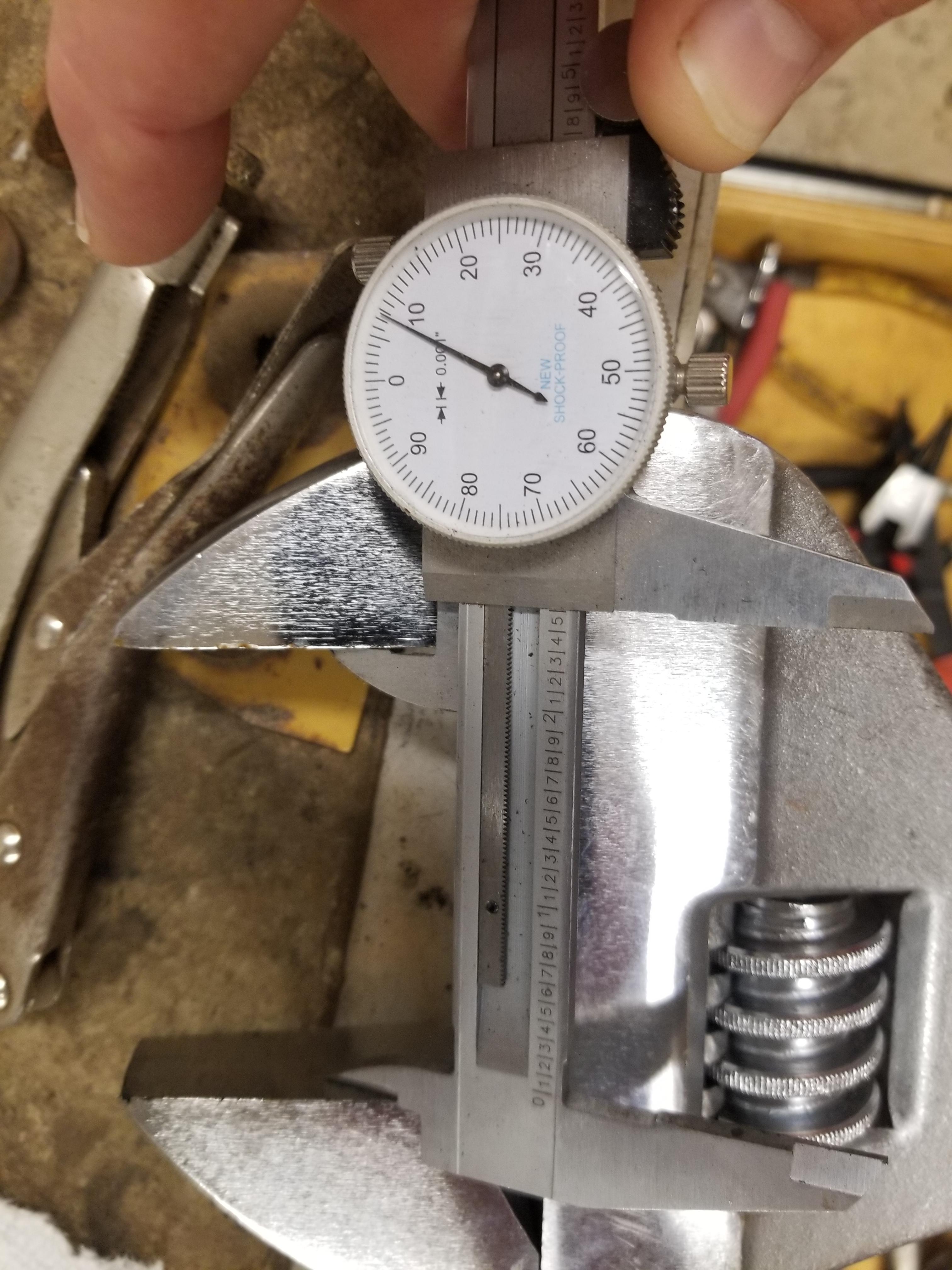

Thanks for the data. I'll make sure my opposing flats are within that range. I had already started aiming at 2", but since your wrench will go bigger, I might too. Less metal to remove.

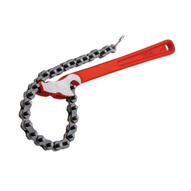

Derek, That gives me a thought...  Instead of spending time on the nut portion of the equation, how about spending it on the TOOL portion.
Build a chain wrench designed to grab the teeth on the crank sprocket. Like this, but designed using a length of two row Nissan timing chain:
ca7a16a2-0947-499d-82dd-8f03a097313b
That'll be a project for the next guy...
